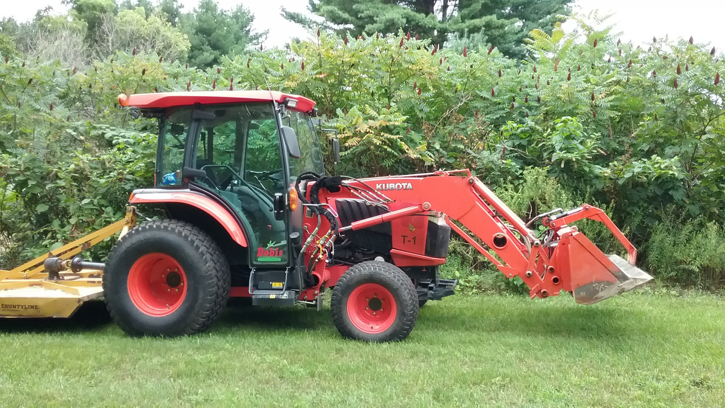

I figure some people will get a kick out of this. Here's a 72" trash tier cutter bought new for 1000 bucks. I used it behind an l3540 and l6060 for about 6 years to cut construction lots littered with rocks, concrete, and every type of building debris so Ive broken the deck, blades and even the driveshaft. Somehow the gearbox has held in there. The fun thing about this picture is that 15ft tall stand of sumac behind the tractor was what i was cutting that day. Handled it just fine. of course, I had to slowly back in to all of it but that cutter is still around after 10 years as a fine working backup. For anyone thinking that's the wrong tool for the job... I agree. my boss got an ear full over this one since I'm the guy that has to fix it when it breaks.

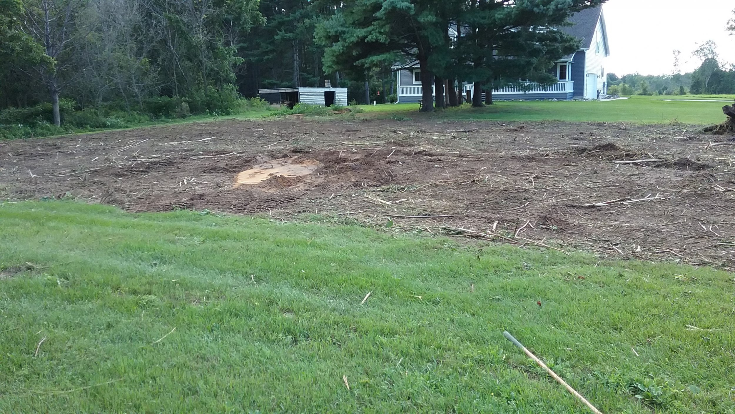

and mid-cleanup before finish grading to hydroseed.

^^^ As long as one doesn't break the tractor's PTO then all is fine: proper slip clutch (adjusted properly) or shear pin; but there's still always a possibility...
I'd had a 5' "light-duty" on my B7800 and I'd cut 9'+ grass, car (steel) rims and other car parts as well as stumps and other debris (all, of course unseen- grass WAS seen, though one couldn't see anything else when in that high grass! :LOL:)
With the "medium-duty" 6' RC on my Kioti it becomes more about whether one can put up with the noise! AND the Kioti is cabbed! Which leads me to the wondering whether folks who look to get "heavy-duty" RCs understand that one really doesn't want to be cutting large diameter woody debris for extensive periods of time: and, how is one to detect when hitting some really bad stuff, stuff that you don't want to hit?
Regarding gouging, I have a lot less of it with my Kioti and the 6' RC than on my B7800 and its 5' RC. Adjustment of tractor and or RC OR time to look at some other setup (don't gouge with my flail; but I also won't deliberately/blindly run my flail into a bunch of crap like one can with and RC).
