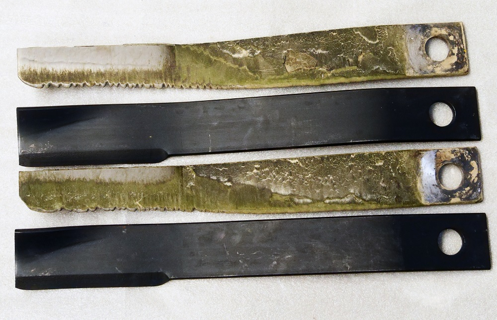

^This is what happens with mine. After several hours of mowing (and I mow desert, not grassy fields) debris gets caught between the blade and the pan to where the blade is very difficult to move. I have to spray PB Blaster or WD40 while working the blade back and forth, which causes all that debris to clear out of the pivot point, until the blade rotates freely again.
So if your blades rotate freely while at rest you have a different problem. Blades on my mower have a rough life. Changed mine last fall...here's old versus new:
