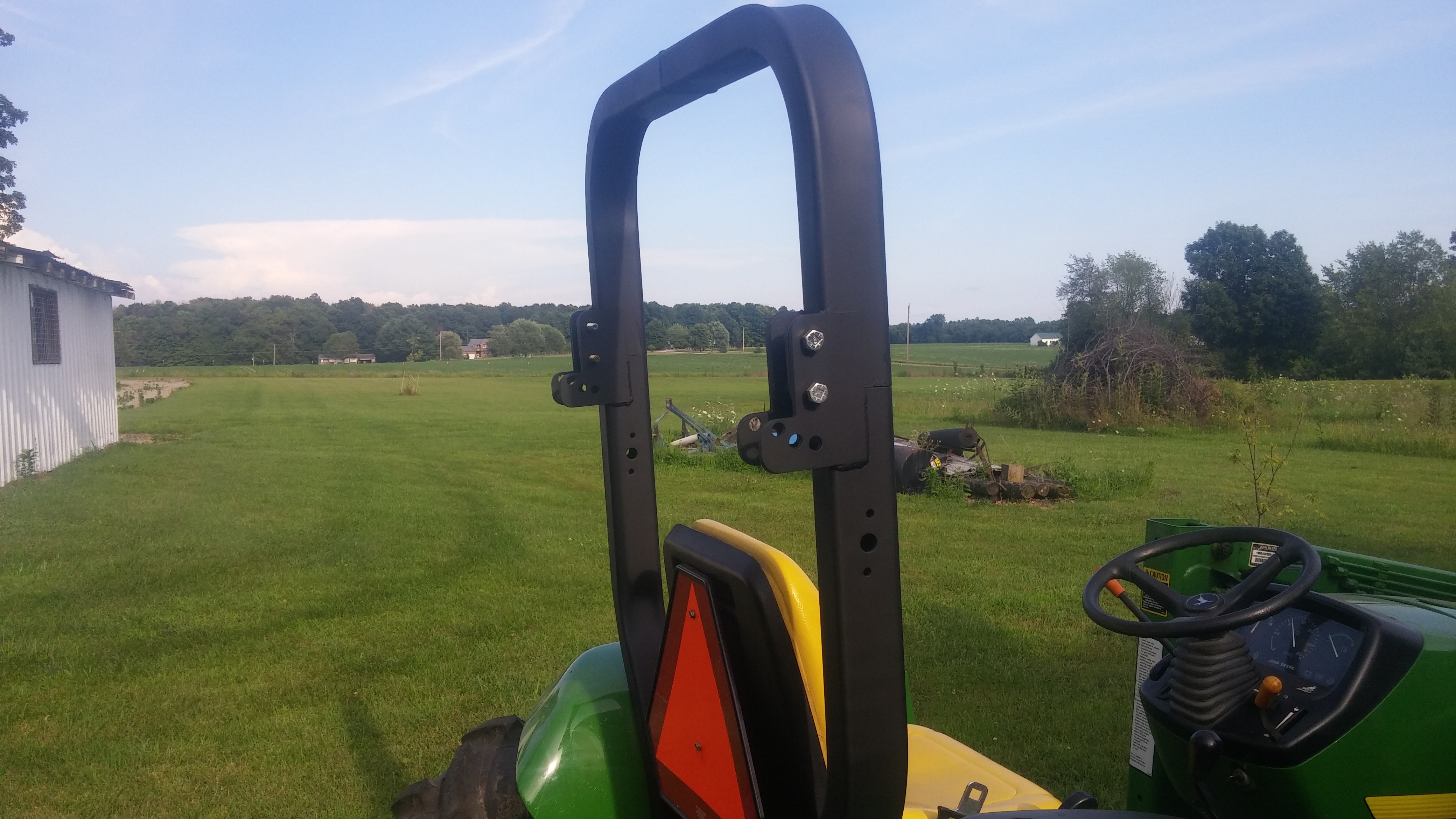

I will try and post pictures once it is done. They are going to powder coat the area they modify as well.
Powder coating a small area where the repair is made? Sounds like BS to me.

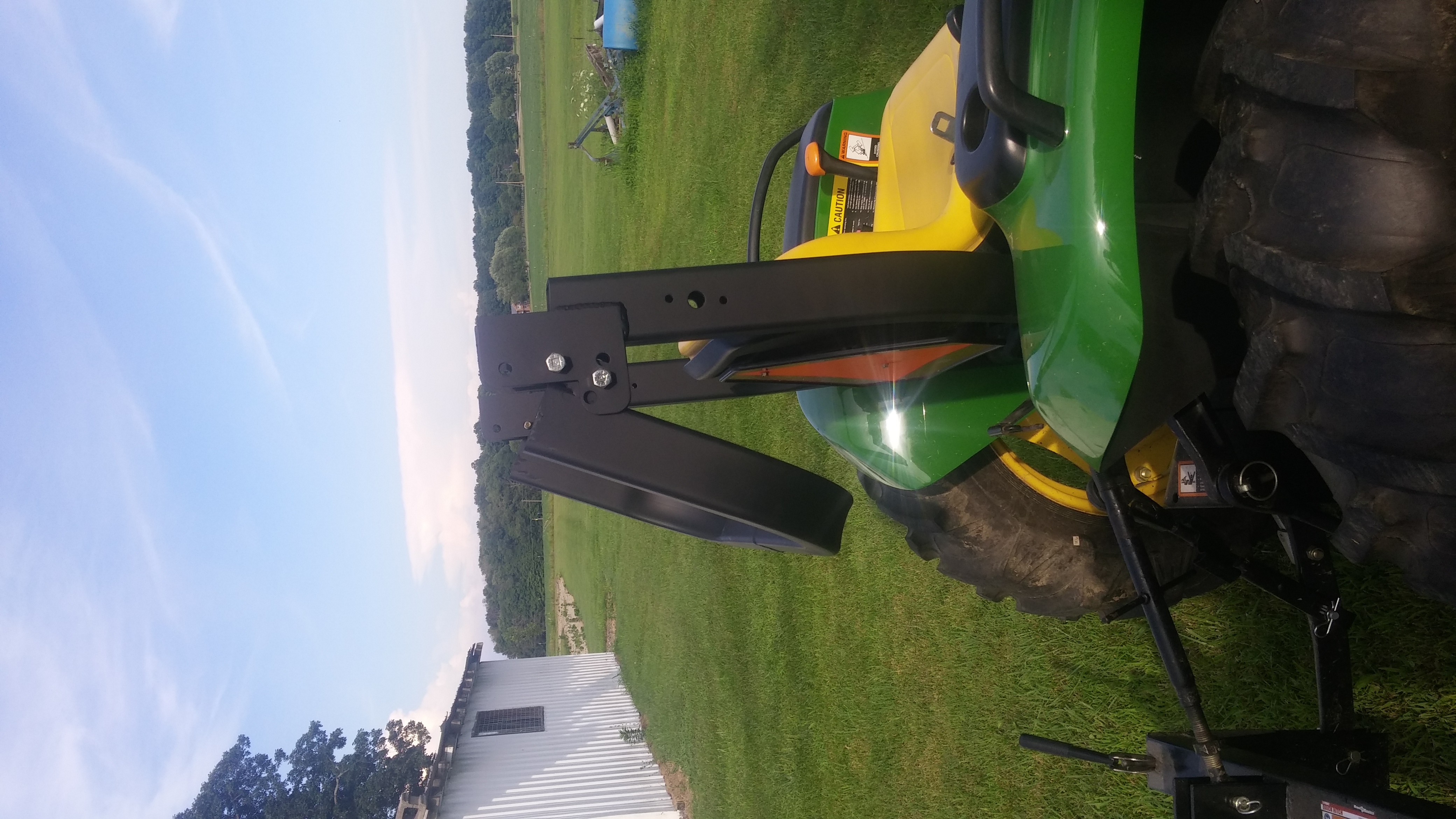

They didn't powder coat, I ended up scuffing everything down and shooting it with flat black. still have to buy some pins for it. They gave me 3 adjustments for folding.

Could you take a picture folded with the white building for a back ground? the details get lost in the tree line.

I'd just shorten it to fit underneath your doorway. Cut out a section and reweld.
I don't use my folding ROPS because the 1 and only time I did, I bashed into the top of the garage doorway and did some damage. It folds at about head level. That's where it stays. The FEDS should get smart and make them just less than doorway height on all the smaller tractors, maybe < 32 hp.

shortening would be my solution as well.. my fixed ROPS makes it in the garage door.
