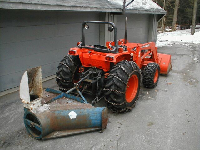

I mounted a pair of rear work lights on my folding rops by drilling seperate holes for mounting and wires. Used split lume tube for wiring between top and bottom rops.
Here's a picture.

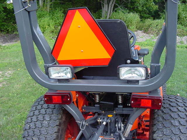

I ran my wires inside too - it's more work but only has to be done once (so far).
