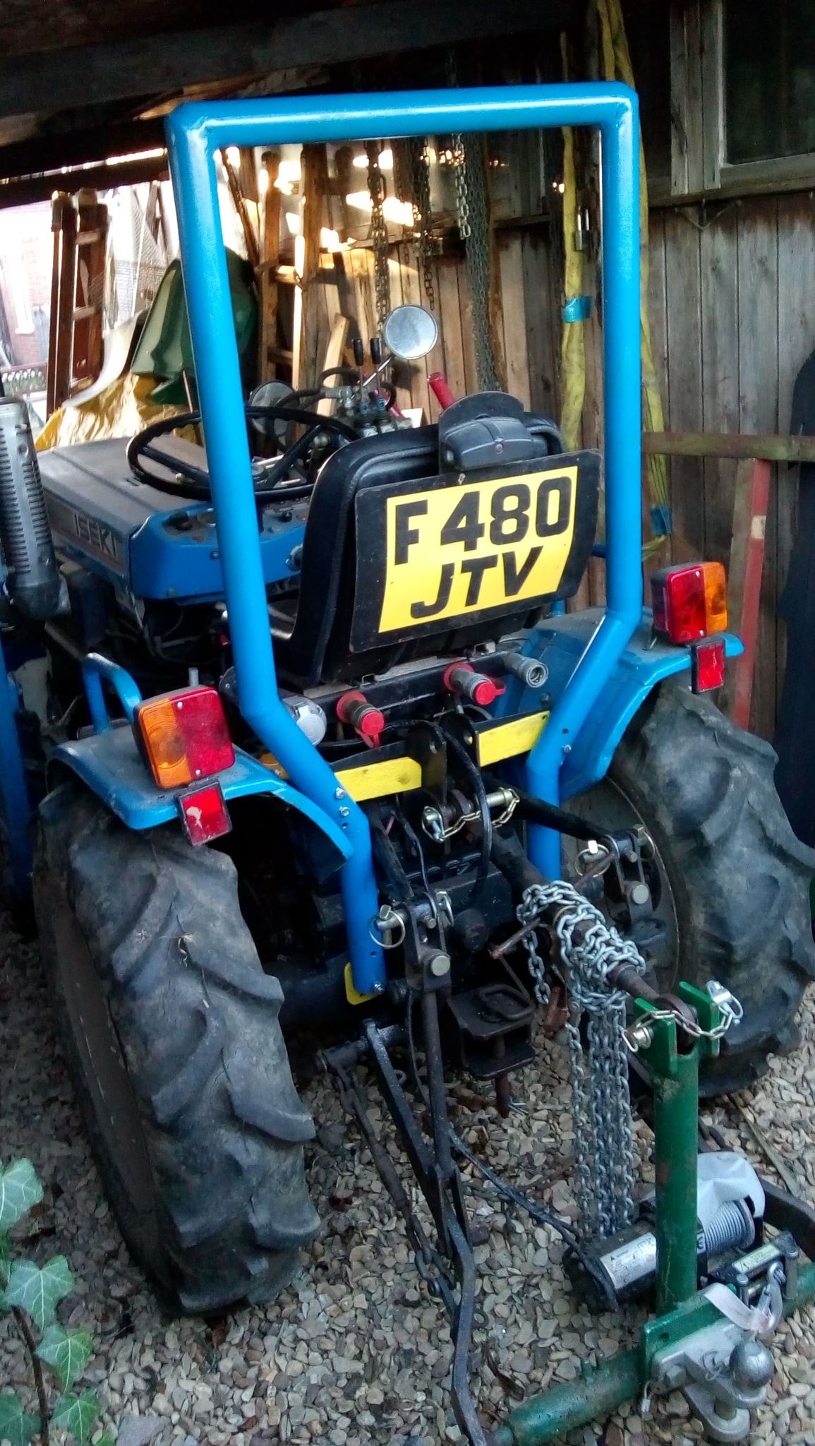

They may not be perfect or meet any standard, but they should stop the old tractor rolling over me. I made mine using a scaffold pole, cut and welded. About two days work, but hey.... Tractor roll frame.jpg

They may not be perfect or meet any standard, but they should stop the old tractor rolling over me. I made mine using a scaffold pole, cut and welded. About two days work, but hey....View attachment 678177
Nice work. I do know that scaffodling pipes are about the same gauge as those coral panels on farms. A storm came thru my old place, blew them over and 2 of them just folded and twisted. These were setup in the typical ring for livestock use. Took lots of pounding and reshaping to get them usable again.
With ROPs, there is a big reason why the top corners need those large radii. Added strength. Is it possible to add another horizontal bar above the top of the seat? This could really help the ROPs from bowing out or in during or after a roll-over.
