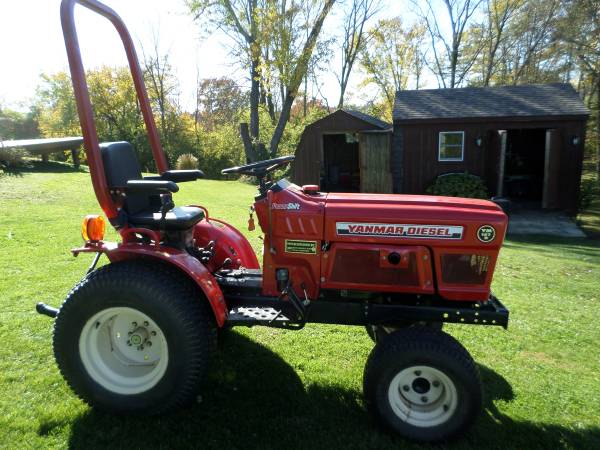

My 276D has a ROPS. Maybe it was an option.

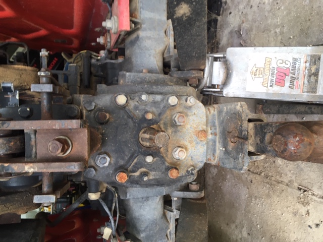

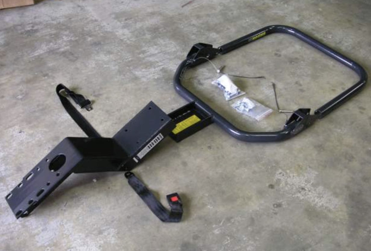

Pardon reviving an old thread. I just spoke with the folks at Hoye and the representative stated the Group 6 ROPS will NOT work with the YM276 or YM276D because that model has a "unique rear end." I found one ROPS online from justtractorparts.com that says it works with the YM276 variants, but it also says it works with "F" series Yanmar Tractors....FX16, F165, F18, FX18, FX24.
Roll Over Protection Structures / ROPS for Yanmar tractors
I am pondering on ordering one.....any thoughts?
   / ROPS for a YM 276D #10
I wouldn't take what we said as 100% will not fit. I told Jacob (the parts guy you were talking to) that 'I didn't think it would fit because I think there might be something unique with that rear axle'. I know the axle housing part numbers are not the same so there is something different there- I just don't know what exactly. Those ROPS are super expensive to ship and I don't want to take chances or make guesses. The ROPS in your link looks like it only attaches to the PTO plate so that would probably fit just fine as those appear to be the same.
