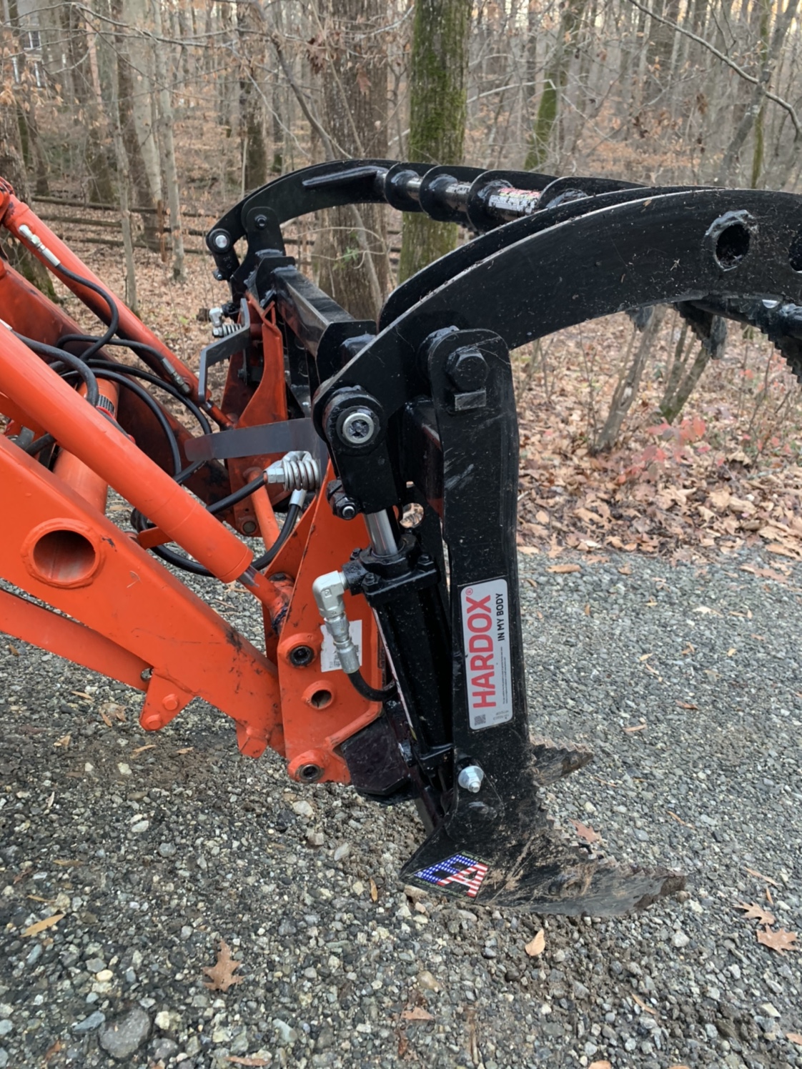

So I have a wicked root rake grapple from EA and when I’m not using it, I’m not sure the best way to store it is. Right now, I have it lying face down on the ground in a pole barn. I have set it leaning up against trees and also against a hillside in the past. The issue I have with leaning it against something is it flops over easily if I don’t lean it enough. The grapple I have does not have a stand. It’s one of the lighter ones for compact tractors from EA. I really like it. I think it weighs about 240 pounds. I’m thinking I could add a couple beefy hooks to one of the lower rafters in the pole
Barn and just hang it there. I’m also thinking it would be best to have the cylinders all the way into the ram so as to not get pitted and damaged over time. My grapple, when extended, the cylinders are back inside the ram. I’d be interested in your thoughts on this? I’ll post some pictures later today. Thanks! IMG_8459.JPGIMG_8456.JPG

Well - I got my Land Pride grapple six years ago. I've never had occasion to take it off. My grapple weighs 820#. Not something you are going to "horse around" to reconnect. Having your grapple in a "position" for easy reconnect might be important. It's such low humidity here - I've NEVER had problems with the rusting. But if you do - then extend the grapple and have the cylinders back inside.
I would set your grapple on a pallet and rope it up to the rafters. Just to keep it in an upright position. No need to "hang" it and make the rafter take the full weight.

First with out pictures, I am making an assumption that with your cylinder rods inside the cylinder the grapple is as open as possible.
Can you uncurl (dump) where the grapple rest on the points of the top and bottom portions and unhook from it in this position?
You may still wish to use the pallet concept to keep it off the ground a bit.
If you can not unhook in the above described position, then I suggest a pallet for a base for the grapple to sit on, add supports for which direction lean allows best access to hook and unhook it and let it lean that direction for the amount you determine with the supports you build onto the pallet.

Usually the cylinder rods are hard chrome plated and will withstand decades of exposure without pitting or rusting.
I would design a folding kickstand for the grapple like the ones on the Land Pride grapples. My Precision Mfg unit has fixed, welded-on parking stands.

Storing open grapple, I think gravity would pressurize one of the hoses. My grapple has a parking stand, if stored on multiple pallets or a sturdy stand/shelf it's easier to connect if SSQA connector is above tractor hood line. Requires a sturdy stand/shelf

^^^^^ EA has instructions on the website for this, open it all the way, then tilt it down and rest it wide open on the top and bottom tines. Like you said, the pistons will also be fully retracted and protected inside the cylinders.
