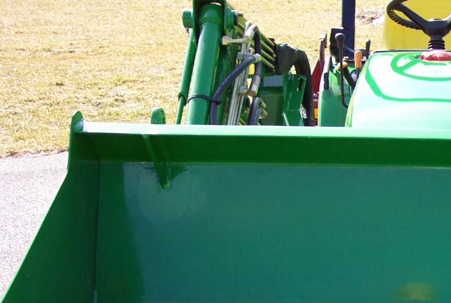

Another view for orientation. BTW, with the smaller loader I opted for 5/16" hooks and use several differing lengths and slip/grab hook combinations of 5/16" Grade 70 transport chain. Much lighter and more than adequate for the capabilities of the subcompact. 3/8" is a better size for the bigger rig.

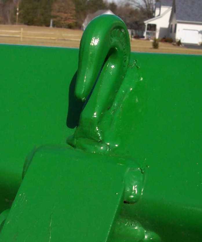

Detail of the grab hook and weld.

When I welded the hooks on my FEL, I first welded on a piece of angle iron 2"x3"x3/8". This fit perfect on the top edge of my bucket, then welded two 3/8" grab hooks on each side and a 1/2" slip hook in the middle. This combo of hooks works great, don't think I would change a thing.

Mark, just another suggestion I used on the FEL of my 4100. I bolted a piece of angle iron on the top of the bucket and put five 5/16" slots in the vertical surface of the angle - one in the center, one near each end, and one in between on both sides. With the heavier chain, make the slots 3/8". It is very easy to use and doesn't require any welding.
