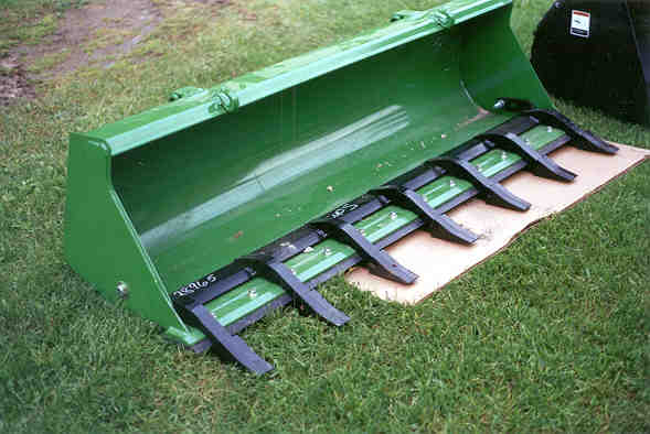

<font color="blue"> "...My question is, with my 460 FEL, what is the best way to attach hooks?.." </font>
Mark,
See pic attached of my 3/8" grab hooks that are on my 460's HD bucket. Hooks were welded just above the upper lip of the bucket where the FEL arms attach to the bucket. This is where the greatest bucket structural support exists. I've spoken to folks who place a reinforcing steel strip on the bucket's lip. You can go this route but unless you are expecting to do a lot of heavy duty lifting or pulling with these hooks, I don't think you'll need this strip. If you'll use the hooks primarily as tiedowns, then welding them as I've done will likely suffice. Also, make sure you use USA made hooks, not the Chinese ones.
Welcome to the forums. Look forward to your contributions.
...Bob

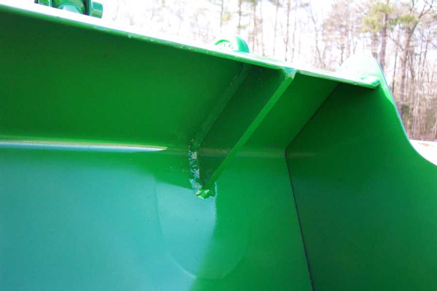

All of the above is good advice. Get the HD bucket if you haven't already.
Attached is a picture of one of the the support plates welded inside my 210 bucket when my dealer installed my hooks. Not my idea but very ingenuitive.
