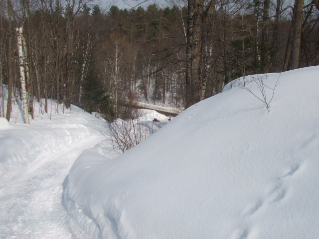

Here is my driveway just to give you the big picture. The picture does not really do it justice, I have people that are afraid to come up my driveway in the summer time. I come up in my Ford Ranger4x4 when the temperature is not making it pure ice, nothing like sliding back down after you dont make it up all the way...the key is you do not brake at all:D
here`s the picture Merry Christmas to all

Merry Christmas! Your picture says it all. You need chains. The type with the "V" bars welded to the links might be the best. It'll cost a few bucks but in the long run you will not be sorry. Just the price of living in such a beautiful location. Good luck.

That picture is about a 5 or 6 on a steepness scale of 1 to 10 on the driveways I plow on the mountain for my customers . Go with a set of chains .... my New Holland tc40da has the same problem with the R-4's , just a little ice and it's all over ,chains are night and day difference.
If your driveway is the only one you plow and you do not want to buy chains try throwing some sand or salt or pea gravel down for some traction getting back up a few shovel fulls make a big difference.
I cover a pretty good distance plowing from one to the next and hate the chains over the road for any distance and found keeping a few garbage cans at the half way point on the steep driveways and flinging a few shovel fulls of salt,sand mix is all I need to get the job done unless it is pure ice. Good luck and be safe .

great photo, I thought I had a long and steep driveway . . . . you win
