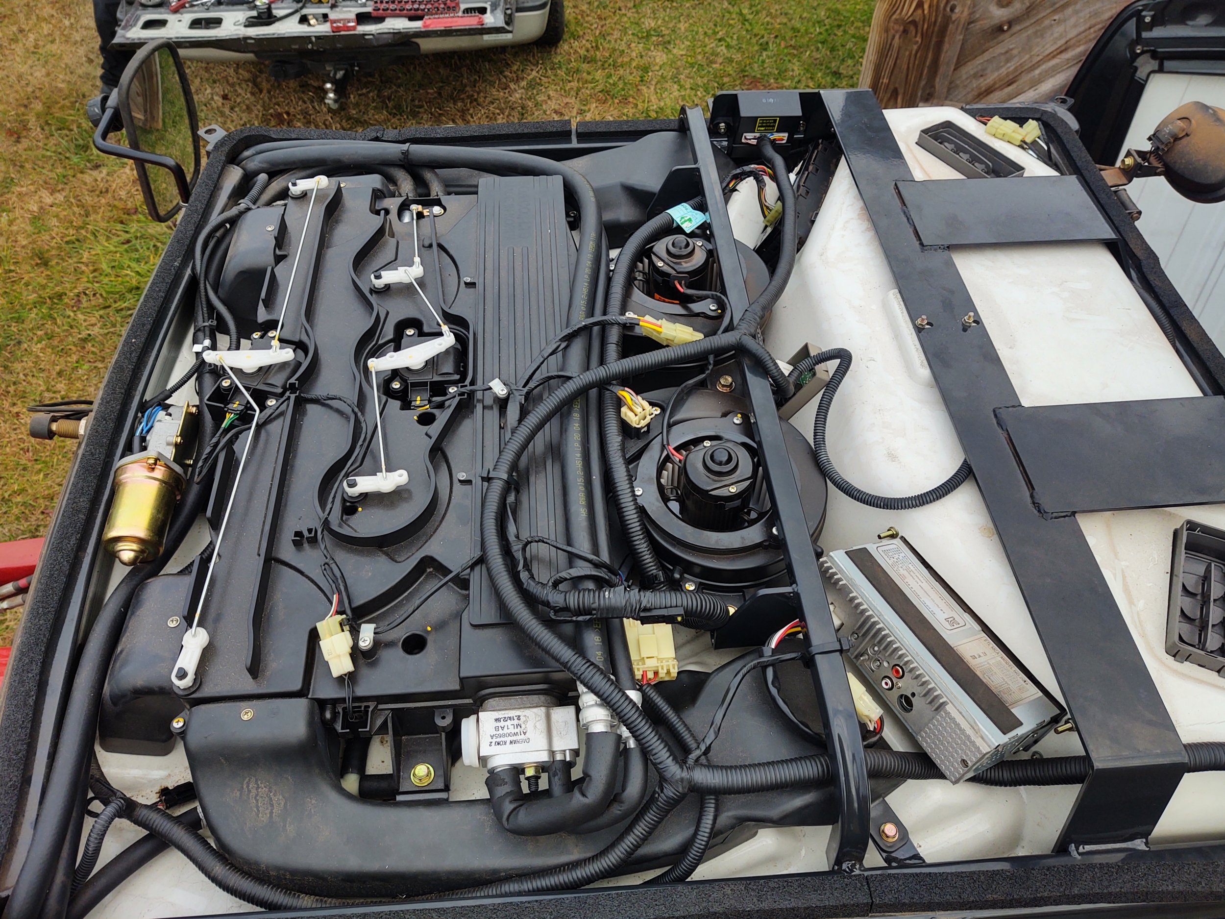

Yes, easy to get off, dealer came out to swap out the HVAC unit (bad evaporator) sensor. We just took bolts out and it comes off easy. I have a 3515CH, picture is viewed from driver side.
   / Roof removal
#9
denjen, thanks for the picture!!
