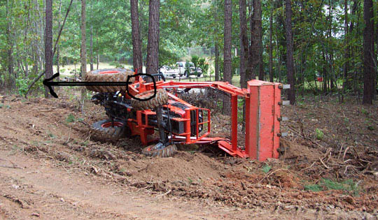

Wanted to really thank everyone for their generous and on the money advise! /forums/images/graemlins/grin.gif /forums/images/graemlins/grin.gif Sorry I haven't responded sooner, but the squish-over and the resolution has been keeping me busy /forums/images/graemlins/blush.gif I was able to get her upright Sunday morning with the help of the Cat bulldozer and a tow strap. All of your comments, suggestions, and ideas were tremendously helpful when we started to check her over. The veteran heavy equipment guys that helped me get her on her feet were pretty impressed at how thorough and knowledgeable I was!! /forums/images/graemlins/laugh.gif I told them I had had a conversation with 1800 or so of the worlds best technical advisors the night before!! /forums/images/graemlins/grin.gif /forums/images/graemlins/grin.gif /forums/images/graemlins/grin.gif
If you count my wounded pride, the B7800 came out better than I did on the whole thing. After checking the fluid levels on the battery, the front diff and the crankcase, we cleaned the small amount of fuel that had leaked out, pulled the injectors and cranked her over. With Billy (the Cat operator) watching from a safe distance, I tapped the starter enough to get the motor to turn over. No oil. Nothing but a little fuel spay. After this we put a clean white paper towel in one of the openings and cranked it again. The towel went flying but no oil! Having more luck than sense, we (Billy mostly since he's been working on diesel engines most of his life) put the thing back together, topped off the oil in the front diff that had leaked out the bleed valve and fired her up. /forums/images/graemlins/shocked.gif /forums/images/graemlins/shocked.gif Perfect!!!! Not even too much smoke! Didn't lose any oil, tranny fluid, or battery fluid, nothing! Cosmetically, she's perfect. Since the problem was caused by soft soil (and a bone-head operator) the ground she ended up on was just a soft mud pillow!!
Final word: I can still hear the bullet as it whistled past! Learned a super valuable lesson, and walked away with only my pride dented.
Here's a shot of my baby after a quick rinse and wipe down sitting by her diesel EMT!

Can you outline where exactly the tow strap was affixed, to get her upright again? I would worry that putting the strap or chain in the wrong spot might just drag the unit along the ground. Glad you came away unscathed, and thanks for the sobering photos.
/ Rollover-Layover Resolution
#9
Raphael,
I was a worried about that too. You can't see it in this picture, but the path I was on is fairly narrow and were the path ends is the property line. I wasn't sure where we were going to position the Cat to turn her without towing her. In the end Billy was able to get the dozer backed up so that he was facing the bottom of the tractor with enough room between it and the dozer blade to flip her on her wheels. Since the blade can move in and out as well as up and down, Billy was able to change the angle of force as we watched her start moving. the strap went around the mounted loader bracket on the tractor, just at the 90 degree bend. Also the ground itself helped. If you look just under the rear wheel you'll see there is a small berm that kept the wheel from sliding forward as pressure was applied to the strap. As it was, she turned up without too much trouble. The close quarters did add to the stress level, though!

I'm not being a smarta**, but is the reason for the "laydown", was it because you had the FEL too high on the side of the hill?
Must have missed the part in the thread that caused it. 25 years ago I did the same thing with a skidsteer and had to run a snatch-rope through the back garage door of my garage with my 4x4 in the garage to upright it. Had bucket up when I turned. Glad to hear that everything turned out ok!

Combination of reasons, none of them too smart. Check the "First Rollover" thread for the grusome details. The FEL wasn't overly high, but it was high enough, and combined with a few other factors to cause the layover.
/ Rollover-Layover Resolution #15
FEL too high. Yes, I agree. From the picture of the tractor on it's side - the FEL looked like it was quite high up. I generally don't put the bucket more than 6" off the ground when fully loaded and adjust the FEL height according to the terrain to kep the FEL from hitting the ground (another safety hazard).
