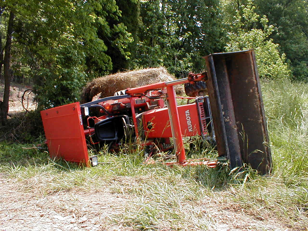

I can tell you that for me, the angle I can tolerate is less than it used to be. You need some margin for rocks, shifting loads, terrain changes, etc. My pucker meter got re-calibrated for life in under three seconds. Somewhere between 10 and 15 degrees I'll get that funny feeling and I just stop and think.
I know what everyone is saying is vague and probably not the answer you're looking for. I hope that in time everything said here will be wisdom that you posses, and that you come by that wisdom without trauma.
Pete
