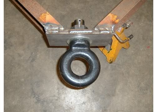

Think thats over kill? Look at this hitch ring I got, You could hang a Mack truck from it!:D It might be hard to tell by the size by the pic, but it has a 1.5" shank.
Here's the roller almost done, just one more hole to fill.
