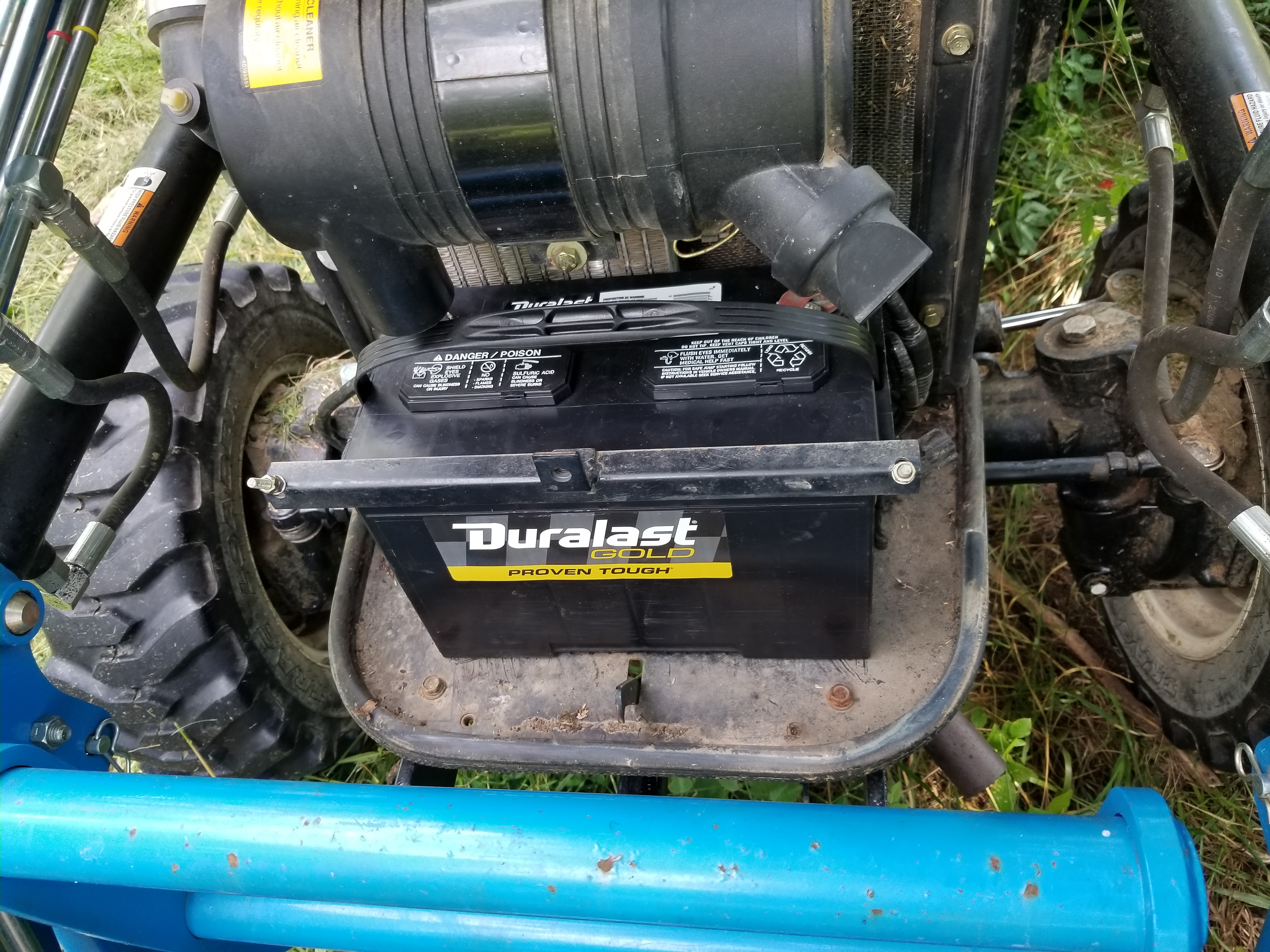

NAPA 7524 replaces the Rocket battery perfectly. No alterations needed. 7524 with no additional numbers on the end. Fits down in the battery tray that other models don't have.

Found a replacement at NAPA .....
