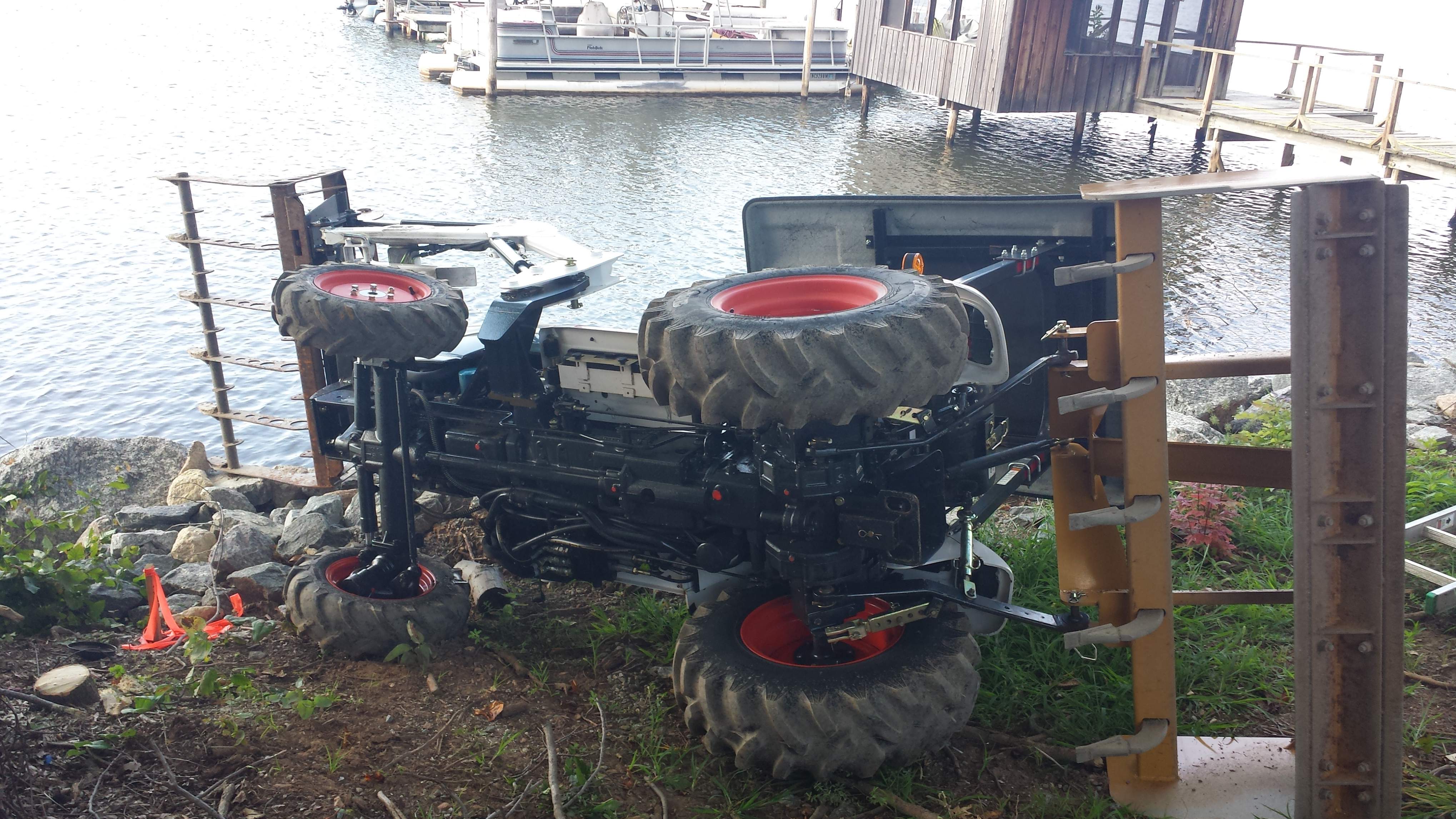

Yea, if you work your tractor like Ted, there's a chance that you'll get to see it's belly!!
Both he and the tractor were OK.
/ Rock bucket on a CT225 #11
O MAN!!!! How in the heck? To much weight up high in loader?
Ack! I think I'll stick with my more cautious style of operation. Glad Ted and the tractor were okay
/ Rock bucket on a CT225 #13
Yea, if you work your tractor like Ted, there's a chance that you'll get to see it's belly!! Both he and the tractor were OK. <img src="http://www.tractorbynet.com/forums/files/bobcat-tractors/374167-rock-bucket-ct225-20130828_161528-jpg"/>
I hope I "never" get to see that. Ha
