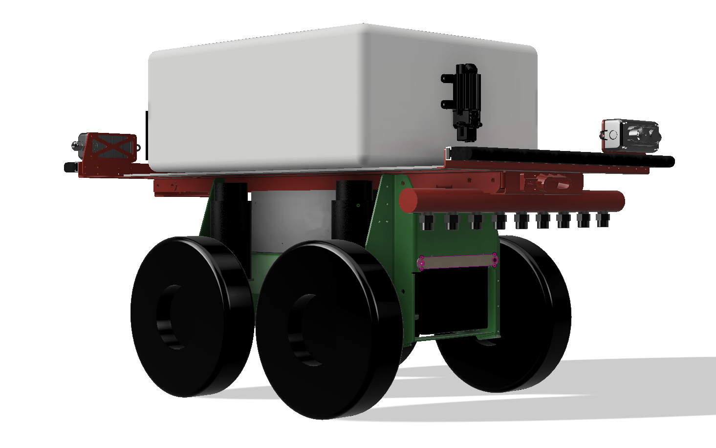

Would anyone here want something that could autonomously spray? If yes, what sorts of applications?
   / Robotic Following Cart to Replace Light Duty Tractor Tasks? #233
Targeting weeds in hay fields is the first thing that jumped into my brain. Horse people would pay a lot of money to ensure the quality and safety of their feed.
   / Robotic Following Cart to Replace Light Duty Tractor Tasks? #234
I pull a gas powered sprayer behind my garden tractor to do my fruit orchard, about 25 trees, and invariably I got a blast of spray
on me when the wind goes the wrong way. Most of my spray is dormant oil and neem oil and other things nontoxic, but standard fruit tree spray requires a mask.
Filling that gizmo up with spray and sending it on down the line might be nice, but my trees aren't uniform. I'm sure you need uniform tree/crop
placement for this to work based on sophistication of radar. It would have to turn on and off a lot.
Now...if I could put liquid fertilizer in it and send it on down my long rows of potatoes, now you've got my interest.
Easier than sidedressing with a tractor, though that's why I have a Super A.

We have autonomous row following (Burro Following Rows - YouTube) so this is doable. Suspect in big commercial operations they are doing that with a self propelled sprayer though?
   / Robotic Following Cart to Replace Light Duty Tractor Tasks? #236
Most self propelled sprayers are strictly for topdressing. A few orchard models exist, but most big commercial orchards use pull-type cyclone sprayers and cab tractors.

In potatoes would think if people side-dress they'd use a front boom sprayer with side dressing attachment?
   / Robotic Following Cart to Replace Light Duty Tractor Tasks? #238
pun intended, I'm small potatoes and don't have that kind of equipment.
Makes sense, so you can see what you are doing.
