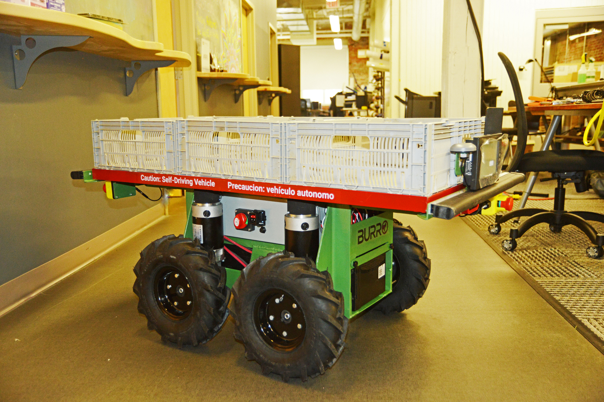

1/4 ton capacity Burro. We're charging $10K plus $500 for shipping anywhere in US48 and $500/year subscription for software updates and unlimited modem.
Looking more the part?
   / Robotic Following Cart to Replace Light Duty Tractor Tasks? #210
In all seriousness, as I mentioned before, someone is going to try and ride that thing and get their leg caught between those tires. I wish you luck. However, I'd bet there's a lot of folks thinking, "I can get a guy on a $20K tractor that'll do 10X the work or more." It's all about productivity. Hope it works out for you.
