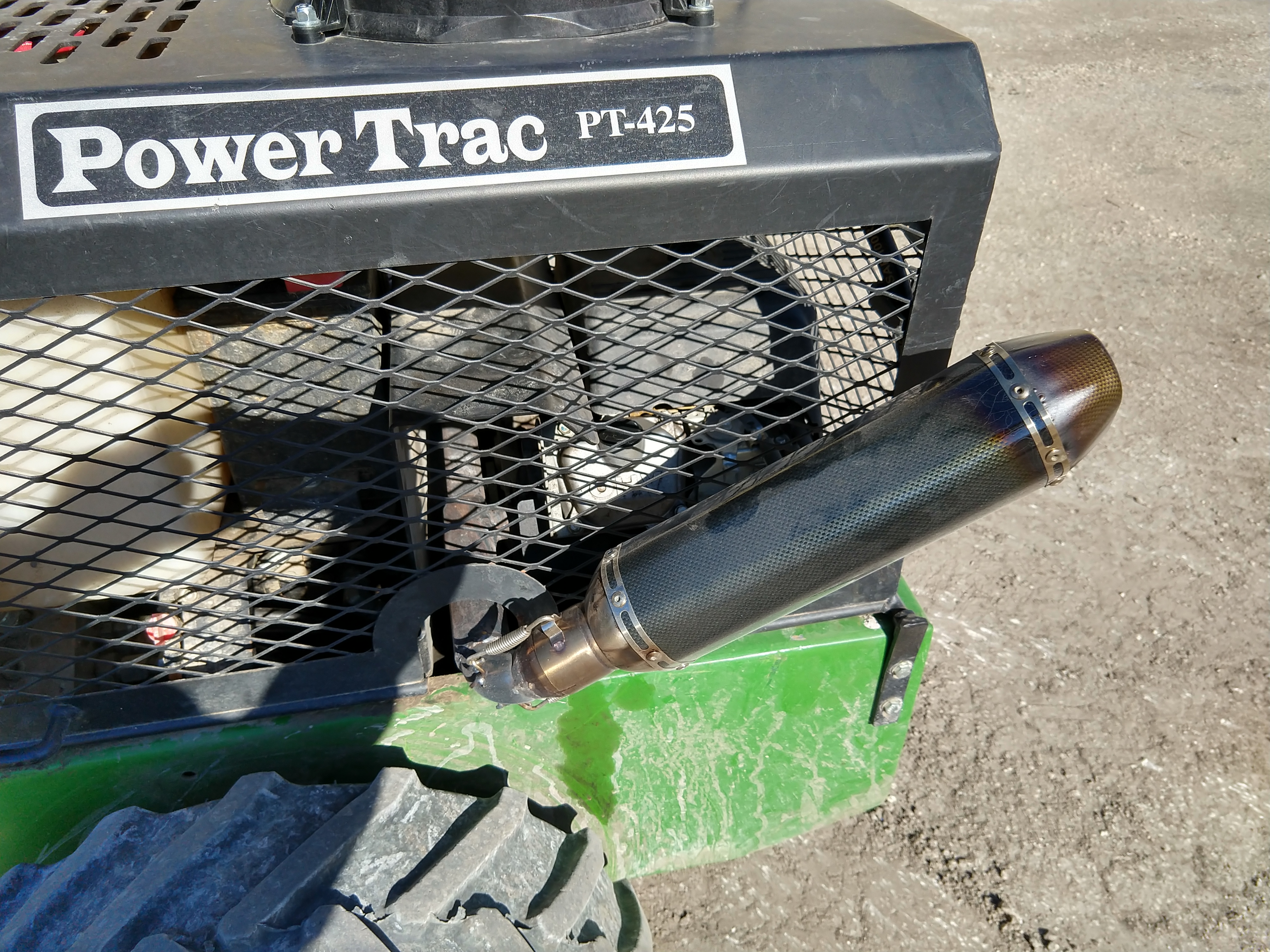

My muffler header pipe got a crack in it near 1st cylinder and completely fell off a few weeks ago so I had a friend do some fabricating and installed my son's concoction of a motorcycle muffler on it. It was working fine with no muffler but loud as ****. My son changed the oil and hydraulic filter the day before the fabrication and we drove it back on the trailer in a rainstorm and now it won't hardly run at all. Today, I took the muffler off....no difference.....took the air filter off....no different. Yesterday, it was at least somewhat running although as soon as it heated up a little, it would start cutting out a lot but today, I was lucky if I could keep it running a few minutes and then it would finally die. Next step is to spray some carb cleaner in the carberator (had some surging problems once after cleaning air filter and evidently got some dirt in the carb and the carb cleaner corrected the problem).
Anyone else have any suggestions? We obviously screwed something up. I will take some pictures of the muffler tomorrow.

Thanks MossRoad :) .... I filled it with gas and then since the hood was up decided to look at the throttle and choke mechanisms to make sure they were working fine and low and behold.... I had a broken spring on what a carpenter friend said was the governor. He said a quick fix... we will just bend the end of the broken spring. Long story short is that he cobbled it up so bad, I now will be going online and ordering new spring and a part that holds the linkage to the carburetor made of plastic that he mangled to death. Oh Well... I was cringing the whole time he was cobbling. I should have done it myself. He is a framing carpenter and is use to others hiding all their mistakes with drywall.
Anyhow, should be good to go but not before the weekend when I need it. Here are a few pics of the muffler. I angled it up some since I keep it in the garage. I am sure I will crunch it sooner or later as many times as I back into trees but it will work for now. IMG_20190429_170418629_HDR.jpgIMG_20190429_170327481_HDR.jpg
