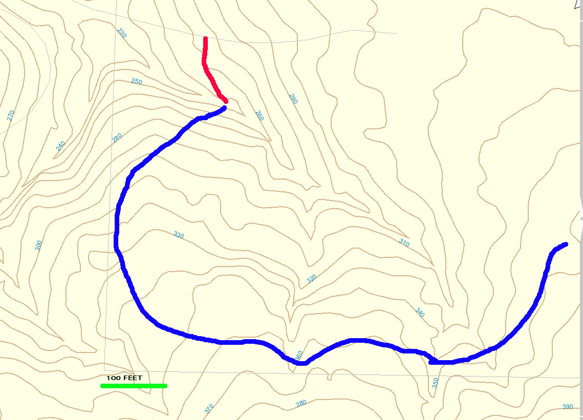

So, I know the answer is a Bulldozer. This being said, I would love to get some advice on how to build a road / trail with what I have.
The big thing is I am unsure of is how to approach the fairly steep grade. I am going to ask permission from my neighbor to put the trail partly onto his property but in case he does not...
What I have is a 60 HP Hydraulic tractor that can do severe slopes, a 72" box blade, a bucket, and a quasi backhoe....
I am wondering how other people have made a road on such an incline with what they had and how they did it. I assume I am going to start from the top and work my way down, but what method works the best. Bucket it out, or try and box blade it?
Oh in the topo picture, 1" is about 100 feet. The red is the existing road, the blue what I want to accomplish...
Look forward to any advice.

You can start at either end. The bottom is preferable if you enough tractor to dig easily. I have to work from the top down to give my Toy Tractor:D the help of gravity as it's quite small.:D
Use the bucket and establish a level area, then dig and side dump making sure you keep the working base level side to side. Finish off with the box blade. Use caution as you side dump as you do not want to go to far forward and over the lip.:D
This is basically how a dozer with angle blade would do the job on really steep side slopes. It can be interesting to see one have part of the slope fail and he goes for a hundred foot or so slide down the hill.:D :D

I like to use a slope and cut the drive with a side to side angle to shed water. As to the machine, I like tracks for consistent cuts. If you're adding stone, an excavator (backhoe) is an option, but it's slow. Focus on the water, and make sure the road bed is in subsoil.

looks like from the existing road you're climbing 50-100 feet in elevation but it's over several thousand feet of distance, then following the ridgeline pretty much from there.
you didn't mention what your final goal is. is this just a hiking and 4 wheeling trail or something more?
for a gradual but steady climb without sharp turns, it's very important to crown the road so the water flows off it into the ditch on either side and the road itself doesn't become one big ditch. when you remove alot of vegetation, you also remove resistance to water flow. your road can easily become a river in heavy rains. plan on buying some culvert pipe wide enough to go under the road bed if you have locations that require this.
if keeping it woodsy, i would recommend not disturbing the soil more than necessary. cut the trees and brush and leave the stumps and root balls intact. plant a cover crop you can bush hog and erosion won't be too bad. you can drive on it, walk on it, 4-wheel, etc. brush killer will kill the stumps and you can fill in any holes as they rot away. you can always add crushed rock at any time to rough areas and larger rock to stabilize mud zones.
if you want something nicer, you should probably bulldoze the root balls out and grade it all down to eliminate sink holes as the tree roots rot away, pack it, lay white rock with a vibrating roller and then chip and seal or asphalt. hope you have deep pockets if that is where you're headed!
no matter what you do, a good ditch and a proper crown is your friend.

Well, if it was me, I would use your boxblade to rough and that road.
Do you have top and tilt?
How strong are your lower lift arms? They will need to be very strong so as not to bend them in the manner I'm suggesting.
Getting a level surface on a slope with the fel bucket will be a little pit of a task since you can't tilt the bucket when your tractor is on the side slope. I would start where your existing road is. Have you ever seen how a bull dozer cuts a road into a hill side? They start on the hill side and tilt the blade so It's sort of level. The dozer is tilted a little, but the blade is level. Then they take a cut out of the hillside using a "scalloping" method.
So they take a cut into the hill and turn out of it, pushing the dirt from the high side to the low side. I would use the boxblade cutting in reverse by tilting the side link so your boxblade like the dozer blade. Once you get a level spot you can use the FEL bucket or keep doing the scalloping with the boxblade. I have done many roads and trails like that. Just be aware that your lower drag links need to be stout enough to handle it. I bent mine but reinforced them and now use that method all the time.

I have the ability to tilt my box blade by about 15 degrees or so. PT is not a dirt tractor like what you guys have, it is more like a skip loader than the guts tractor. But, it can move dirt so I will give it a try.
Thanks for all the advice. Will take some pix as this is one of my summer projects...

I agree with ampsucker...what are doing with this road? How you will use it makes a big difference on how you make it. You also look to have a 50 foot drop(rise) in the first 150-175 foot of road from the red area...that is steep! I know you already said you don't want this answer...but...
Rent a dozer for one day. You can rent a smaller dozer (if your trees aren't huge) for about $250 a day around here. You could get at least a Case 550/650 or Cat3. You get a six way blade and all your contouring can be done in just a few passes. The learning curve on the new machines is very steep...one handle does all your blade work. They are MUCH more stable on slope than anything resembling a tractor. Contour the area, run with a blade tip next to each side to make a ditch, spread gravel if needed, then get home safely and have a well deserved cool one. We want to hear from you again...and those slopes are steep!
Sorry for giving the answer you didn't want...I just think it is the safest and much less risk/wear-n-tear on you and your machine. I would be happy to help...but driving me and my little dozer from ohio to you would cost a bundle! Let us know more details...and take some pics...
