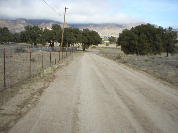

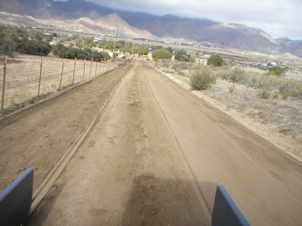

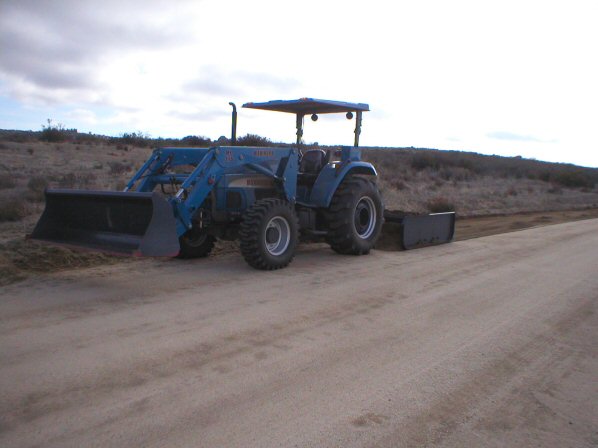

Well, while some of you are plowing snow, I graded our road that we share with 3 neighbors. I use the Road Boss Grader when the ground is a little damp so that the redistributed dirt packs better.;)

Curious, MVR, because it doesn't look like you're trying to elevate the road surface or build much of an appreciable crown.
Is water washing-out dirt/gravel roads not a big worry where you are at due to limited rainfall?

The road has a very small crown and yes with only 14" of annual rain fall on a decomposed granite surface, wash outs are non existent. The main concern with our road is wash boarding.

The Road Boss is a great piece of equipment. It is a little pricey but well worth the $.

That sure is a nice job. It looks as though the material is packed nicely from the way your tractor is leaving minimal tire marks on the surface. At what speed do you and others drive a vehicle on this road?

We drive 10-20 mph, depends on how much dust kicks up. The sheriff, (my next door neighbor) 15-40mph would be my guess.:( The next two neighbors will do as I do, 10-20mph would be my guess. When I am done grading the road, you could drive as fast as you want until the wash boarding started to show up again.

I think that the Road Boss is a tad to much $$$ also. I got lucky and was able to get mine from a local dealer that had bought a bunch of them over 10 years ago and gave me a great deal on mine. He just wanted to get rid of it.:cool:
