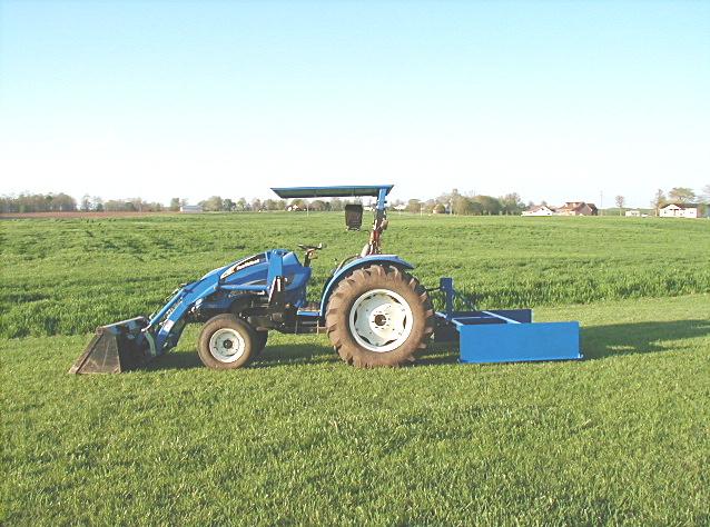

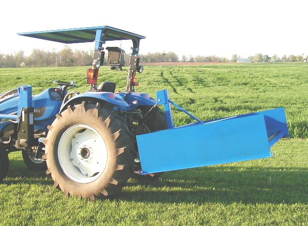

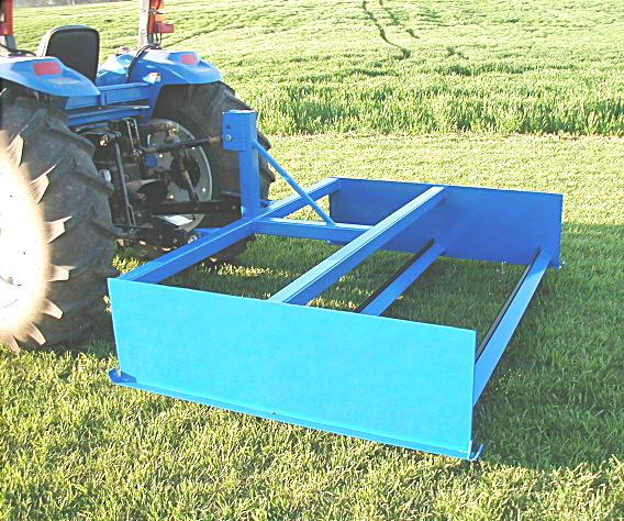

Looks even better with paint:) How far below the side skids does your front blade extend?
/ Road Grader
#22
I think its 3/4". Have you started putting yours together?
/ Road Grader #23
Havn't started assembling mine yet. Need to do pinion bearings on my truck rear diff this weekend. I will probably start next week sometime as I want to get my drive in better shape and take the humps out of our circular turn around area so I can add some gravel to it.
After looking over some pics of a "bad boy" grader up in the box blade photo comparison thread,
http://www.tractorbynet.com/forums/showflat.php/Cat/0/Board/implement/Number/667861/page/9/view/collapsed/sb/5/fpart/11/vc/1/o/all
I was thinking about 1/2" below the skids would be about right. I may have to think about that a little bit more after seeing your results. The pics of the one in the thread I linked to appear to show both the front and rear blades going below the skids. I think I like the way you did it with just the front blade cutting as it looks like you could more easilly control the ammount of cut with the toplink as you described. With the rear blade also going below the skids, you would have to lift the front quite a bit to stop the rear blade from cutting.

Nice job. What thickness plate did you use for the sides? I want to build one of these myself, been shopping them and they are pricey.
Monte
Monte
I cant remember, there 5/16 or 3/8 inch thick side skids. I think there 3/8". It's been a year since I've built it. :)
/ Road Grader #27
Thanks. I need to draw one up and calculate the weight from the steel needed. My tractor is smaller than yours.
Monte

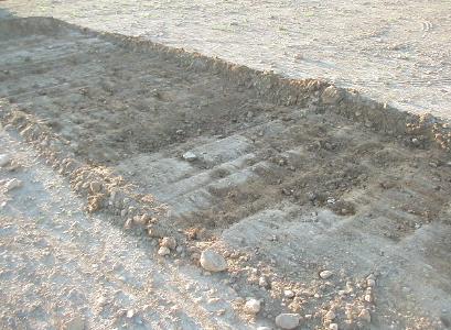

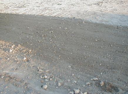

I dont see a problem using one. But, I will say this which is my opinion, I wouldn't use a road grader without using a hardened cutting edge. For example, last fall, I graded a ladies driveway that had a six inch hump down the middle of her driveway. This hump was almost two feet wide. My road grader cut it like it was butter. Since this hump was gravel and dirt mixed. I had to grade for about 20 foot, dump the load that my grader was collecting and then back up and smooth that 20 foot. It took me a couple of hours just to separate the rock from the dirt. Always remember, the heavier or more dense material will set on top (which is gravel). I quoted this lady to grade her driveway for $250 dollars. When I got done, I went to the door to get my payment. The lady wanted to see how good of a job that I did for her. Upon her seeing the quality of work that I did, she was blown away with my work that she couldn't understand why I only charged her $250 dollars. She said landscapers had charged her $750 to $950 to do her 2200 foot driveway. I told her I wanted her business and I dont do this for a living. Needless to say, when she went back inside to get my check, she came back out and paid me with a check for not the amount that we had discussed upon earlier. But she paid me $400 dollars ($150 dollars more than are deal was supposed to be) and said she'll call me next year (that was the fall of 2006, here it is, spring of 2007). If I hadn't had a hardened cutting edges, I dont thing I could have done such a good job on her driveway. I am so glad I choose to purchase hardened cutting edges. By the way, hardened cutting edges will bust up or break up a pot hole in a driveway. Mild steel will just ride over the pot hole. The cutting edge needs to have a machined and angled edge. That is what will cut through the pot hole. Mild steel does not have the machined angle edge and is not hardened, so it will get beat up pretty good while hitting gravel or rocks. This is not the ladies driveway that I was talking about, but you will get the idea of how they perform.
Before Picture
After Picture
End Of Driveway
