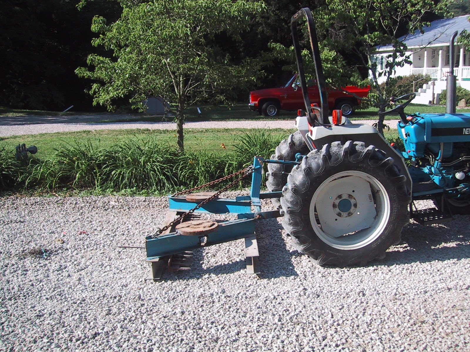

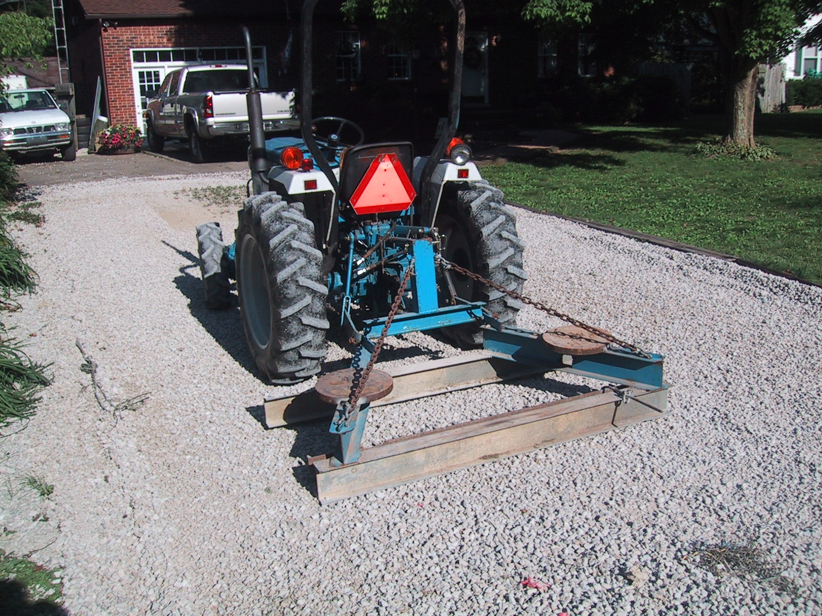

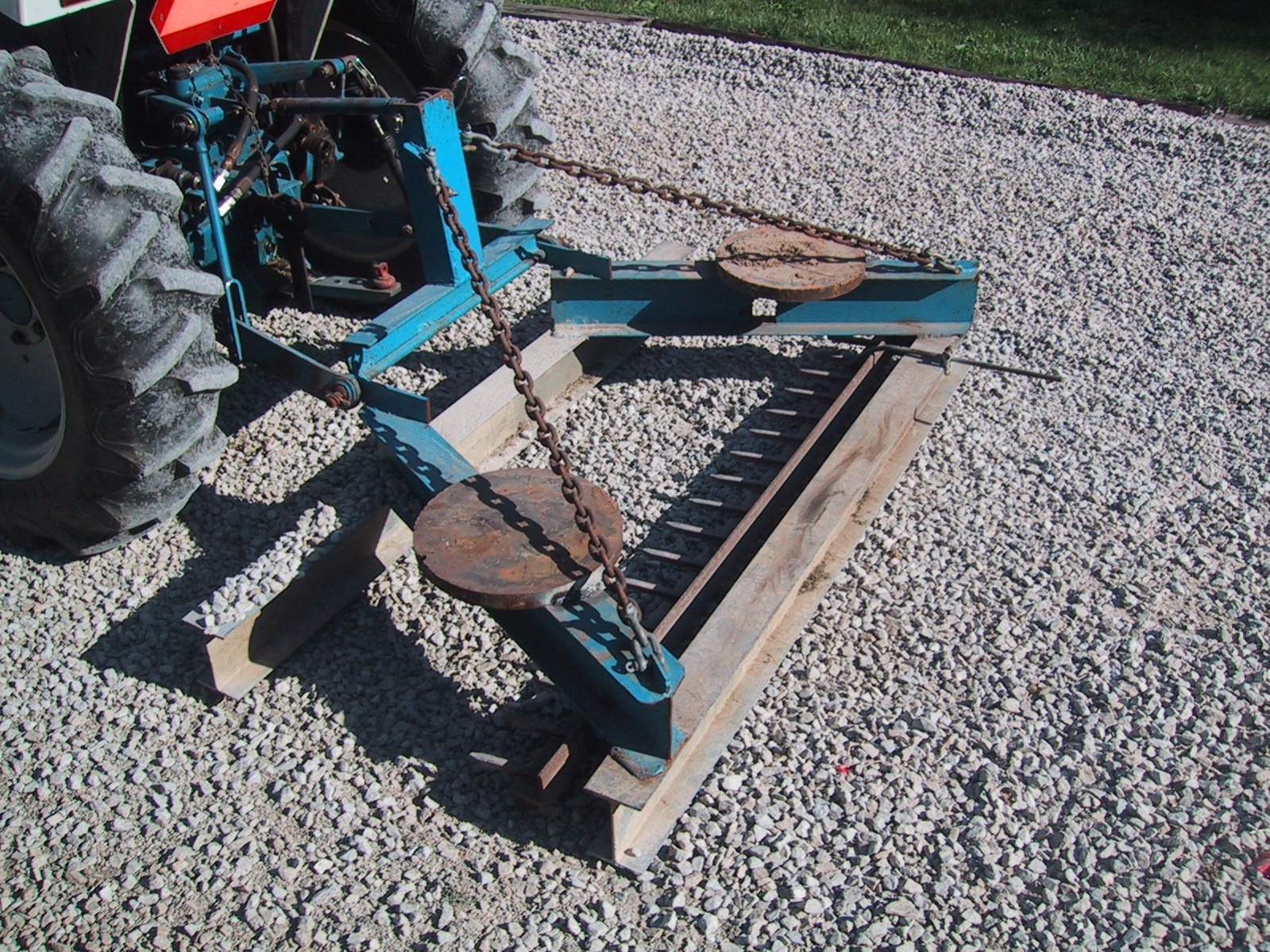

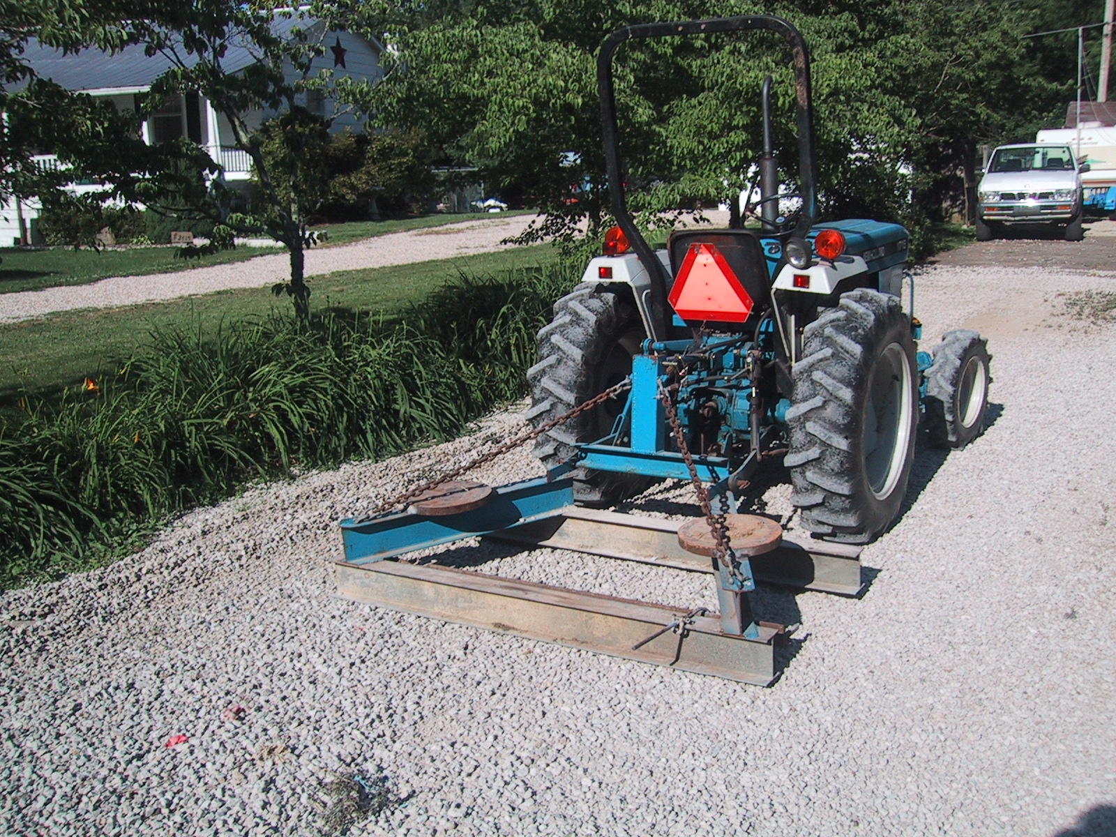

Build your own out of three guard rail post . and a few scraps . This is my home built 6' grader. You are welcome to copy. If you want I can send measurements.
