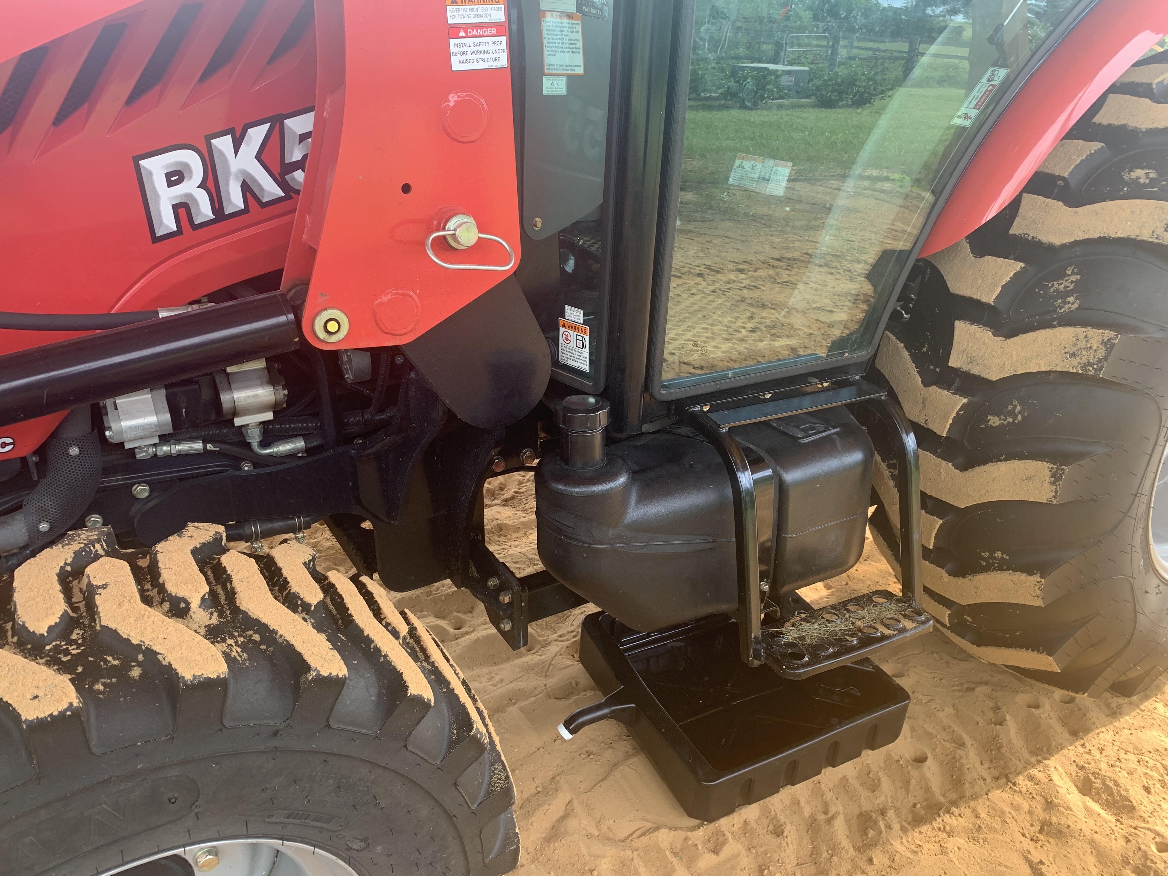

Diesel. Here’s location of the tank relative to the engine. Seems like fuel is returning to the tank way too hot. No egine over temp warnings or anything like that though, and tractor runs good. I’ll have to use my temp gun on it next time to get an actual number.

Your tractor has a Common Rail engine, which pressurizes the fuel to extremely high pressures, up to 40,000 PSI in some engines.
Pressurizing any type of fluid to high pressures will cause the fluid to heat, a lot. That's why they typically run a fuel cooler in common rail engines.
Checking the parts catalog for your tractor, I couldn't find one, so that would explain why the diesel tank gets so hot. Even with a cooler, the fuel temp typically sits in the tank at around 130F, give or take. So without a cooler, I can only imagine it getting much hotter.

Thank you for the explanation. You’re correct my tractor only has an oil cooler. Kinda seems like a design flaw to have 15 gallons of very hot fuel sloshing around in a thin walled plastic tank that’s getting vibrated, bounced, etc. No wonder mine has a crack.

It’ll be another two weeks before I mow again but I’ll let you know. I will say I could only hold my hand on the portion of tank below the liquid line for a second or two before the pain was too great, so my guess is it had to have been in the 130-150 range.
