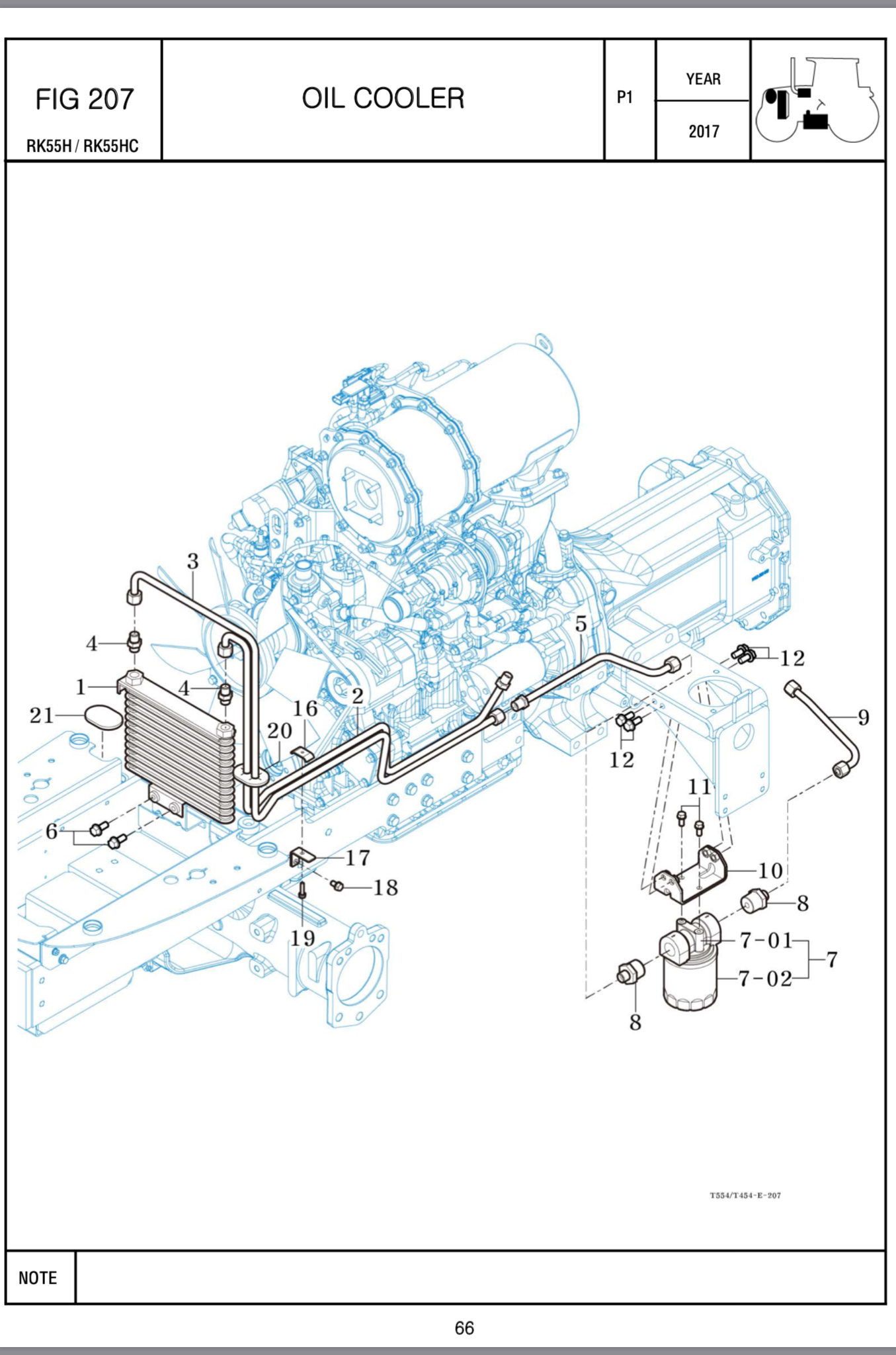

I would change engine oil every 50 hours.
Several observations after skimming through the manual.
1. Yanmar engine warranty says, original purchaser only.
2. Looks like a Donaldson air filter housing but its not using a two filter method. Bobcat uses an inner dust filter. I was able to install one in my other mule. Might be a good option to investigate.
3. Im not seeing a hydraulic oil filter, only HST. Did I miss it? Anyone know if the RK55H has one?
4. I saw a video of a TYM55 pulling logs that the owner hit a stump under snow and it broke a vertical oil filter and leaked oil. This was my reasoning for searching out filter locations. Im not seeing this filter in the manual?
Looks like the owners manual is wrong for location. In the Parts manual the Hst filter is on the left and vertical mounted. Bad location IMHO.
Owners manual http://rktractors.com/manuals/Operator Manuals/RK55 Hydrostatic Open Station & Cab Tractor.pdf
Parts manual
http://rktractors.com/pdf/parts/RK55H RK55HC.pdf

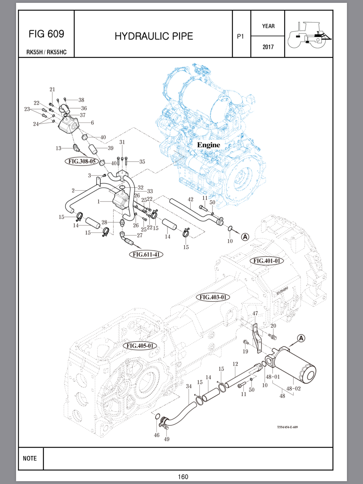

I don't see the inconsistency in the manuals? The hydraulic filter (suction filter on page 160 in the parts manual) is horizontal on the starboard side of the tractor. There is also a smaller vertical HST filter on the port side (page 66 in parts manual).

Sorry, I missed it in the Parts manual.
Does the owners manual show both? I didnt see it in the maintenance section. But my wife says Im blind And thats my excuse and Im sticking to it! Lol
Edit, I checked the owners manual and I do see hydraulic oil filter but cannot find hst filter in the maintenance section.
