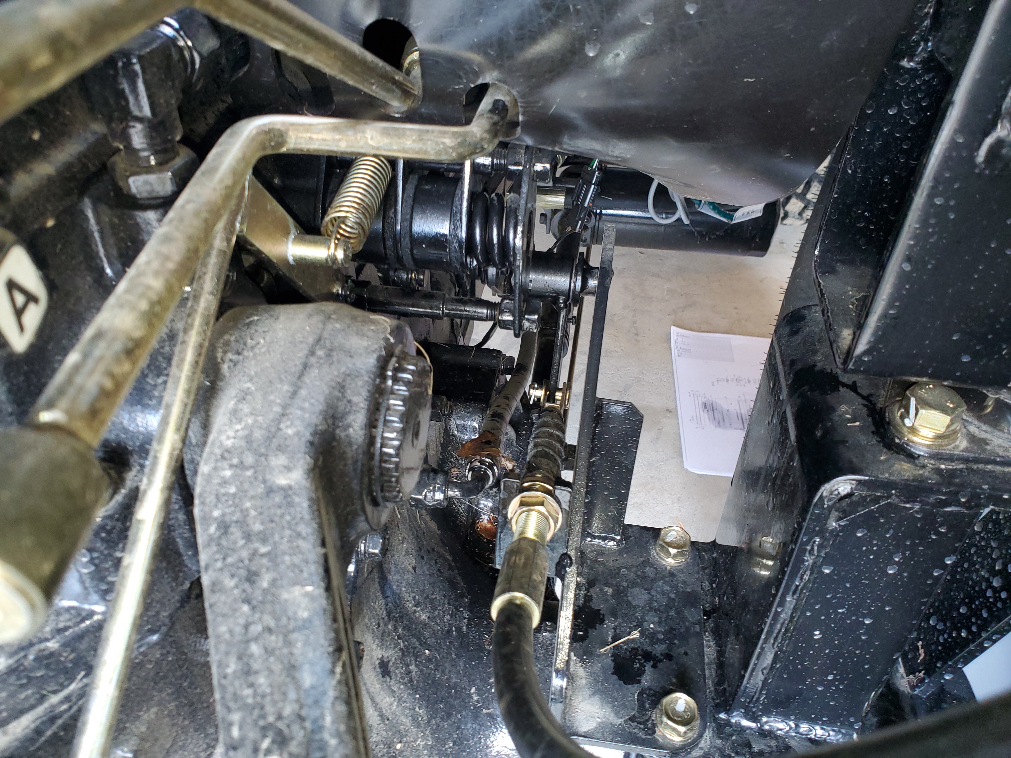

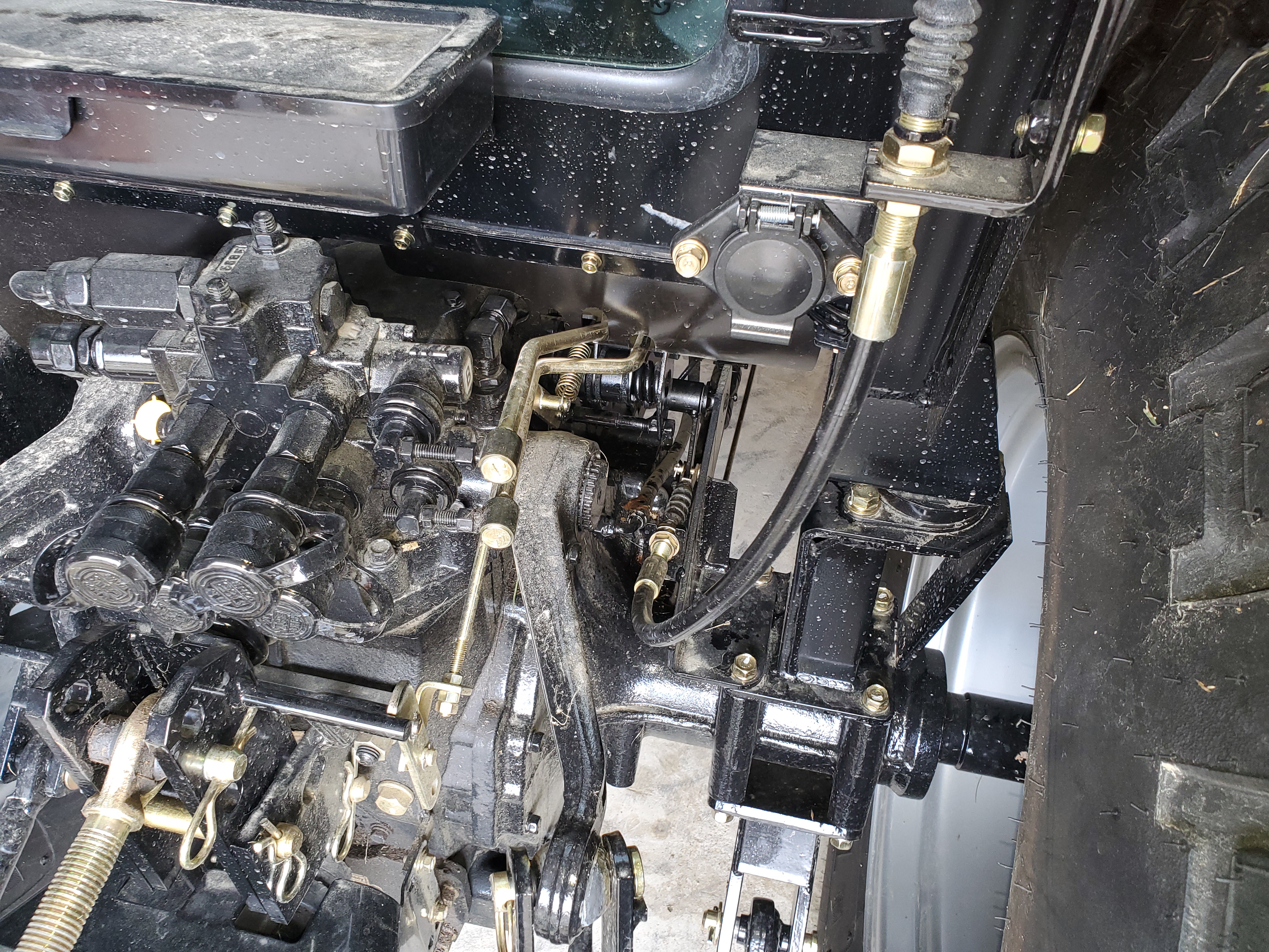

What you describe sounds like what's known as 1/4" valving.
I don't think I've saw any pics of the linkage system used to signal the Position Control??
I'm totally unfamiliar with the tractor in question so have no visual memories to go by.
How about a good pic of the 3pt lever setup?

The feedback linkage for the position control on these Korean compact tractors is located inside the 3 pt housing, so it's kinda hard to make adjustments.
The only linkage outside is for the draft control but it's usually a feature not installed for the US market.
   / RK55 3pt fine tune #24

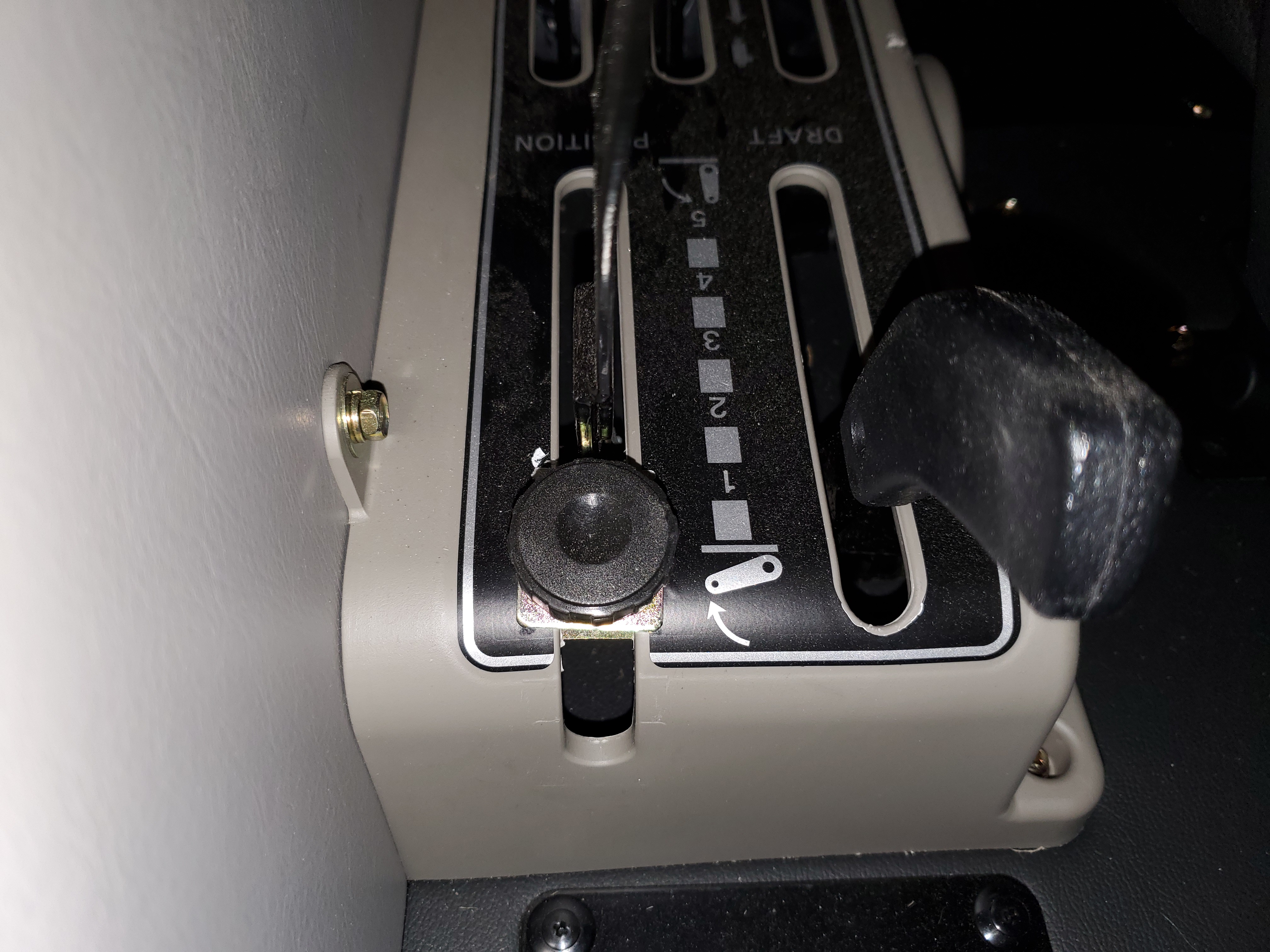

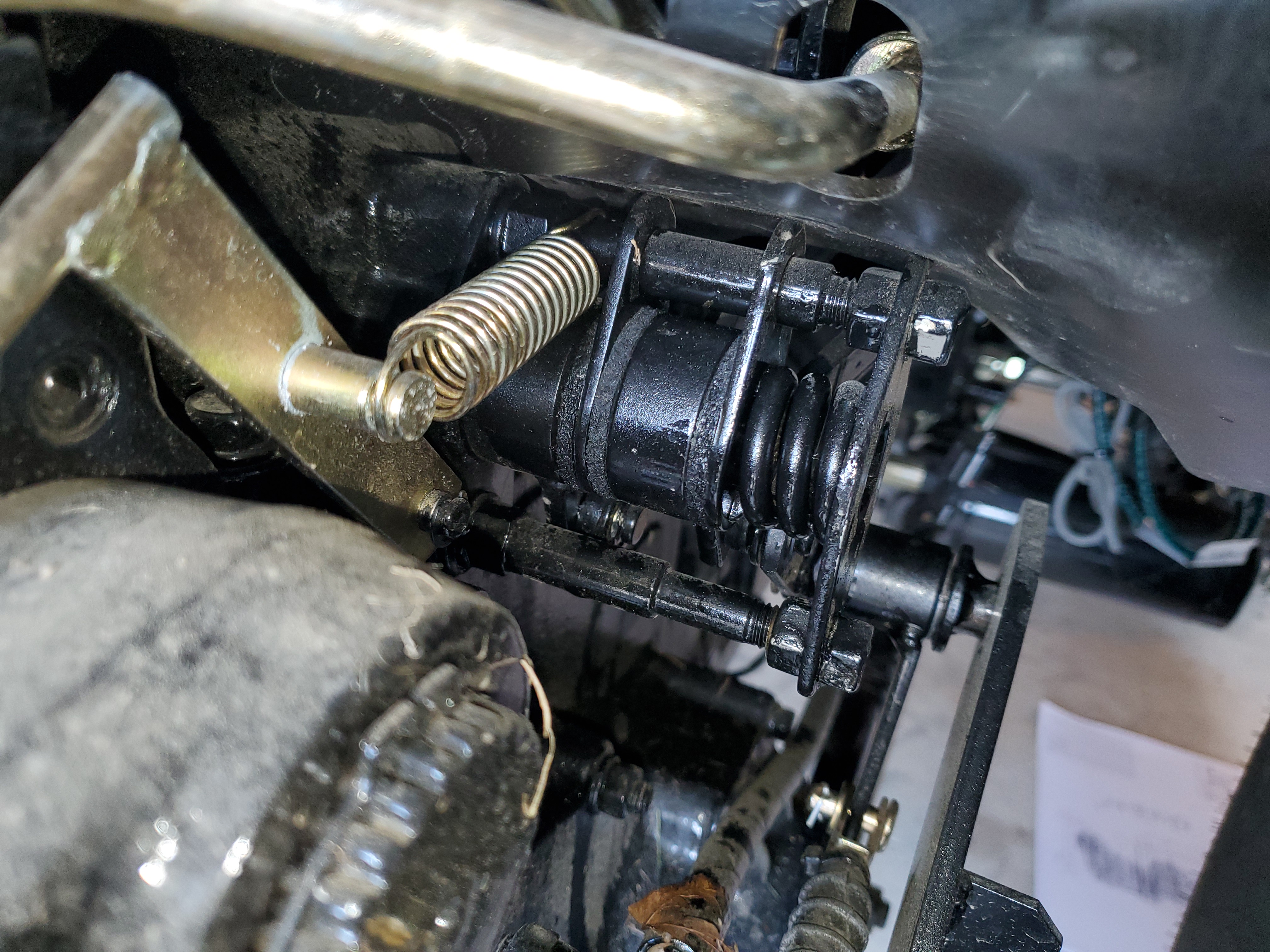

Here are a few pictures

Looks like you do have draft control.
I wonder if adjusting it, would help your issue in any way. Hopefully someone more familiar with draft control can help.
I've played with mine for a bit and actually adjusted the rod to get a bit more sensitivity out if it but I'm not sure if would help the position control.
   / RK55 3pt fine tune #29
I do have draft control. I’ve read what it’s supposed to do but have never had a reason to use it. I did try moving it to different positions, but it didn’t seem to have any effect on the smoothness of the 3pt lift.
   / RK55 3pt fine tune #30
I know what you’re saying about the reaching around to the knob, but I think that’s normal. It’s like that on my older John Deere as well.
