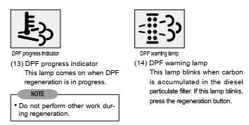

kkilli, on page 2-14 of my manual it states that when the regen button starts flashing that you have to press the button to start the process. It also states that no other work should be done while the regen is in progress.
/ RK37 regen #8
“If” the light flashes....mine has never flashed. It’s gone on solid and as long as rpms are up it will complete without issue in under 30 minutes.
Pressing the button is for manually starting the process that either hasn’t started automatically or was stopped/hasn’t completed for some reason.
Like I said, mine has been through it 6 times in a little over a year. It’s no big deal, don’t over think it....
