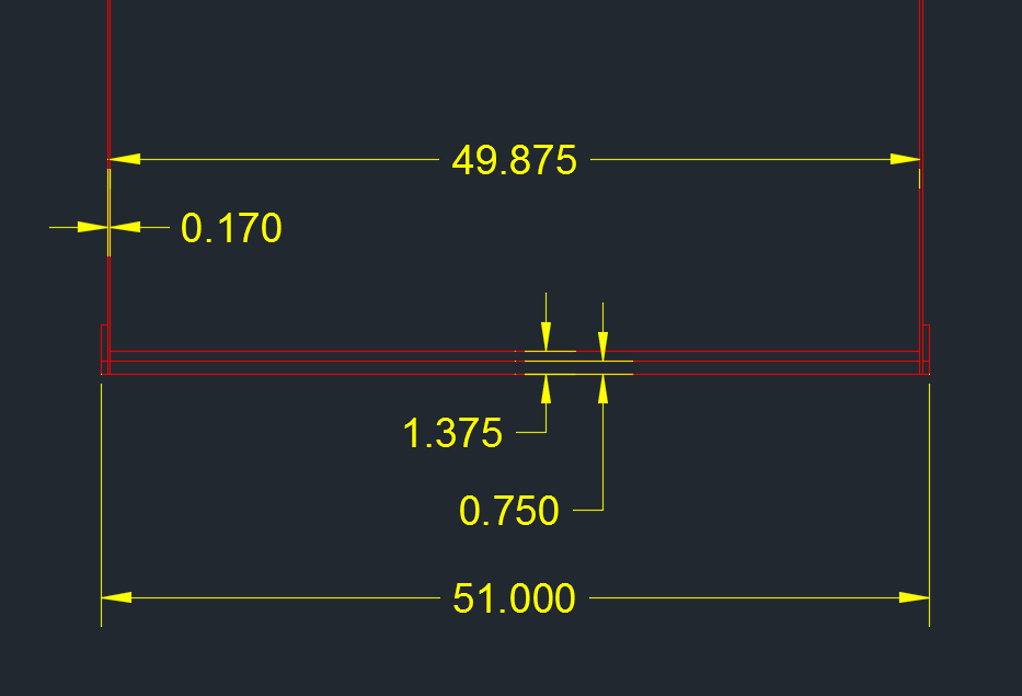

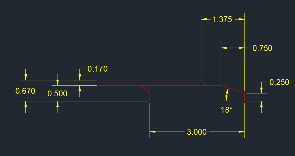

Here are the cutting edge and bucket dims you wanted, as measured from my RK24 with 50" bucket.
The first picture is a cross section view of the cutting edge with the leading edge to the right.
The second picture is a top view of the cutting edge and bucket walls. The cutting edge is a little wider than the bucket walls and has small (maybe .125") fillet welds on both sides of each wall.
There are also two fillet welds shown in the cross section view.

Nice drawing! I was a draftsman way back in the day and appreciate attention to detail. I'm sure it will be helpful. Website, shop manuals, owner's manuals, just don't have that kind of information. And you know what? Sometimes you just need to know. :)

That was just a quick 5min AutoCAD sketch, but thanks.
