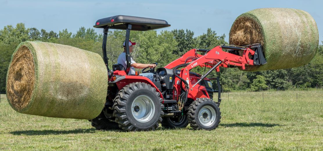

Just for reference...My recently traded WM 50 was rated at 3550 pounds at the pins and 2200 pounds at 800 mm to full height. That is 62% of the max at the pins. 2116 pounds at the pins multiplied by 62% equals a little over 1300 pounds. I don't see an issue with most round bales.

I like the video, but that's a lot of abuse on the front axle since he isn't using a rear ballast.
Good observation but that tractor has 1200 lbs of Rimguard (beet juice) liquid tire ballast in the rears, as does every RK 55HP tractor sold with a loader. We want the tractor and loader to be ready for work the day our customer takes it. Our RK37s have 900 lbs when sold with a loader. No extra charge, it is part of he loader to us.
   / RK Tractor reviews??? #225
I figured it had loaded tires, and while that definitely helps with stability and makes it much safer it doesn't help at all with the stress on the front axle. But kudos to RK for making the filled tires a standard feature.

These bales weighed 1100 lbs. when we did the photo shoot. Specs are good for comparisons and apparently a lot of debate fodder. The real world is the decider. Our RK37 with L102 loader can do anything that a tractor in its class is expected to do.
A word of caution: In the real world a poster interested in your RK tractors just asked you how much weight a BUCKET MOUNTED BALE SPEAR could lift, not a SSQA Bale Spear, and then asked 1500lbs? and you responded with "Our RK37 with L102 loader can do anything that a tractor in its class is expected to do." Are you saying the RK37 can lift a 1500lb bale with a bucket-mounted bale spear? Is a tractor in the RK37 "class" expected to lift 1500 lb bales with a bucket mounted bale spear? Is there a better answer or solution?
Major....
I watched that video Mike made of the RK37 lifting the log. He said the log was roughly 1176 lbs and averaged 25" wide so the center with the grapple depth would be close to 500mm from the pins. I looked up the grapple weight (we'll round up to 300lbs more than the bucket which is high) and added to the log weight and that log was within the advertised RK37 loader specifications. I have doubts about a 1500lb bale with a center of gravity roughly 4.5' from the pins.

It’s rated 2100 pounds full height lift at the pins which is about 300 pounds more than my old Kubota. Assuming that accurate um betting it would lift a 1100 pound bale.
