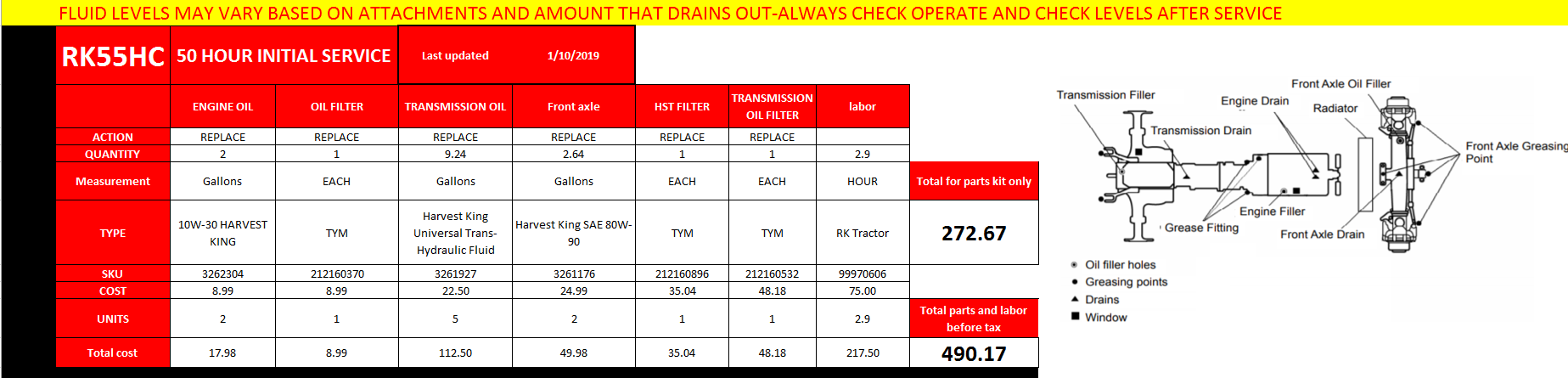

   / RK 55HC 50 hour service #12
This is what they gave me when I asked for the filter and fluid list for the 50hr service. It has SKUs for the recommended fluids.

Yes I did get the filter. The only things I picked up at the store were;
Oil filter
Oil
Gear oil
Hydraulic fluid
