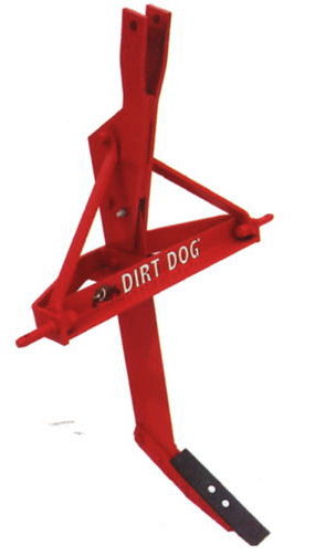

I used a DirtDog subsoiler to rip out the roots in a new vegetable garden after the stump grinder finished his work on about 10 stumps. When you hook a large one that stops the tractor, lifting up on the 3-Point usually could bring them to the surface where you can hook them again in a different direction to get the rest of it up.
This thing weights about 110lbs and has a shear bolt to protect the tractor. I broke the bolt a couple of times moving a little too fast when I first started.

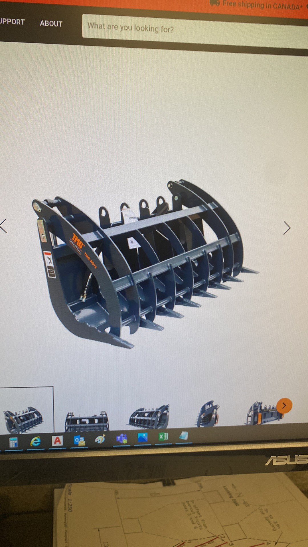

I just bought a root rake grapple … i haven’t try it yet.
