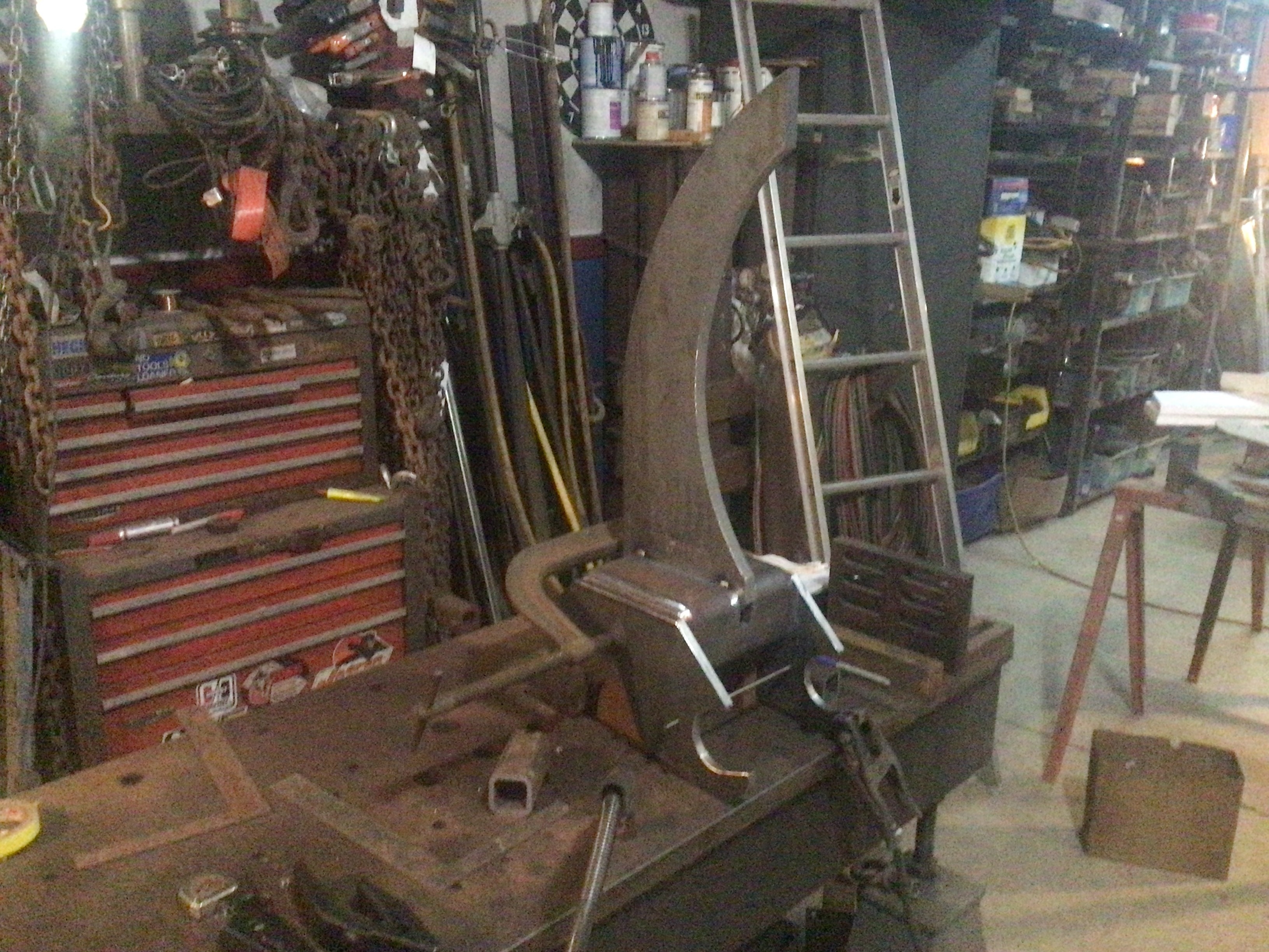

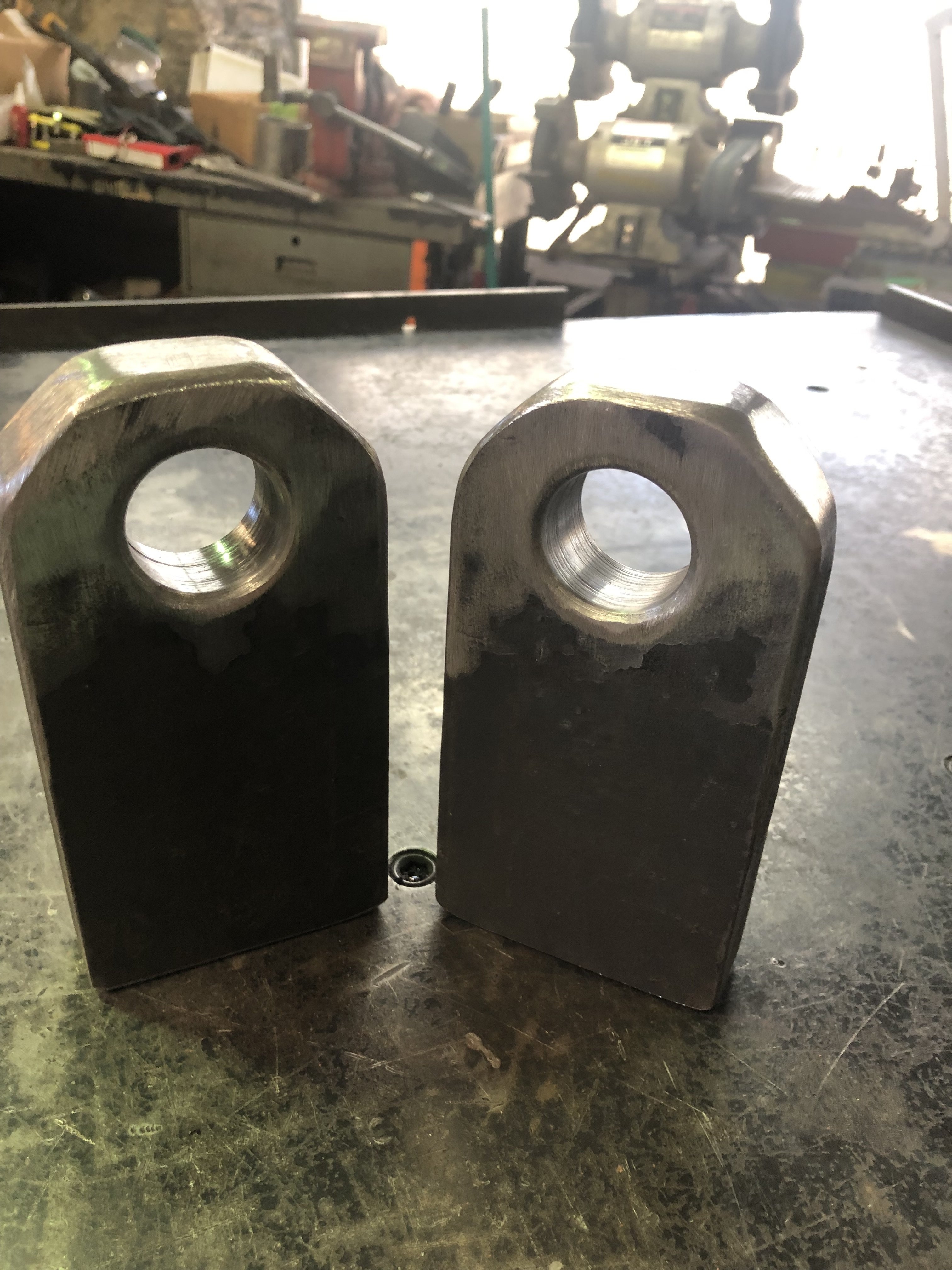

I simply couldn’t get myself to spend $1,000 so off to the shop I went. Here the tooth is about 90% complete. I have yet to install the tip but I need to check clearance to the stick of the backhoe 150 miles away.
This is for my JD 110 TLB.

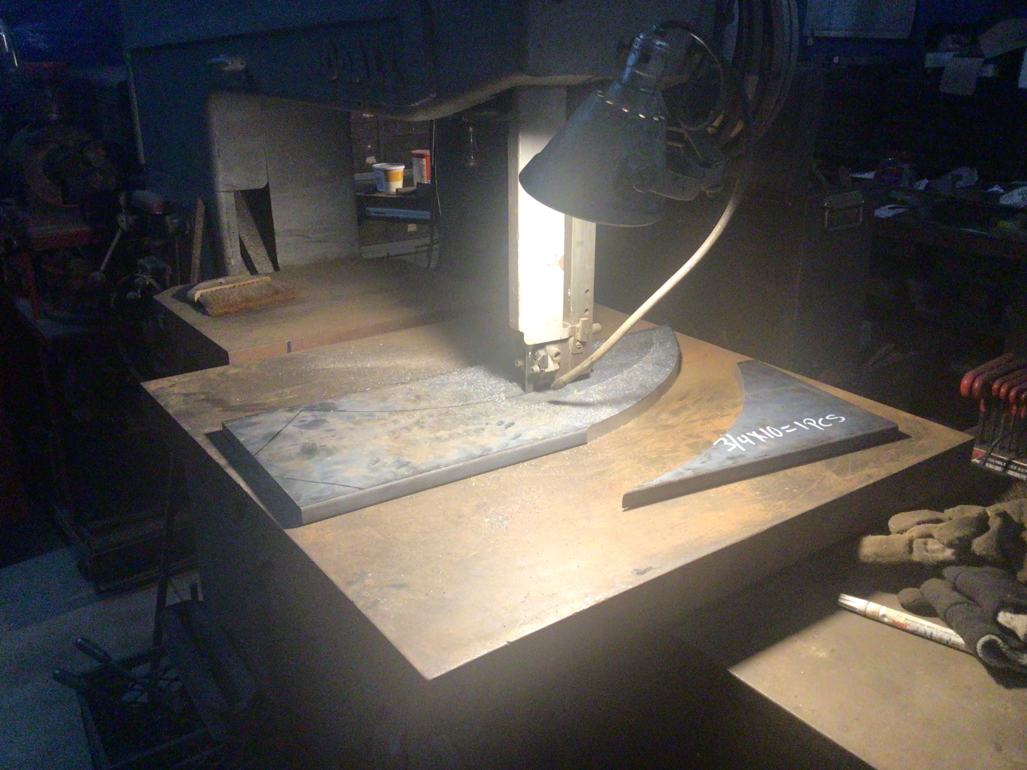

The tooth is made from 3/4” Hot Rolled trimmed on the band saw.

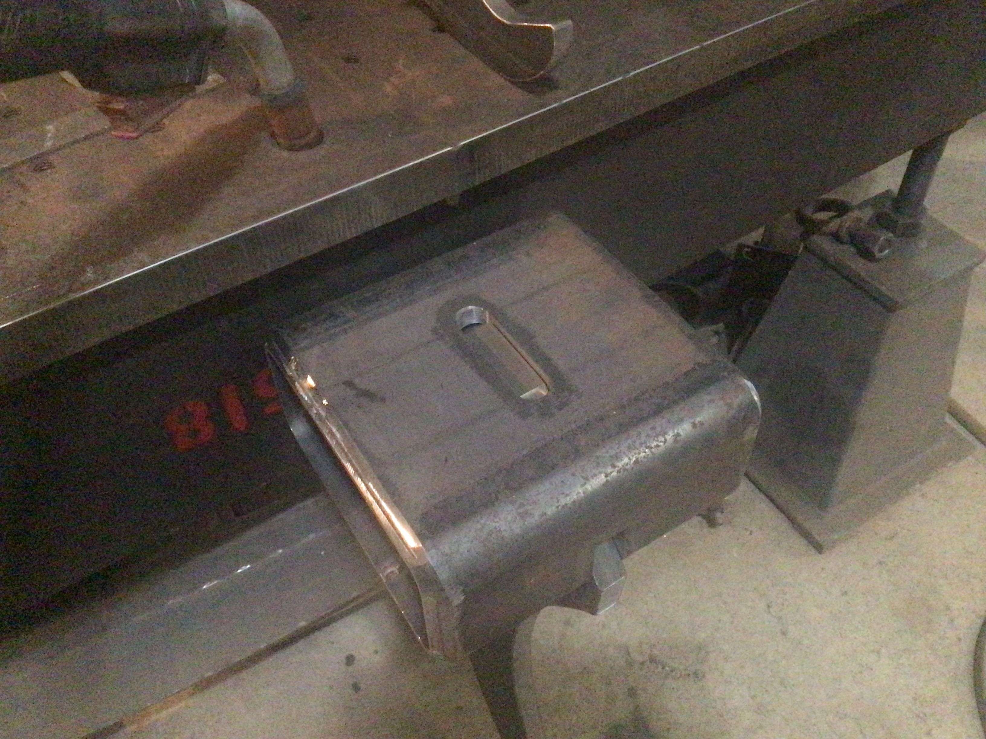

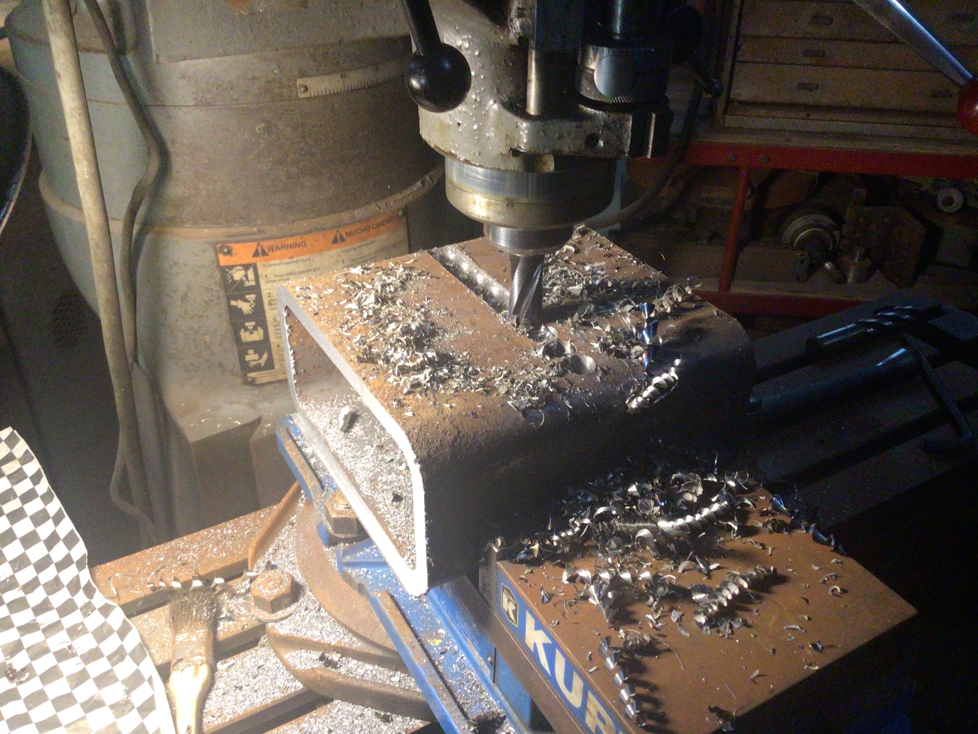

The hub is made from 4x8x 1/2” wall tube.
Here I am milling a slot for the tooth to pass through.

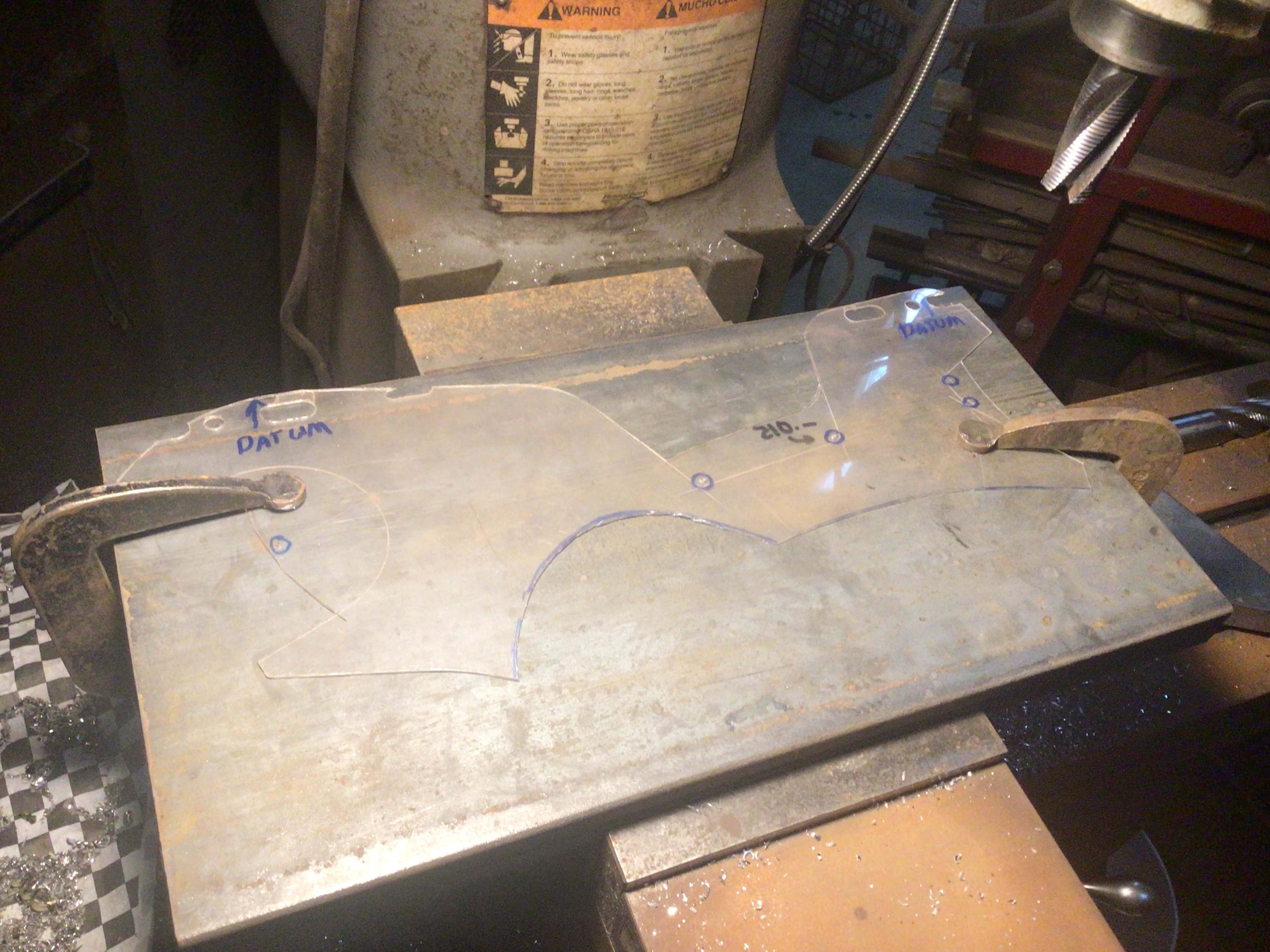

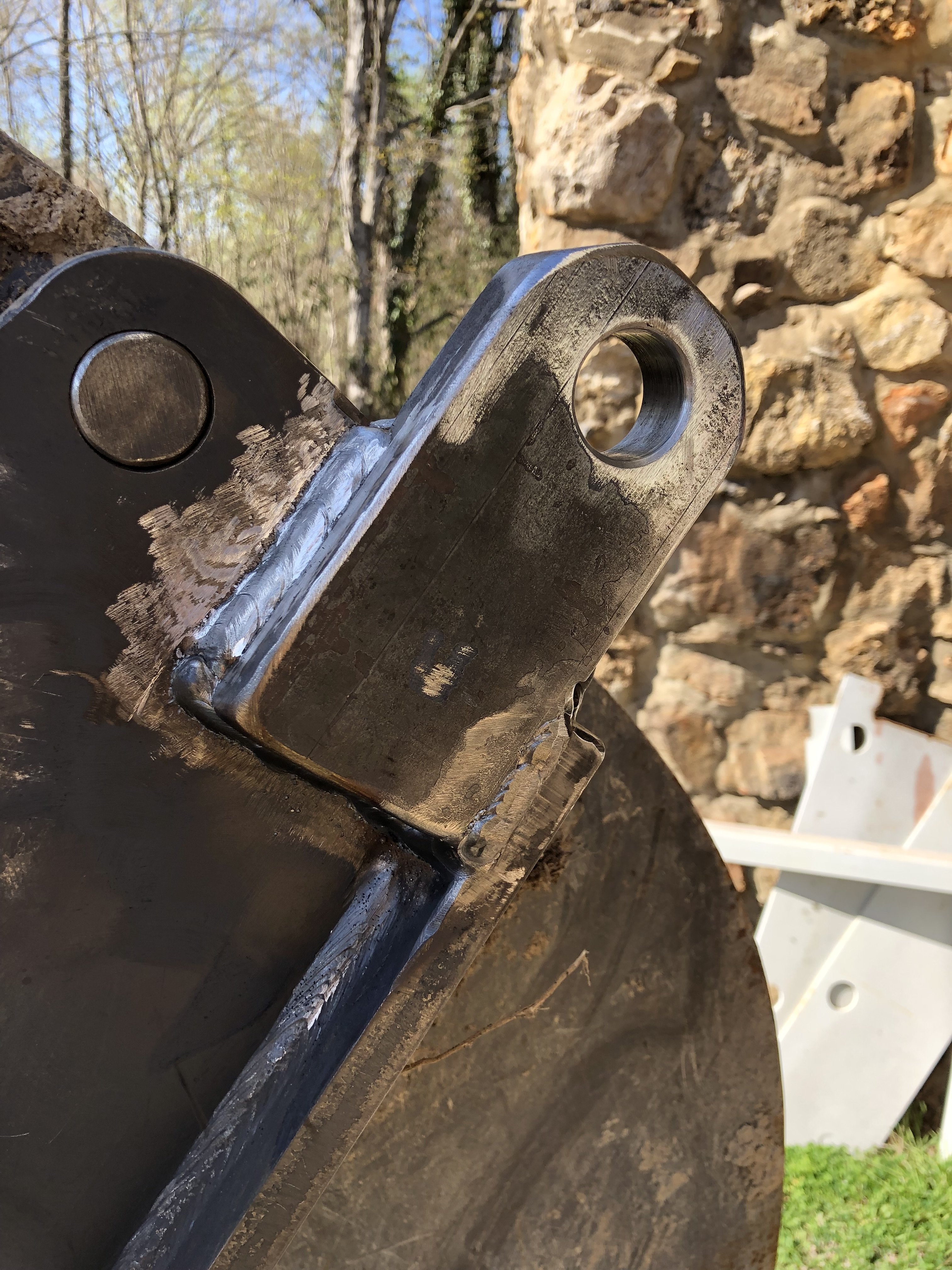

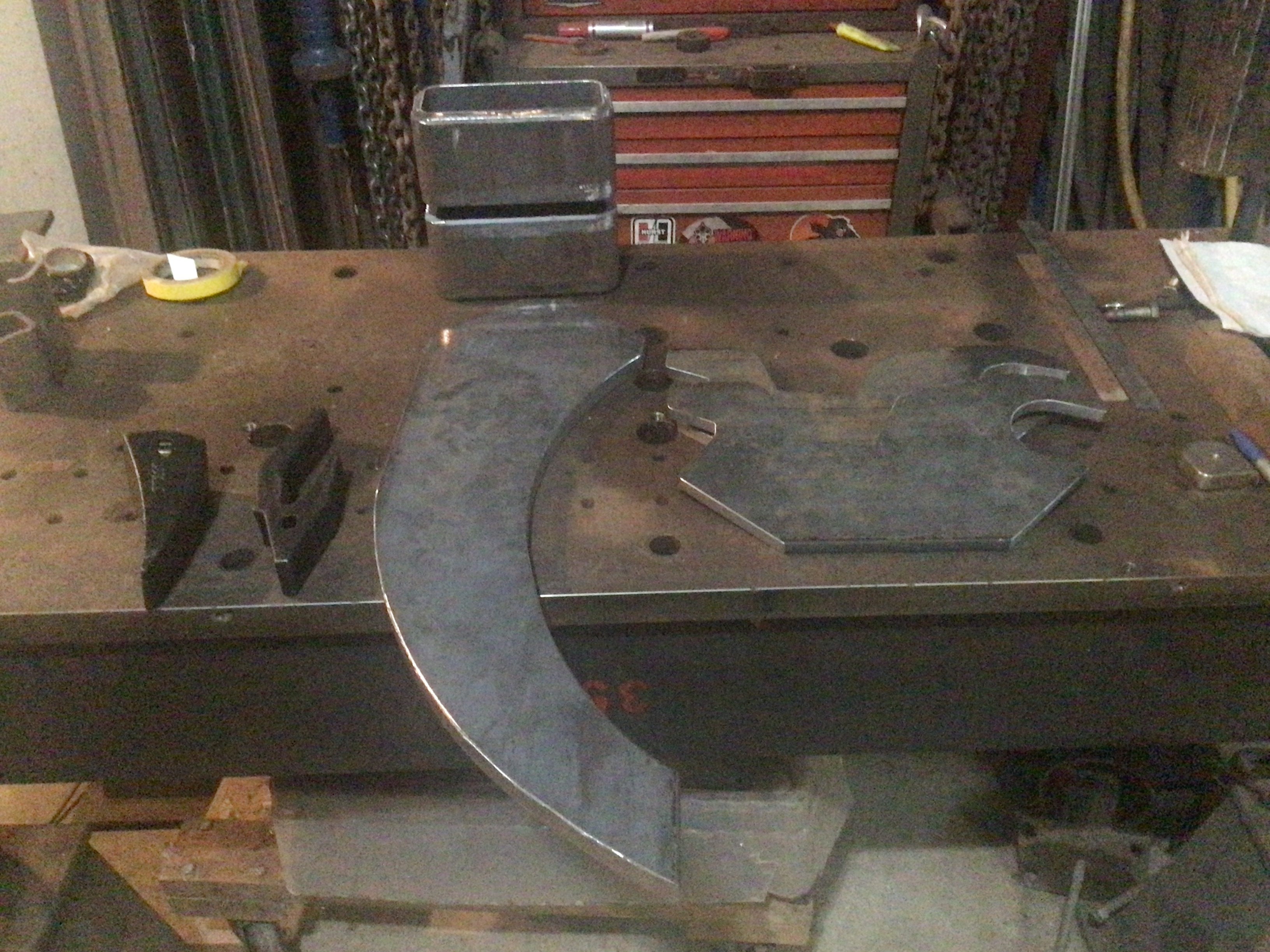

Here I am preparing to drill the corners of the trim for the quick coupler ears. The template has all the information needed. I can use this template in the future.

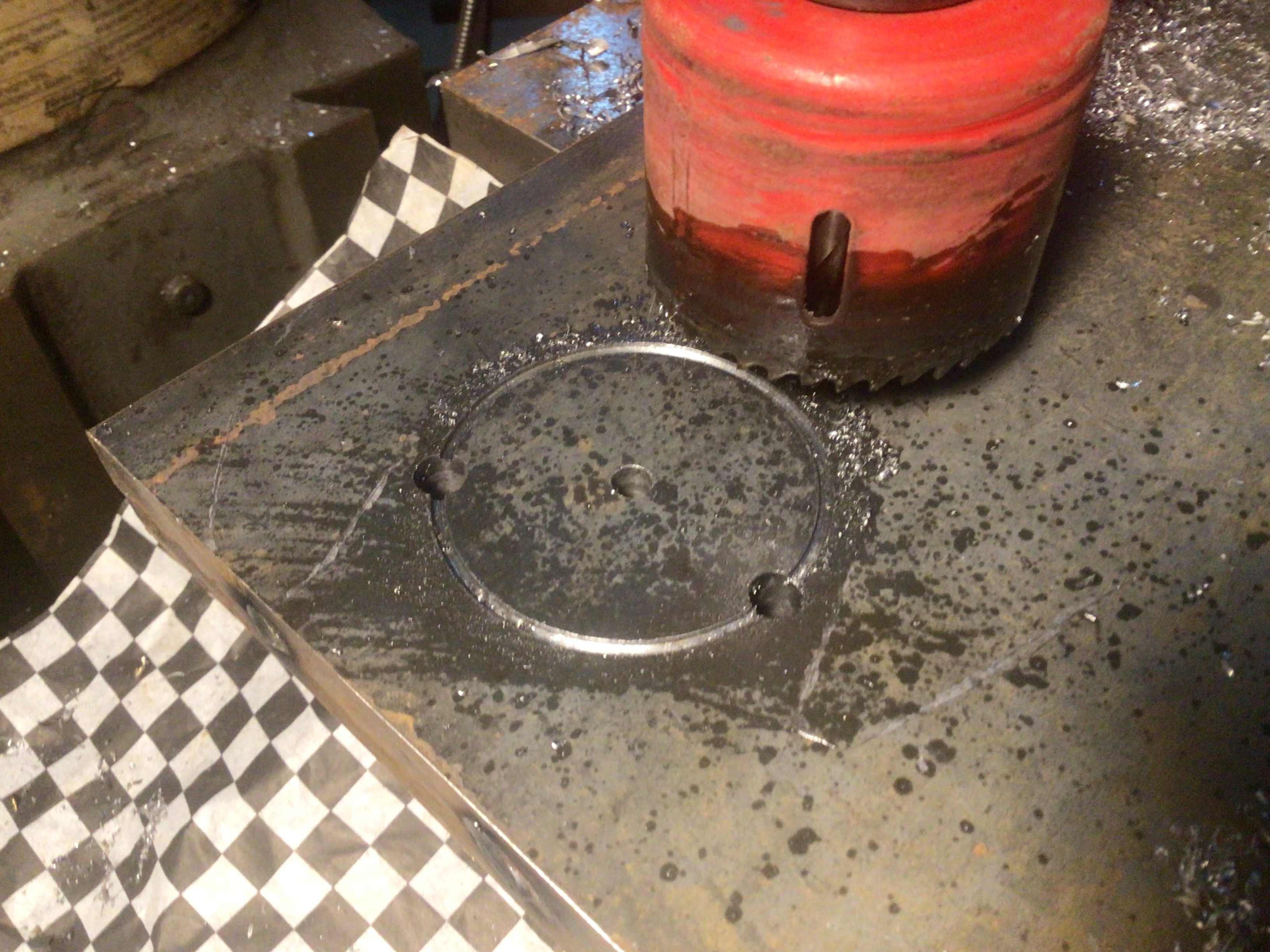

Cutting with a hole saw. Notice the two drain holes I cut. This prevents chips from loading up in the cut and allows uninterrupted cutting. Much faster this way.

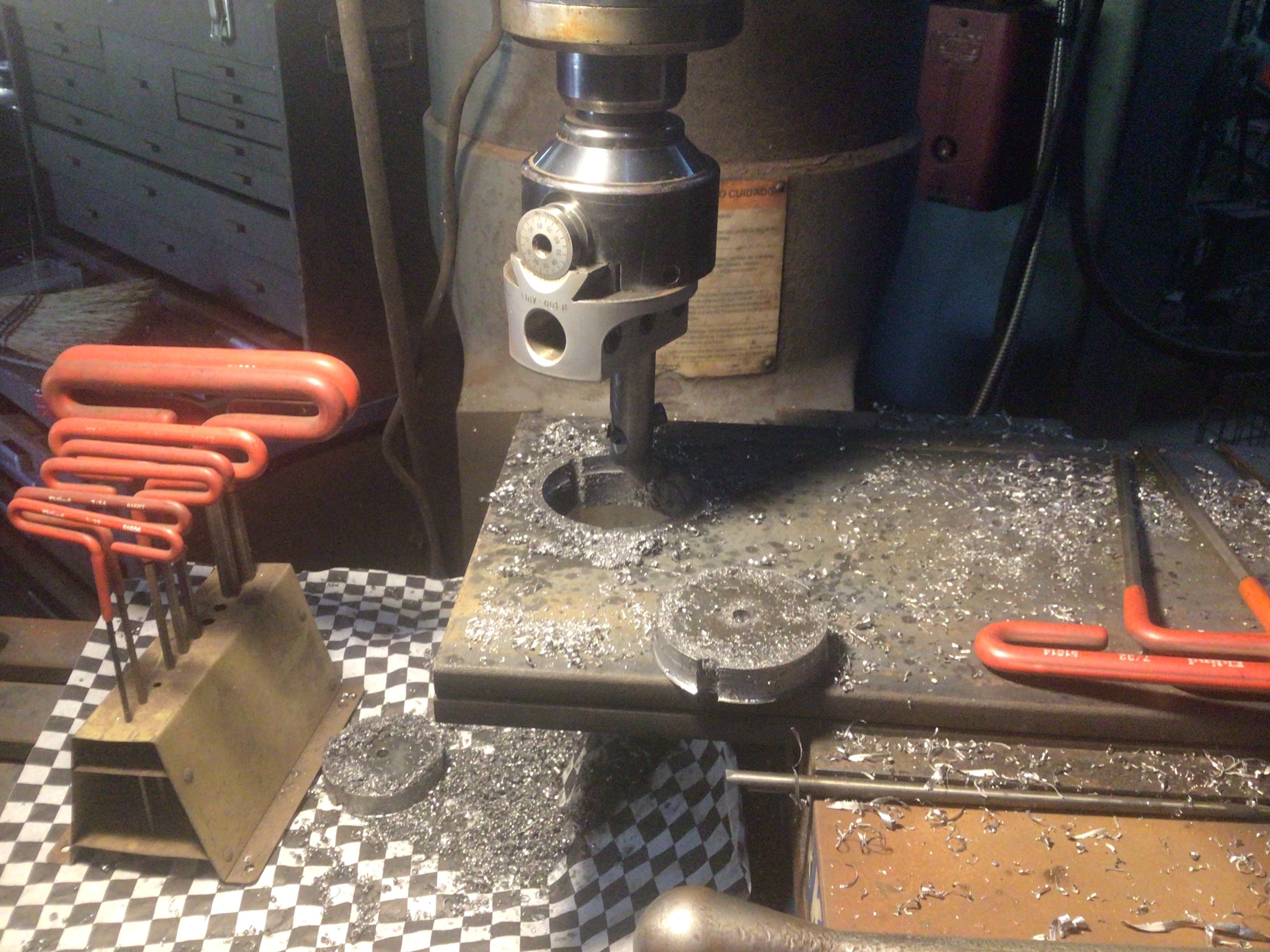

Finishing the hole to size with a boring bar.

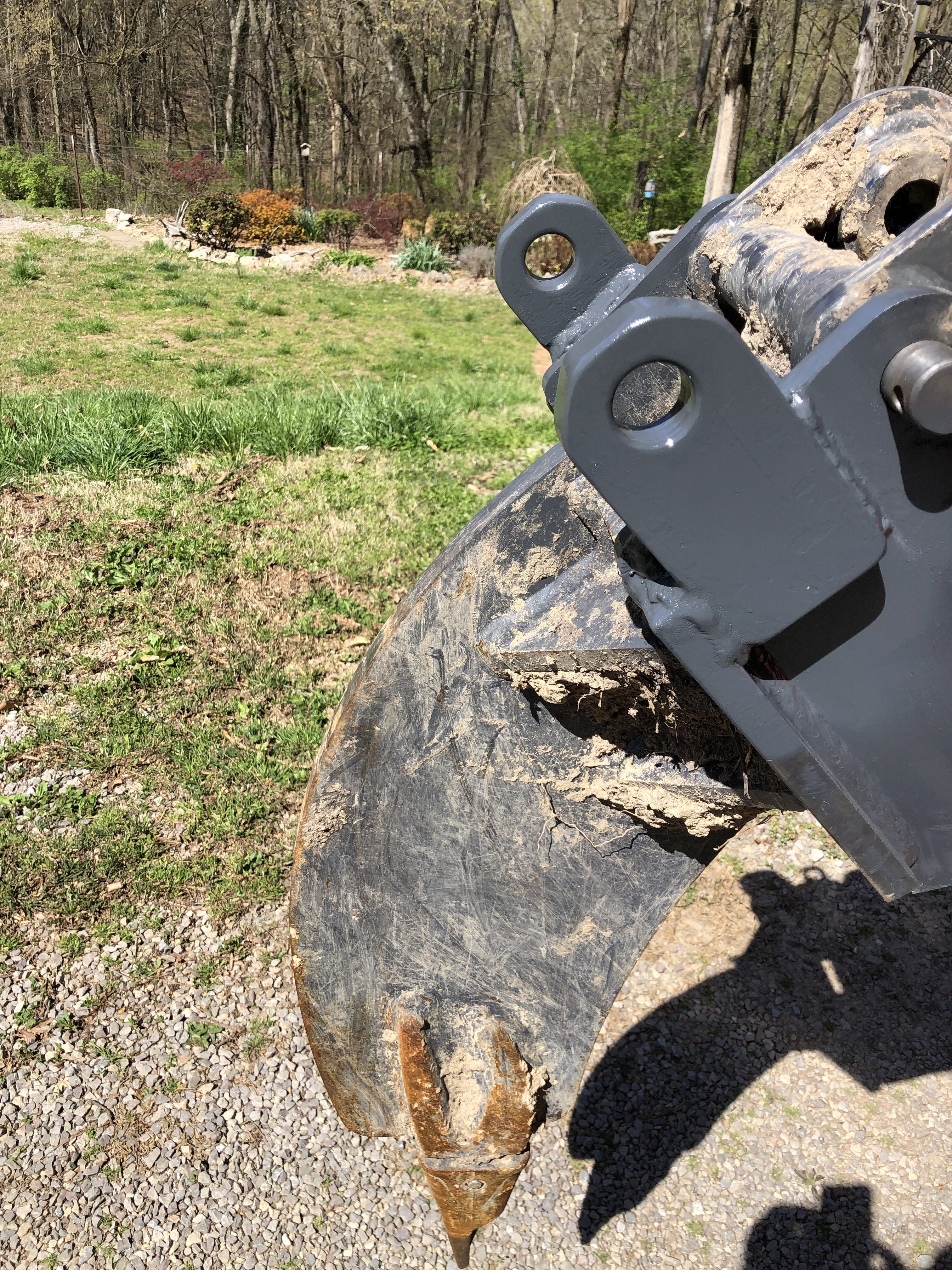

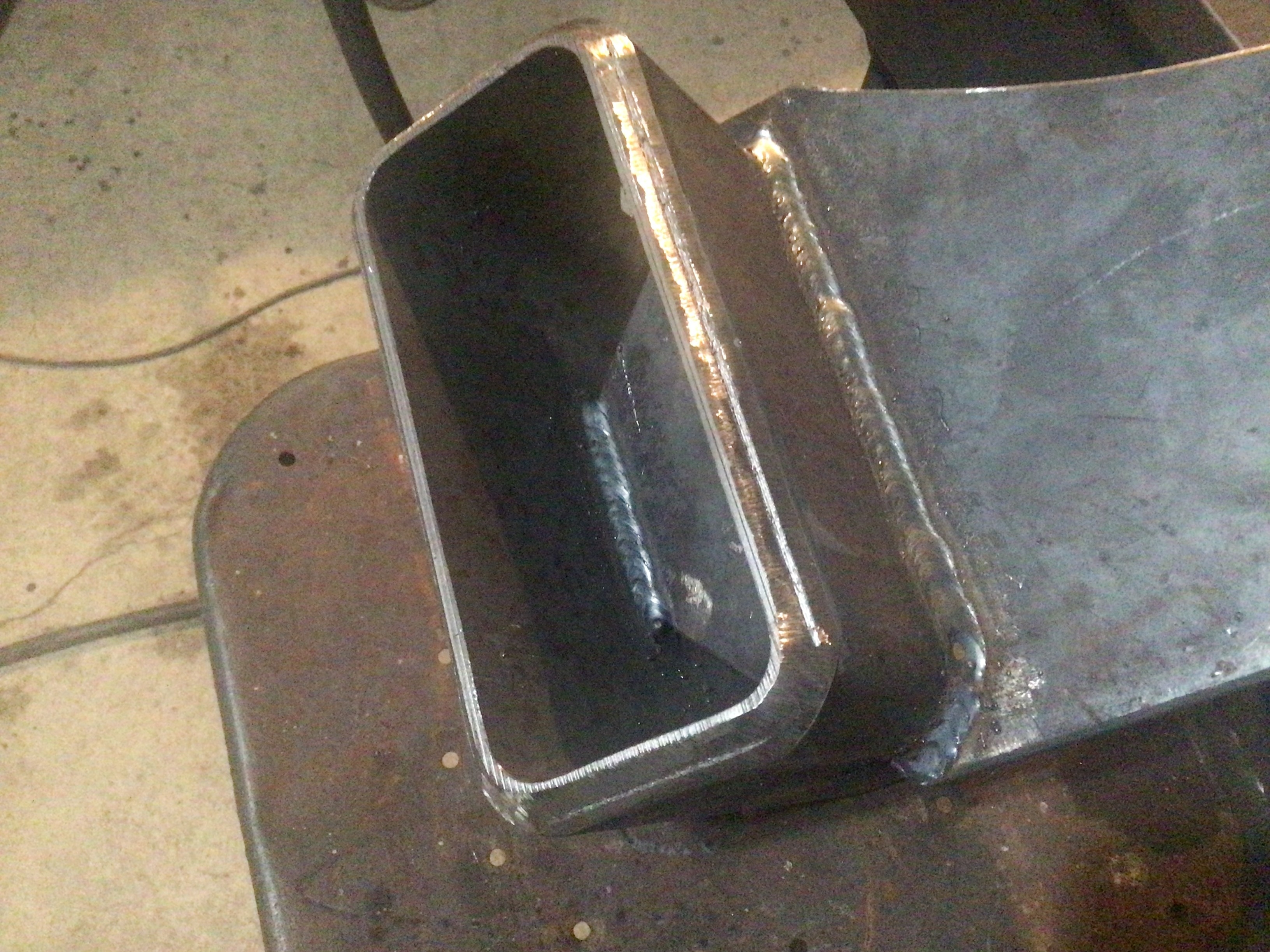

Showing how the tooth passes through the hub to be plug welded on the end.
   / Ripper Tooth for the Backhoe
#9
The tooth is welded inside and outside the hub.
