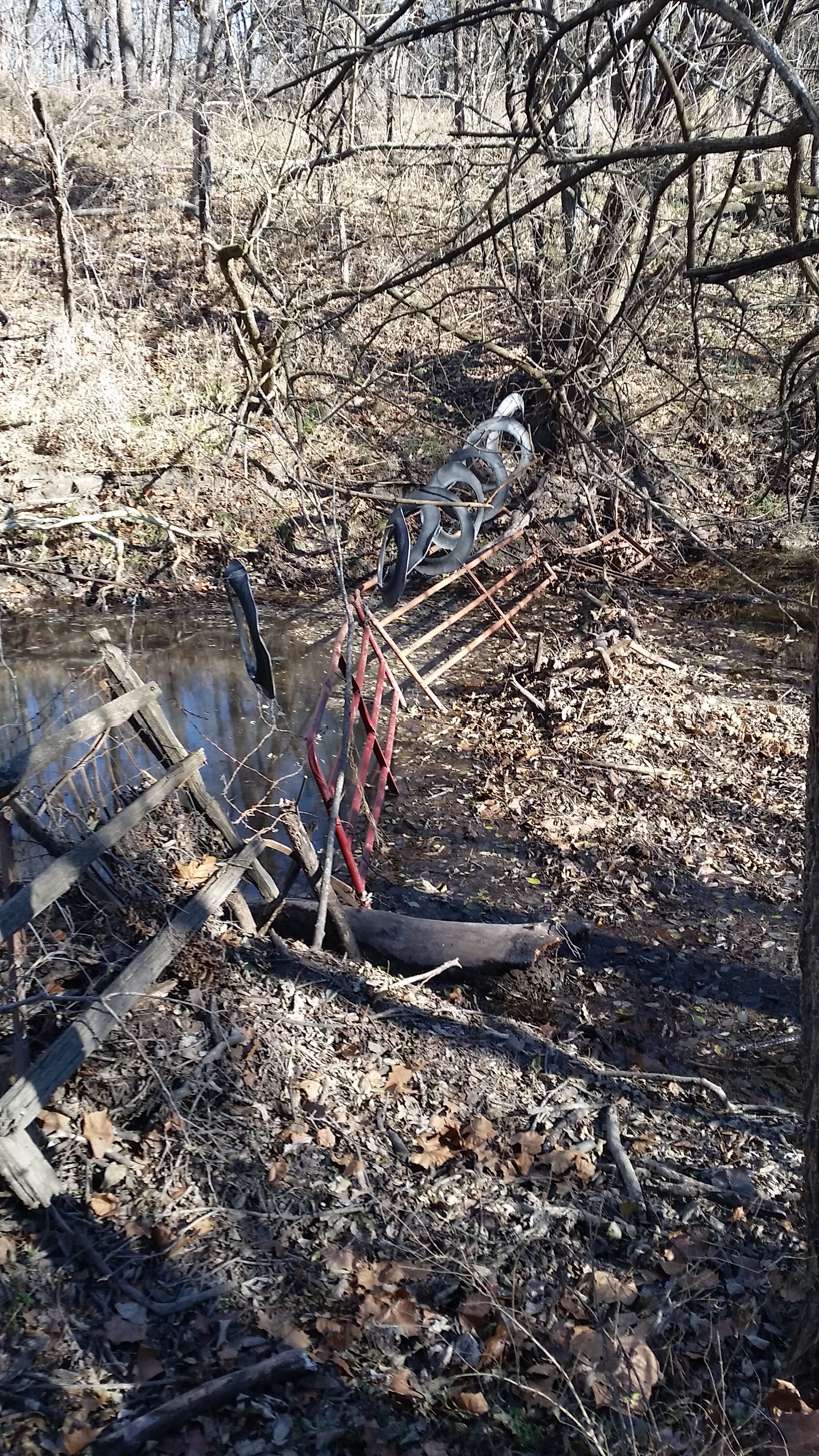

The rock in the bed will not stop cattle from venturing across it, especially after some dirt has settled in and made it smoother.
A water gap would be easier and less cost than the rip-rap. If the water only comes up every couple of years there will be virtually no maintenance to the water gap. Set some good post and hang a couple of old gates across the creek.

In Missouri, a water gap is a fence crossing a water path such as small stream or creek. They are a bitc* to control here. Every big rain tries to take out the fence. I think he's asking if he can stack rip rap which in theory would let the water thru and create a wall obstacle that the cows can't traverse. :)

Best I've saw was a strong cable spanning the creek with the top rail of the pipe gates fastened to the cable. Bottom of the gates resting on the creek floor. This allowed them to swing open and let rushing water/trash thru. Required a visit after a large rain to make sure nothing have caught on the gates and held them open.
/ rip rap as a water gap #9
I get old sidewalls off of car tires from the tire shop and put them on the cable. Then wire the sidewall to the old tube gates. oil pressure gauge 004.jpgoil pressure gauge 005.jpg
It does require constant surveillance and removal of limbs caught in and under the metal.

D2, I looked at your pic and instantly thought "that's a typical Missouri water gap", then remembered your location!!!! Cheap and very effective!!!! The Missouri way!!!! :D
/ rip rap as a water gap #11
I'm actually on the Kansas side, but only by about 25 miles from where that picture is taken (Linn county).
/ rip rap as a water gap #12
Typical design for our area though. :)
