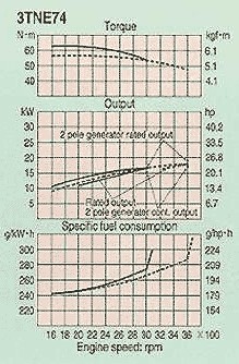

Hold on! The 2210 and 4110 have the same engine (3TNE74)... What's the point?
The 2210 is primarily a mowing machine, they derive the HP number at a higher rom (23@3000)
The 4110 is a Utility CUT It is listed at a lower rpm: (20@ 2650)
