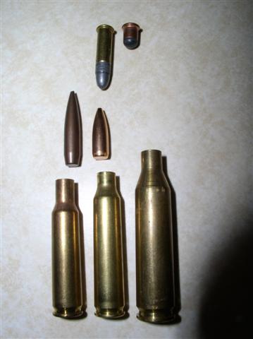

These are based on a rimfire (primer in the rim) case with various bullet styles (hollow point, round point) (projectiles) all .224 inches dia with varying weights and propellant. These will all have varying ballistics. Roughly speaking a 22 LR is 29 grain lead 1100fps. These are non reloadable and cheap.
Centerfire rifle cartridges (primer in the center) make up almost all of the modern game cartridges.
222
223
22-250
These all shoot a bullet that is .224 in diameter and can range from 40 grains to 80 grains in weight. A typical 223 is 55 grains Full metal Jacket at 3200 fps. These are more expensive but reloadable.
