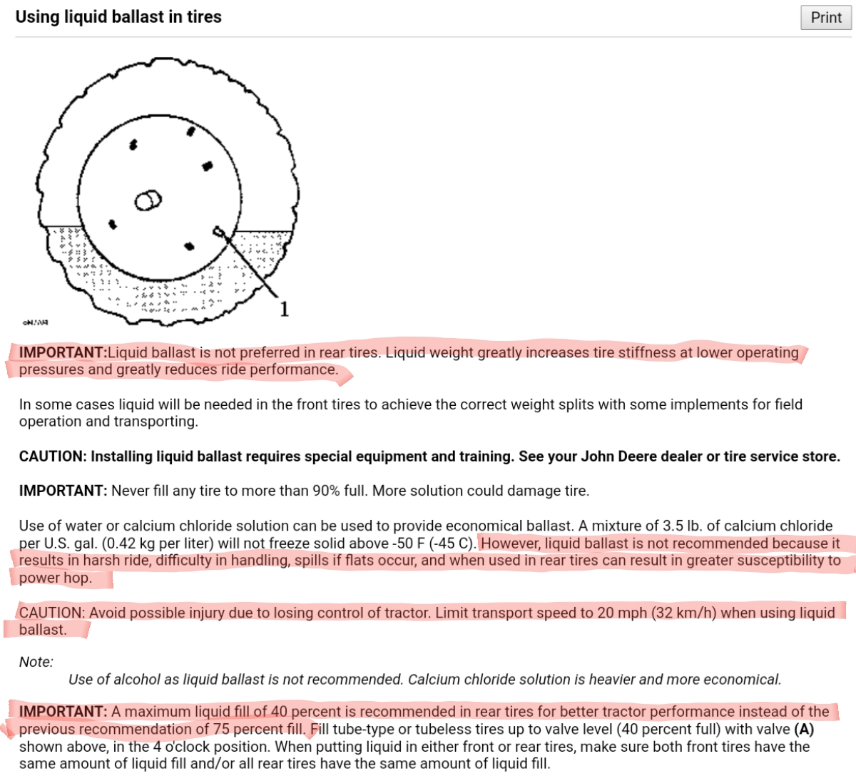

Using liquid ballast in tractor tires.
I can’t help but think liquid ballast works better than nothing, but the downsides of using it, as described above, are not a long term, reliable or practical method.
/ Rim Guard and punctures #28
Multiple manufactures quietly recommended only 40% liquid fill. They do this at a low level because they know their dealers are still filling at the 75% old standard.
For someone with 350 pounds liquid per tire this takes it down to 190 pounds.
/ Rim Guard and punctures #29
So what do they do with the tubeless Calcium Chloride fills. Supposedly it doesn't corrode the rims if the rims are completely submerged and can't interact with the air.

when you do a 90% fill your ride quality is dismal and if large enough rocks are hit with sufficient force you can actually split a tire open.
