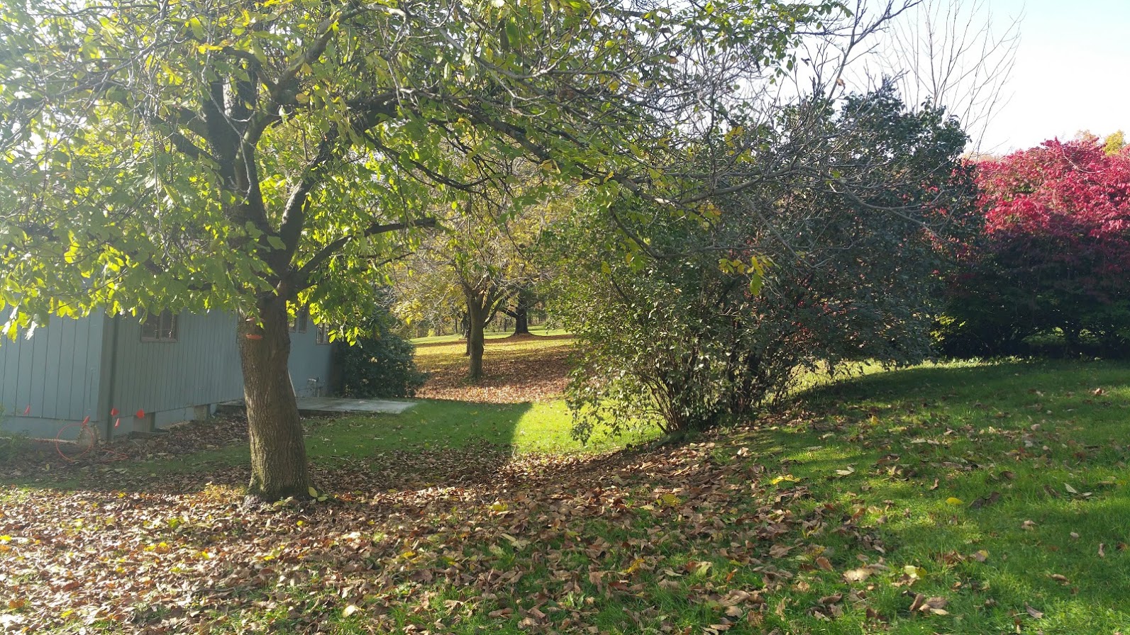

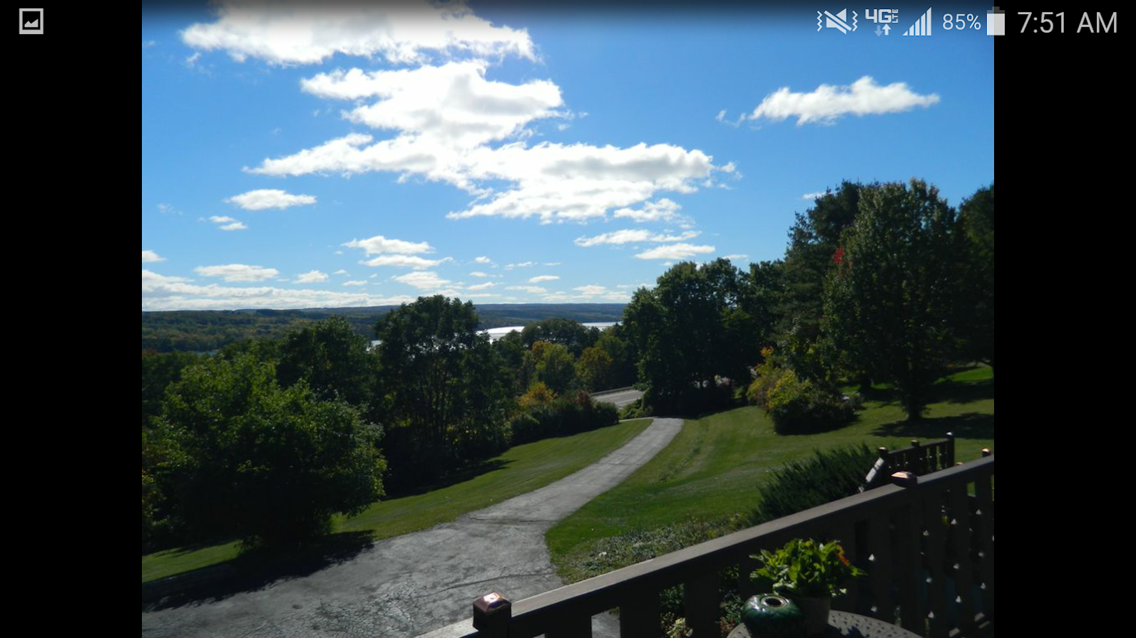

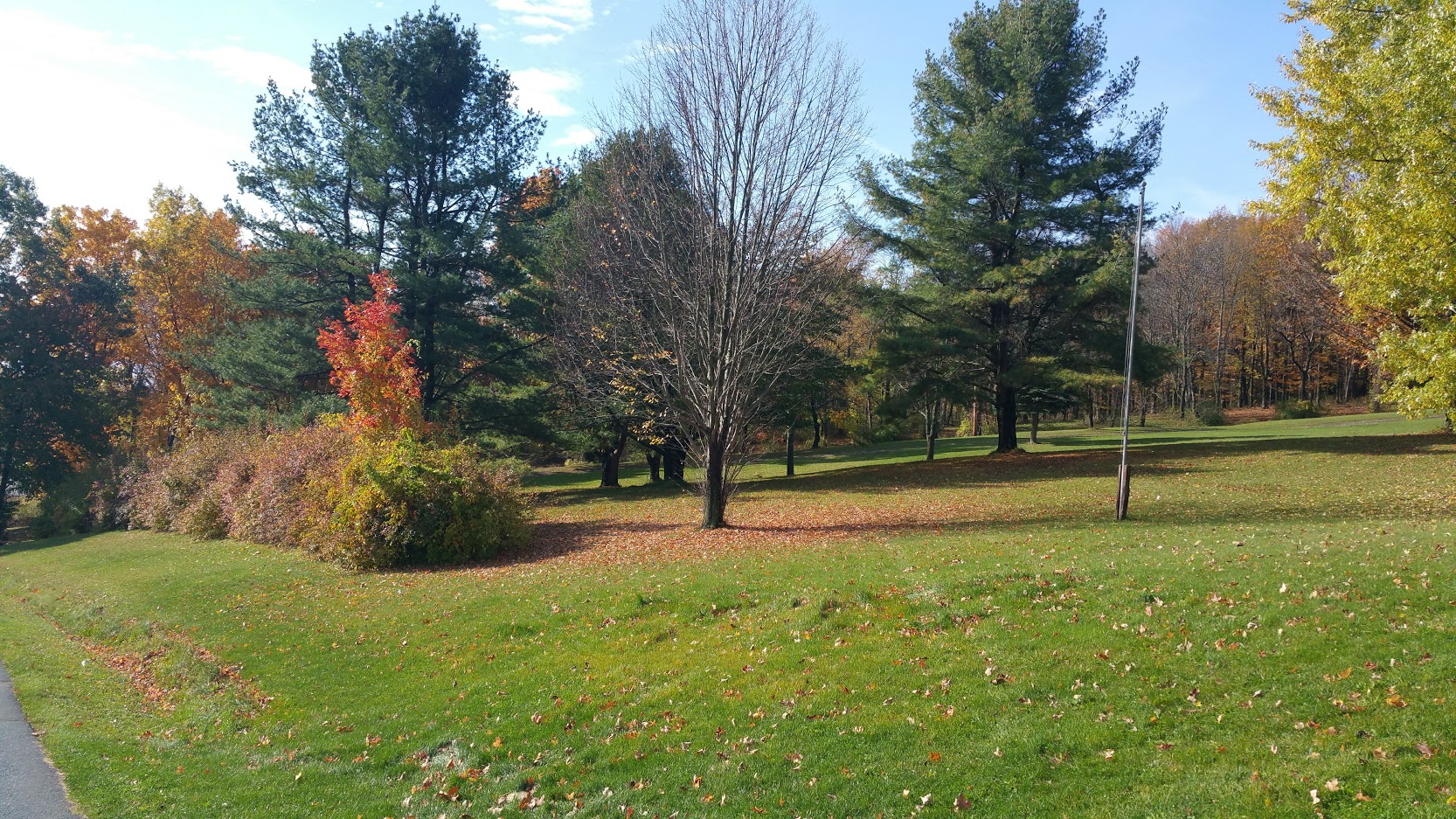

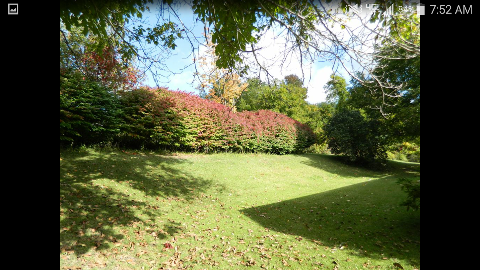

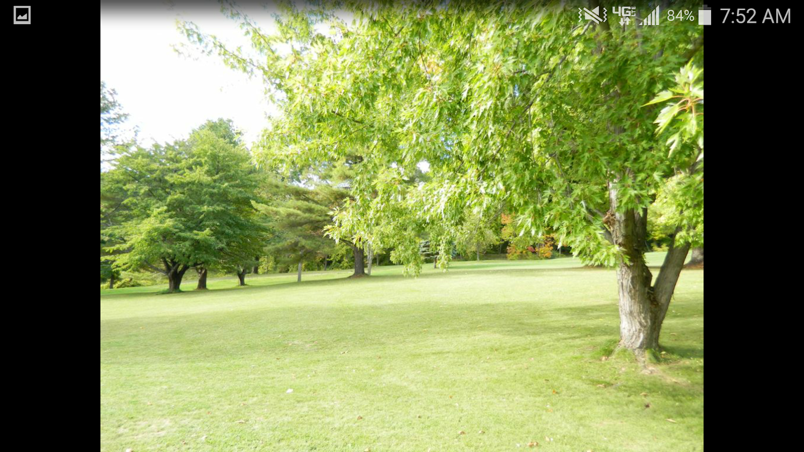

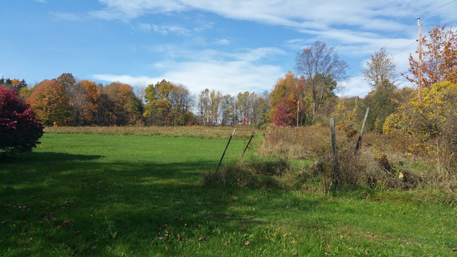

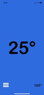

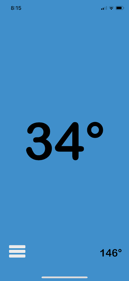

I have about 6 acres of varried terrain almost all of which is a slope. From 2-5 degrees to 25-35 degrees. I currently pay a guy to mow the 3 around the house and another guy to brushhog the 3 acre field out back...I'll try to post some pics.
I was about to buy a Kubota 2680 but they were closing so that gave me more time to research. I was already on the fence and close to switching to the Deere. Added encouragement for the Deere is the greater factory wheelbase, however looks tough to add and spacers with the 60 MMM?? Other than that I like the stronger loader and auto connect deck as well as the 3pt hitch control.

How does that price look? Which is better on slopes? Which can add spacers with 60 mmm? Can I have ags on back and r4 up front?
Is this just the wrong machine for the job? Better option? I arrived at a sub compact because I wanted to finance rather than pony up cash, I also wanted a warranty when spending $5k+, and I haven't found that grandpa selling his brand new meticulously cared for x700+ with like 100hrs... I have read where some guys use high end lawn tractors like the Husky 354 with the K66 transaxle and basically beat the **** out of them and toss'em after 5 years... Not sure if that's a better option??

I also eliminated green and orange due to cost as well as some of their business practices. Your slopes could be an issue with any machine of this size. I haven't added spacers and don't know if they would help. I can generally run more or less straight up and down mine as long as I'm in Low and 4WD. Mowing with a 2,000 pound machine will leave ruts in soft ground. My ground hardens up like rock when dry and I feel every bump with my RG loaded tires.
So regarding your comment about the slopes: Is this just the wrong machine for the job? Better option? I arrived at a sub compact because I wanted to finance rather than pony up cash, I also wanted a warranty when spending $5k+, and I haven't found that grandpa selling his brand new meticulously cared for x700+ with like 100hrs :p
