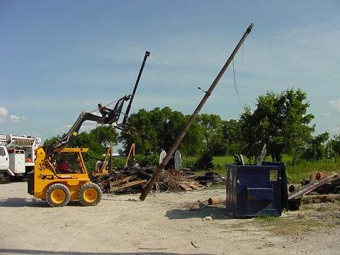

ns_in_tex, I did plan on adding a winch to the setup but ran out of time and money. I didn't want to just get a cheapie winch so I decided to wait until later when I can justify purchasing a heavy duty one that will last a long time. I want to make it fit into a 2" receiver so I can use it in different locations. I have noticed quite a few of your innovative creations that you have posted on TBN and it means a lot to hear "great work" from you.

wroughtn_harv, thanks for taking the time to post. I, like most TBN'ers, look up to you, even though your way down there in Texas. As you know your boom pole on your skid steer (Iris) that I viewed on your <A target="_blank" HREF=http://photos.yahoo.com/bc/wroughtnharv/lst?.dir=/Iris&.src=ph&.order=&.view=t&.done=http%3a//photos.yahoo.com//>website</A> was the original inspiration for my creation. You are right about the priorities, I would have loved to drop $600 to $800 on a nice winch but can't quite justify it at this time of the year.

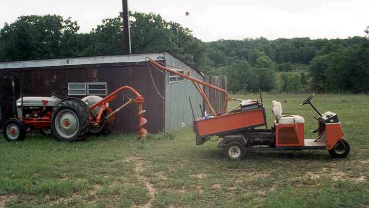

Hey Spencer, your unusual boompole mounting is really interesting to me because I did something unusual with a boompole about 8 years ago. I was putting in a fence and needed to lift crossties. Since my tractor had the auger on it, I mounted the boompole to my utility truck's hydraulic dump bed. It worked like a charm, but I could only lift two crossties without causing the front wheel to come off the ground. /w3tcompact/icons/shocked.gif/w3tcompact/icons/laugh.gif. See the attachment for my "rig."
