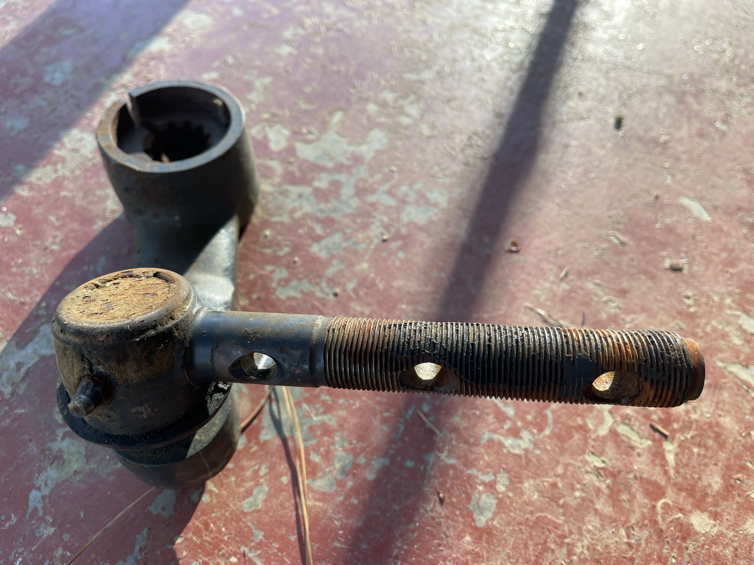

Thanks for the reply npalen. My tractor steering always worked. Until I had the tractor jacked up off the front wheels 4 to 5 weeks. What my tractor was doing was the steering fluid in the power steering reservoir was running hot, and steering fluid in the HSU(steering device under the tractor steering wheel)also was running hot. After weeks trying to figure out what was causing this, I removed the front wheel cylinder, took it to the shop, and the shop replaced all the seals inside the cylinder. reinstall the front cylinder, and my tractor power steering fluid in the fluid reservoir and the HSU was not running hot anymore. After installing the front cylinder, I notice the front wheels was hard to turn, disconnected the cylinder from both wheels, and was able to turn the left front wheel freely left and right manually myself. But the right front wheel was froze, the whole HUB was locked/froze in place and will not move left or right. But the HUB will allow you to turn it around and around. Shot some Greece inside the Hub housing, but still no change. Bumped the HUB with a wood block, no movement at all. The wheel HUB froze up only during the I had the tractor jacked up, working with the overheating power steering fluid issue. Reconnected the front cylinder to only the right front wheel, and the tractor turn that wheel right and left with no problem. What can you suggest to be my next step?? Do I need to unbolt and knock out the whole HUB spindle, to see what may be binding it, inside the Left wheel HUB housing.

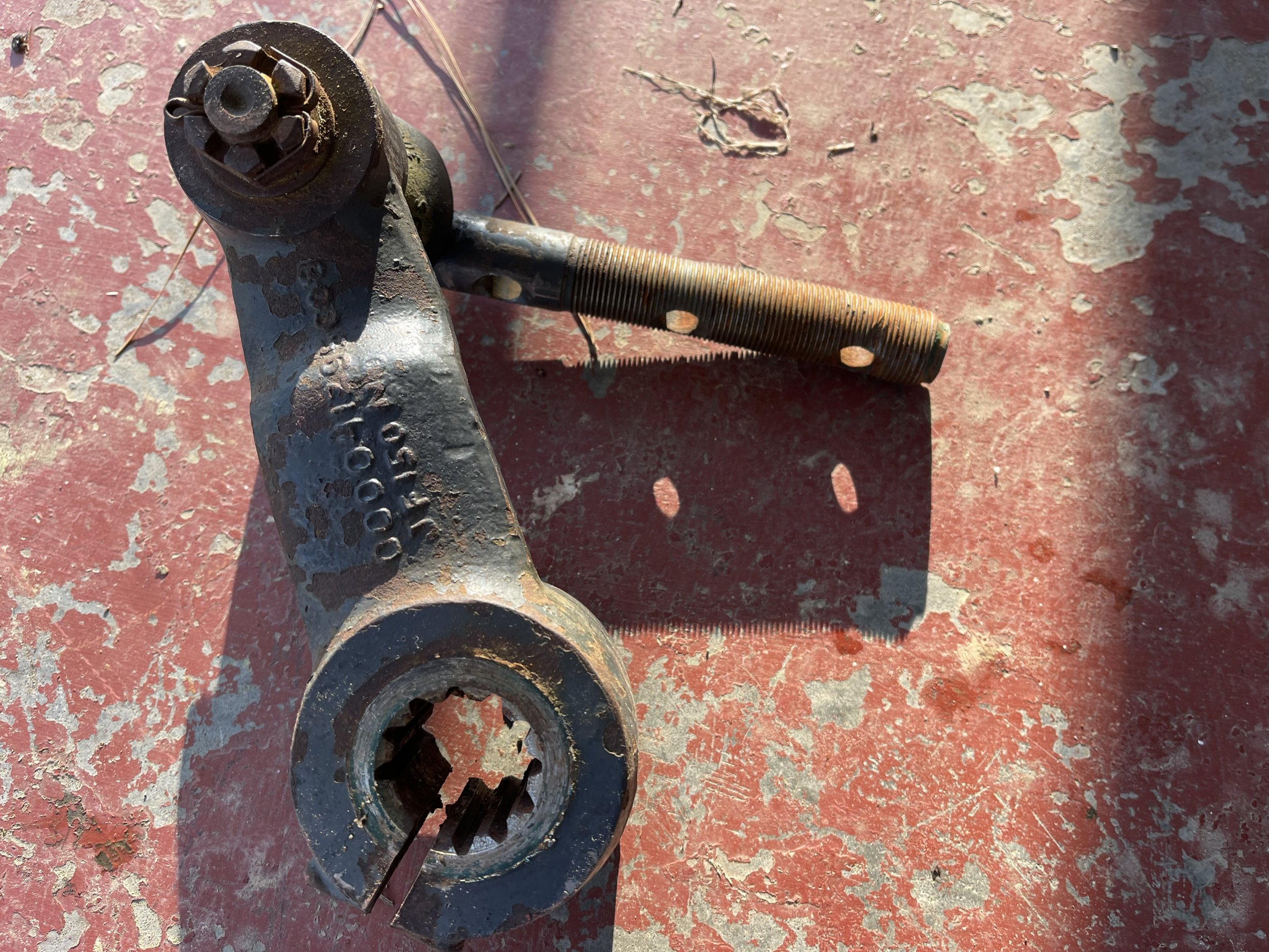

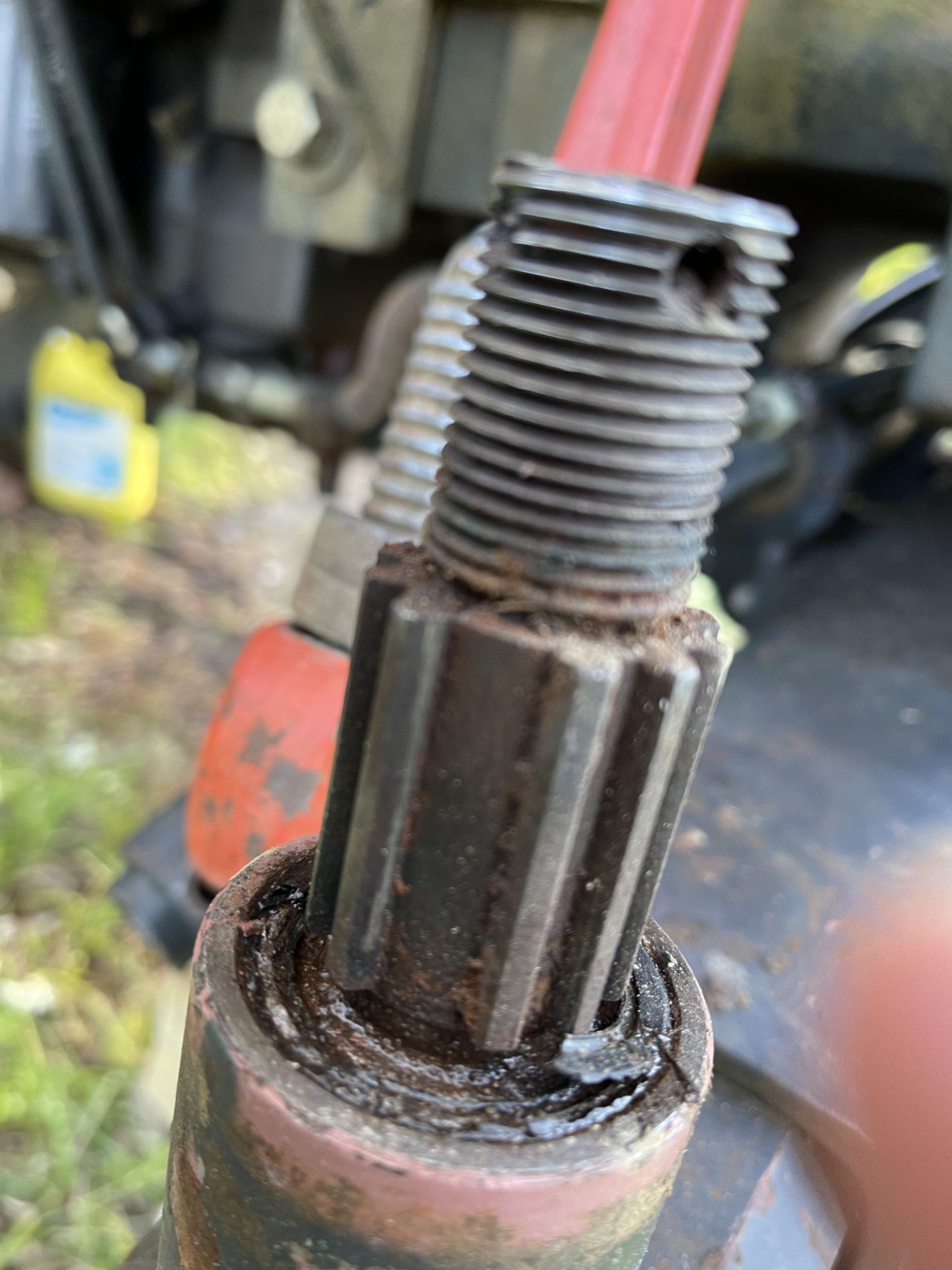

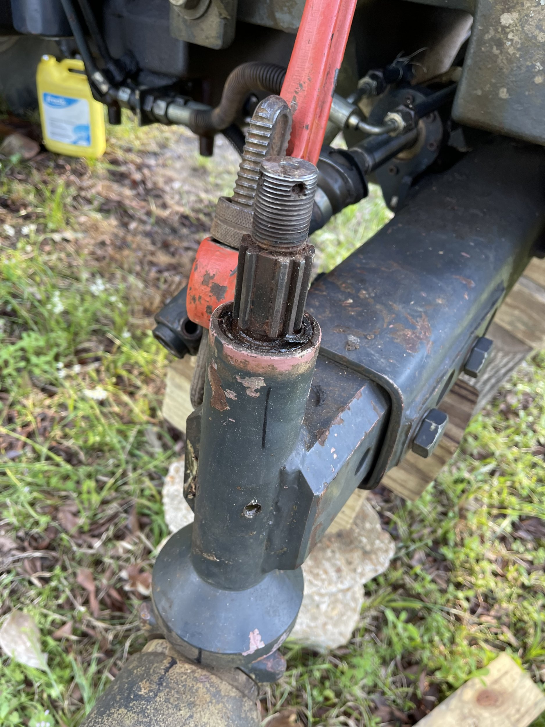

Thanks for the reply NPALEN. It sound like you hit the overall issue on the nail. Yes it clearly is the right steering wheel Pivot. Is the Pivot the same as what I been calling the steering spindle?? I have disconnected the top Large castle nut and pin. removed the lower bolt/nut below the large castle nut. removed the Ball joint assemble knuckle arm. OH yes: that steering pivot/steering spindle is dead froze. I have cleaned and sprayed some loose liquid over the Pivot. Hit it with a short and long sledge hammer, no budge. I assume you do knock it down to get out the steering pivot. I see a rubber seal at the top, is there maybe a medal washer behind that rubber seal that may need to be removed before you can bit out/down the steering pivot? What is call the wheel/hub whole extend arm, that you can unbolt and move out to extend the tires out further. I cannot find the steering spindle/pivot replacement. The spindle I have found over the internet do not look like the spindle/pivot that is mounted on this tractor. All the spindle/pivot i found on the internet show to be round, from top to bottom. The spindle\pivot on my tractor has riggets along with the ball joint assembly arm. Is there a web video site that show how to disassembly\remove the steering pivot. I am looking at taking it to the shop, and have it machine pressed out, the cost of that verses me finding the whole HUB/steering pivot, wheel extend arm, that has the large two big bolts.

HI NPALEN: The steering spindle is dead froze. I have already tried to knock it down with a hammer, no budge. Sprayed it with BP, still no budge. I have removed the ball joint assembly knuckle arm. This is a older ball joint assembly knuckle arm, and the steering spindle/pivot both are older models. The ball joint assembly knuckle arm has cut groves in it, and the steering spindle\steering pivot also has groves that fit into the assembly knuckle arm. The new models do not have those groves. I see a rubber seal on top, is there a washer or bearing that first has to be removed before you can knock down the steering spindle??? If the bearing in the housing around the spindle is what has the spindle froze/locked, I do not believe heating will make it any easer to knock down the spindle. The spindle at top has a indent hole, this hole must be designed to help knock down the spindle without damage to the threads on the spindle. Is there a tool to assist in knocking down the spindle???? What is the name of the steering spindle/steering pivot housing?(the tractor body part that can be extended to bring the whole front wheel out farther? I would like to look at replacing this whole spindle housing, compared to taking it to a Shop, and have machine press the spindle out. and purchasing a new steering knuckle spindle kit.
