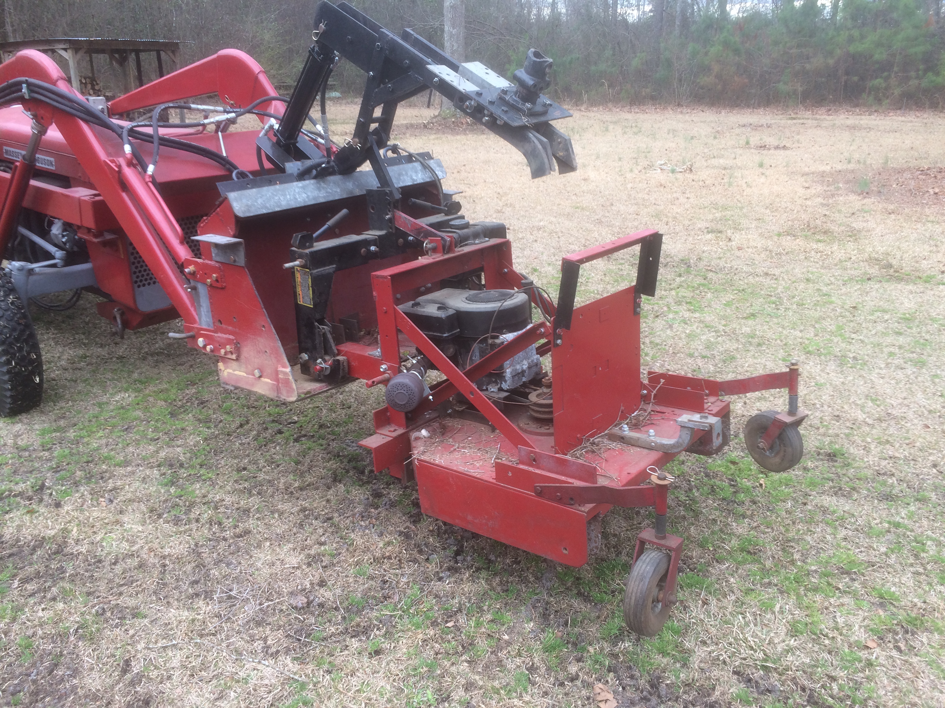

Here is my homemade deck to be used front or 3pt. 12hp engine from an old mower, $0 investment. Start and stop controlled from the tractor.

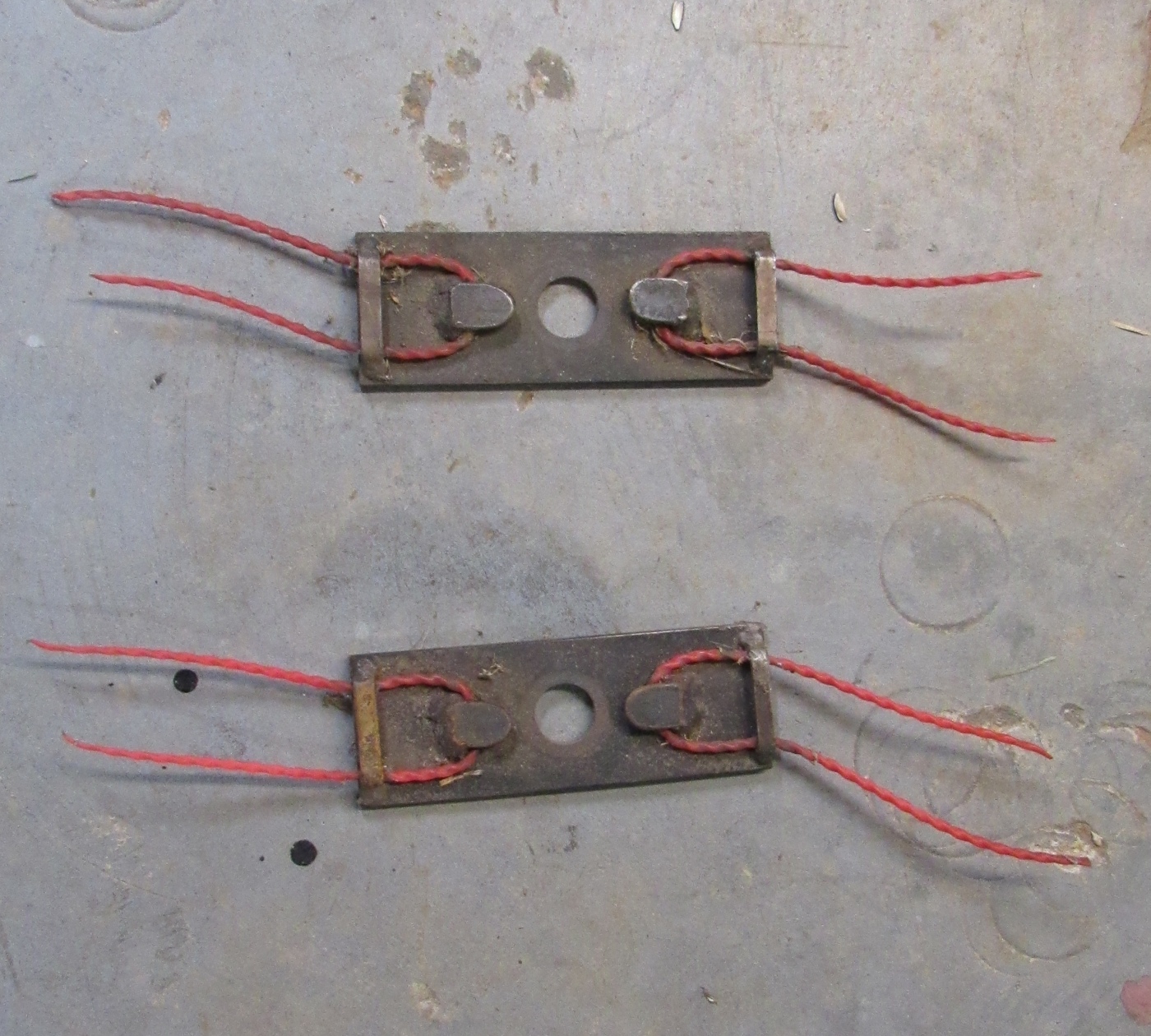

any pics of the adapters you made for the .155 line? Also, where did you get that heavy line at? Does the line hold up well? I feel the line may be a bit less dangerous than the steel mower blade, were things to go bad.
Here they are.
.155 line is used on most of the push trimmers so it's readily available. It's pretty durable but not indestructible. It's a good idea to design so it can be easily changed and carry some spare pieces with you.
I recently heard about this .170 line. Not sure how it compares but I might try it next time. A spool of .155 last me a very long time though.

Here they are.
Amazon.com : Oregon 22-47 Magnum Gatorline Square Trimmer Line Donut .17-Inch by 71-Foot : String Trimmer Accessories : Garden & Outdoor
Thanks for the pics and the link to that heavy line.

The heavy trimmer line WILL cut some heavy brush but it has limitations. Probably 1/4" green stuff is about as heavy as it will cut before it starts just stripping leaves and bending over the stalks. Get into 1/2" stuff and it will break the line.

Boy I would not be mowing anything that high, without some sort of protection between that blade and my face. Not that my face is special, it just doesn't need to be made any uglier than it is, by fast flying objects.
I like that idea though, swap out blade to line, and use the little engine that came on the push mower. I have a ditch this would work on, but I need some sort of heavy duty shield.
