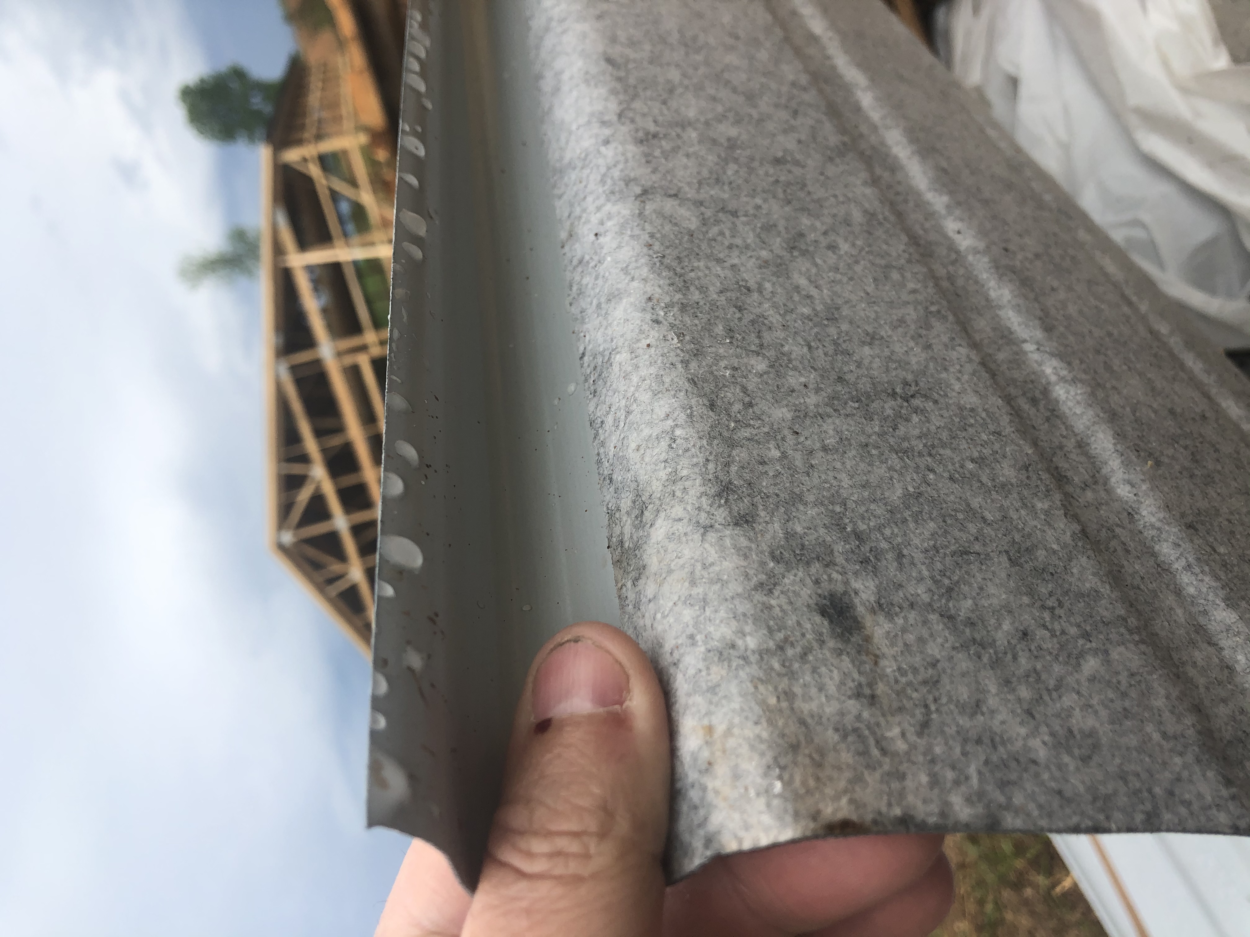

Point being, in an unheated dry storage situation I would not think twice about placing roofing steel directly on rigid insulation.

That bit of insulation will not materially change the temperature but will eliminate condensation due to ambient temperature fluctuations.

Steel sweats like crazy in springtime so make sure you are water tight beneath the deck. I'd recommend spray foaming under the metal if you can. I have an all steel barn and before I insulated it would literally rain inside on those nice humid days after cold nights.

When my shipping container was out in the open, it rained in there too. Actually, my steel wood shed does that. Most annoying.
I hate when evry single thing in the garage/shop is sweating from temperature/dewpoint changes. Happens two or three times a year. Hoping I can control the temeperaure better and easier with insulation.
