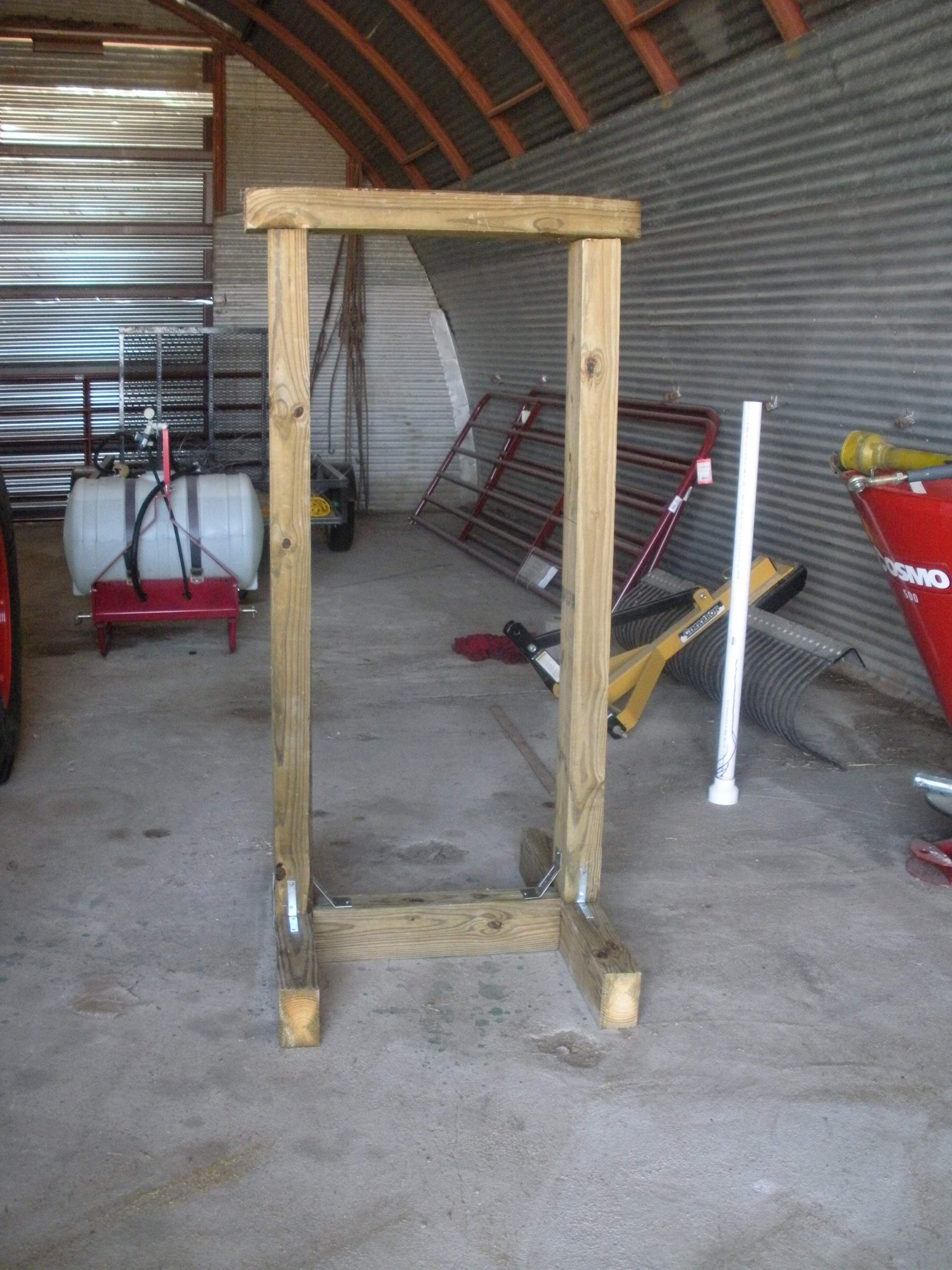

I made a stand for my PHD in a couple of hours. Its worked great for the last 6 months or so.

warhammer,
do you just chain phd to your stand? i'm chaining mine to one of the shed posts for now. would really like to move it. to the other end of equip shed. but i then need a stand.

/ rhino post hole digger stand #10
On the top there are U shaped brackets on each side that hold the cross beam in place when the PHD is on it but can quickly be removed for mounting the PHD on the tractor.
The PHD "balances" on the stand with the curved portion of the PHD arm resting on the stand cross beam and the auger touching the ground. No chain or ties. Mine sat like that in my barn for 3-4 months between PHD uses last year just fine.
The next farmer over has had his PHD sitting on a little smaller version of the same stand for the last couple of years at least.
If you want to move the PHD without being attached to the tractor one of those cheap Harbor Freight engine hoists and a nylon motorcycle type tie down do the job easily. They make mounting and dismounting the PHD an easy one person job and can be pretty useful for rotary mower moving and maintenance as well.
