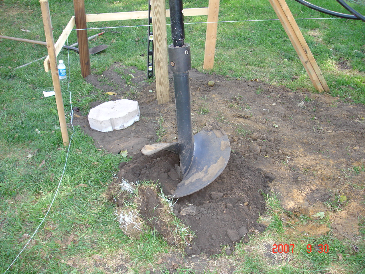

I got to use the post hole digger this weekend. We started a pole garage for my daughter and son-in-law. Worked great, hydraulic is the only way to go.

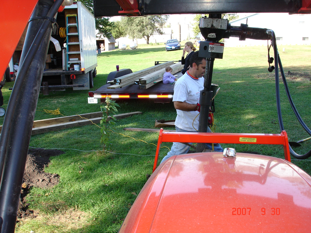

Did you run that off the remotes on your tractor or did it come with a hydraulic power-pack?
/ Rhino post hole digger; BIG PICS!
I run it off the remote. Also it's rated 10 to 15 GPM, but so far it works good on the L3130.

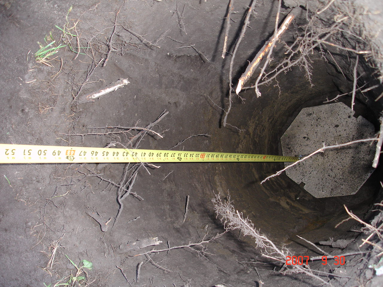

Your lucky to have that kind of soil. I don't see a rock in it. With a auger that size at my place, the tractor would be twisted into a pretzel in 15 seconds.
I've done one 18" x 4' in hard pan full of roots, did ok.

What Rhino digger is it ? model # etc.?
can you show pic of the tractor and digger together ?
Price range if you don't mind ?
