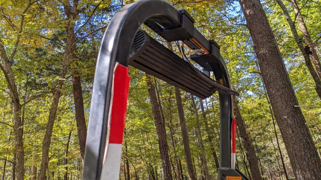

Printed a while back, but finally got it installed. A replacement mount the LED lightbar on our JD 1025R. The prior mount used U bolts & aluminum channel, and was pretty butt ugly. The lightbar is longer than the straight portion of the ROP top so extensions on the clamps were needed to extend over the curved portion.
Maybe not pretty, but an improvement. Printed in ASA with a high perimeter & top/bottom count.

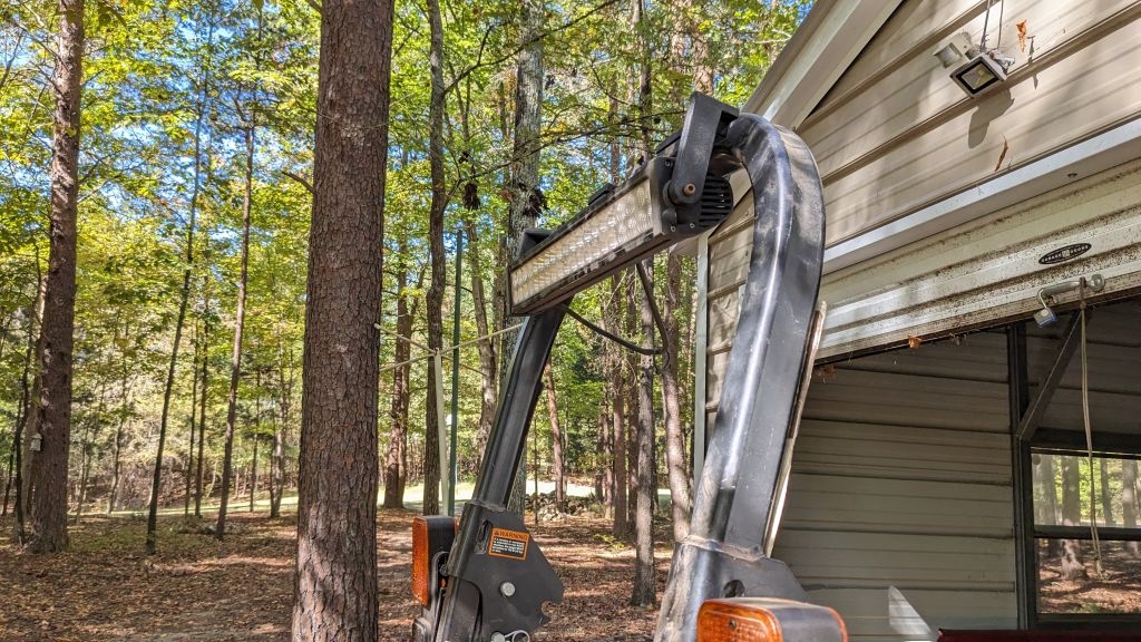

Looks GREAT! Nice work.
