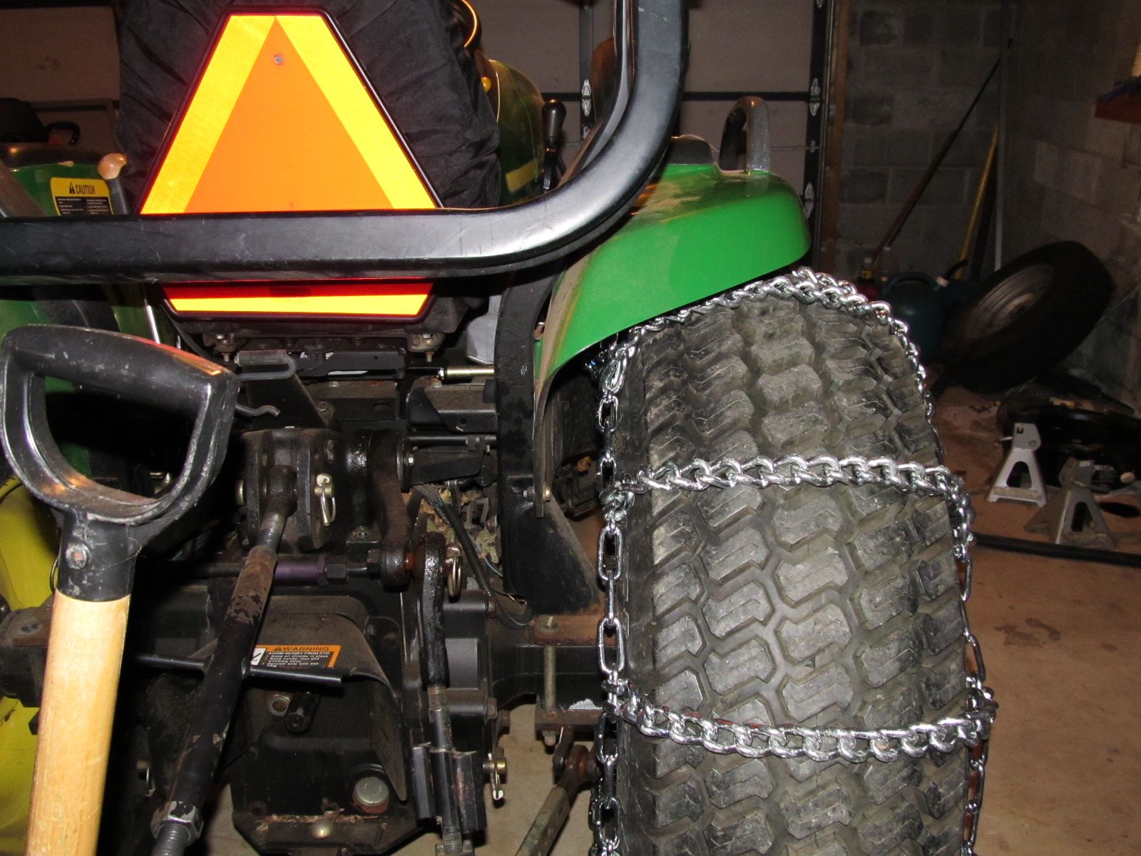

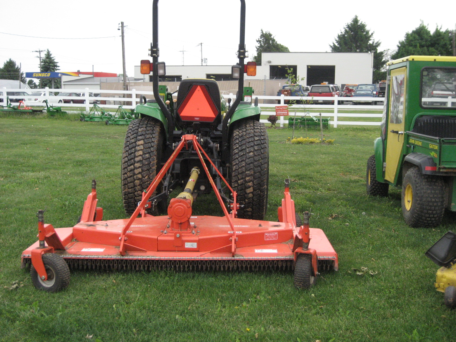

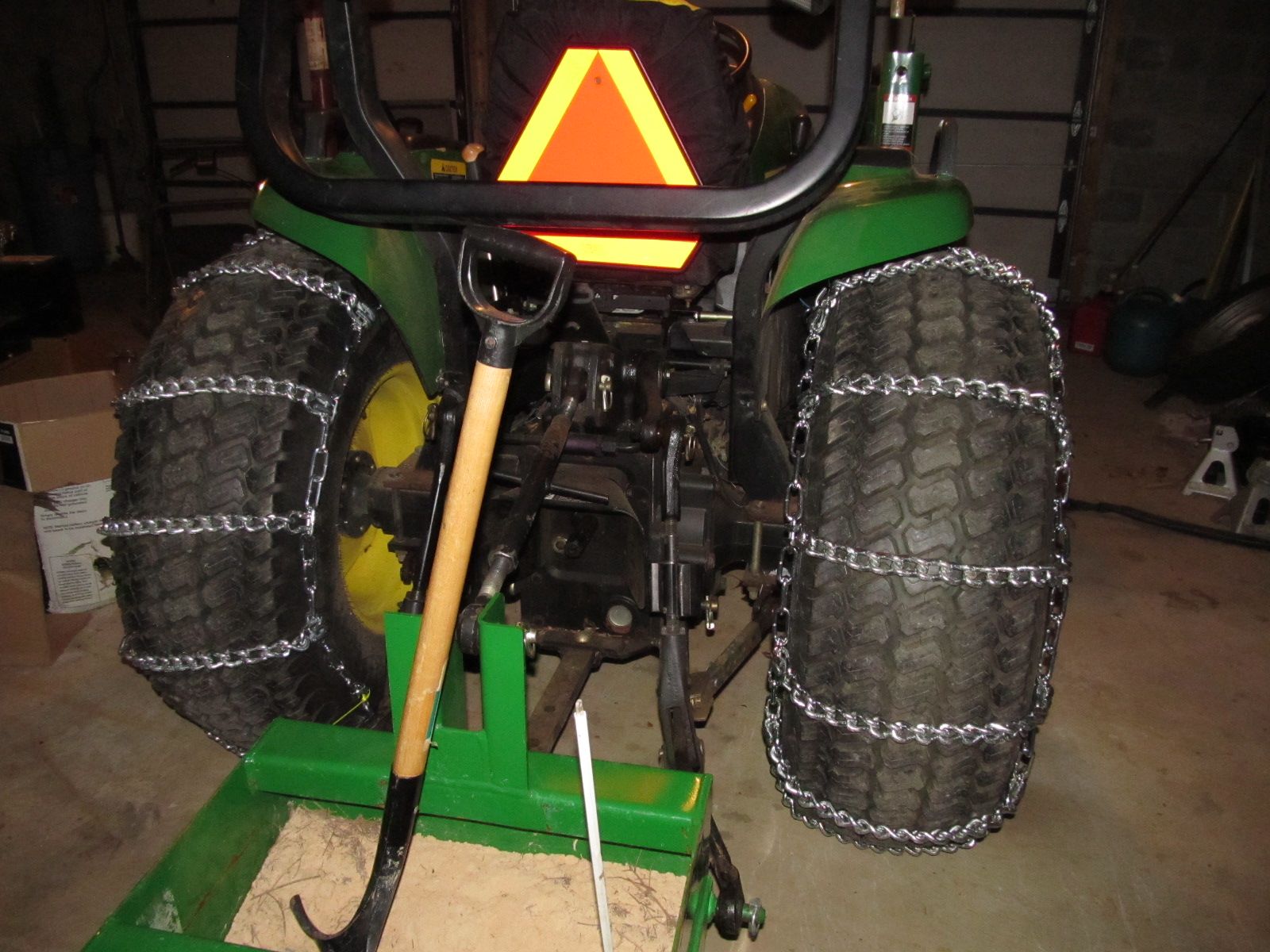

Here's an example of what you can expect before and after reversing (or swapping side to side) rear tires. This is mostly directed for folks who want to install tire chains, but also those who want a bit more spacing for stability. This is applicable to turfs, but you should see similar results with R-4 tires).
The first pic is of my 4400 (actually on the dealer's lot right after I bought it) with those rear turfs in factory stock. Not much clearance for chains, eh?
The second and third pictures are what you can expect after reversing those rear tires (this is, of course, on a Deere 4400. You'll get the same results on 4200, 4210, 4300, 4310 and 4410 tractors...other Deere models and other brands may have different results).
Well, now I'm ready for that snow storm...
