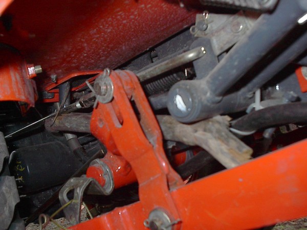

Could be my imagination, but after several hours destroying some of nature's uglier work, Sumac and wild grape vines, my B7510 feels like it's reverse gear moves slower than it has in the past.
Now, I've got her in 4WD, low gear AND the parking brake isn't set (I have done this, sad to say), but it just seems to be creeping. RPMs are around 2000 when I'm doing the deed for the most part.
Checked visually for leaks, didn't see any. Also checked the fluid levels, which are good.
Any thoughts or suggestions would be appreciated.

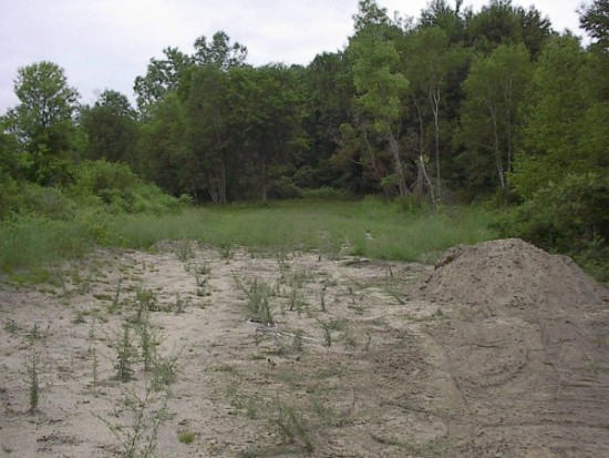

Now, just 'cuz I really am enjoying this, I'll post a couple of pictures. We've got some lake property in Central Michigan that we finished building on this year. I think maybe the fact that after the project was done I had consumed too many celebratory beers, and decided that we need to put in a small golf course, 3-5 short holes.
So, this is a before shot:

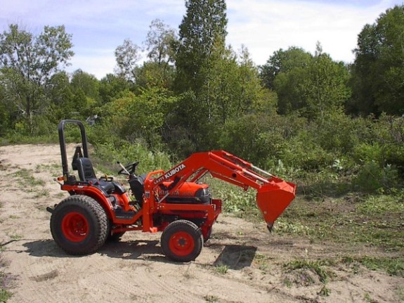

Here's a shot of my girl and the mess behind her that was about to die.
That new toothbar is amazing, worth every penny.

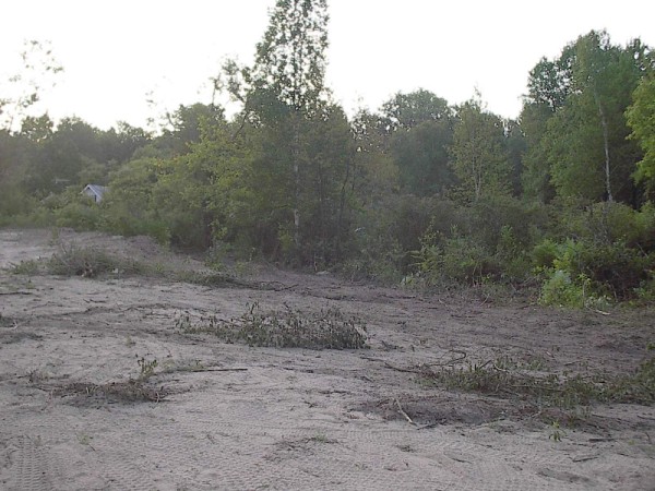

A picture of the same area that showed my purty tractor, but with some missing vegetation
Did I mention how great that toothbar works?

   / Reverse seems slower than usual #5
Look under the tractor, specifically under the HST pedal and look at the linkage. See if you have a stick wedged in the linkage that prevents the pedal from being fully depressed in reverse. Looking at the brush you have been removing, I would suspect this might be the cause.
I'll take a peek, that's a very obvious answer, now that you've given it to me. You are correct, there have been a large amount of sticks and branches that have fallen to the might of the tractor, and I have had to pull a few out of various spots.
Many thanks.
   / Reverse seems slower than usual #7
And if you don't have a stick or debris in there blocking the linkage, look for nuts that might be loose. If I'm not mistaken, that linkage is adjustable, and normally comes adjusted so the tractor will run half as fast in reverse as in forward.
Dozernut, you win a CIGAR!
I made the 100 mile trip to see my little buddy (and do some more work) today. Attached is the picture of the dirty little punk that was slowing down my tractor.
BAD STICK!!!
