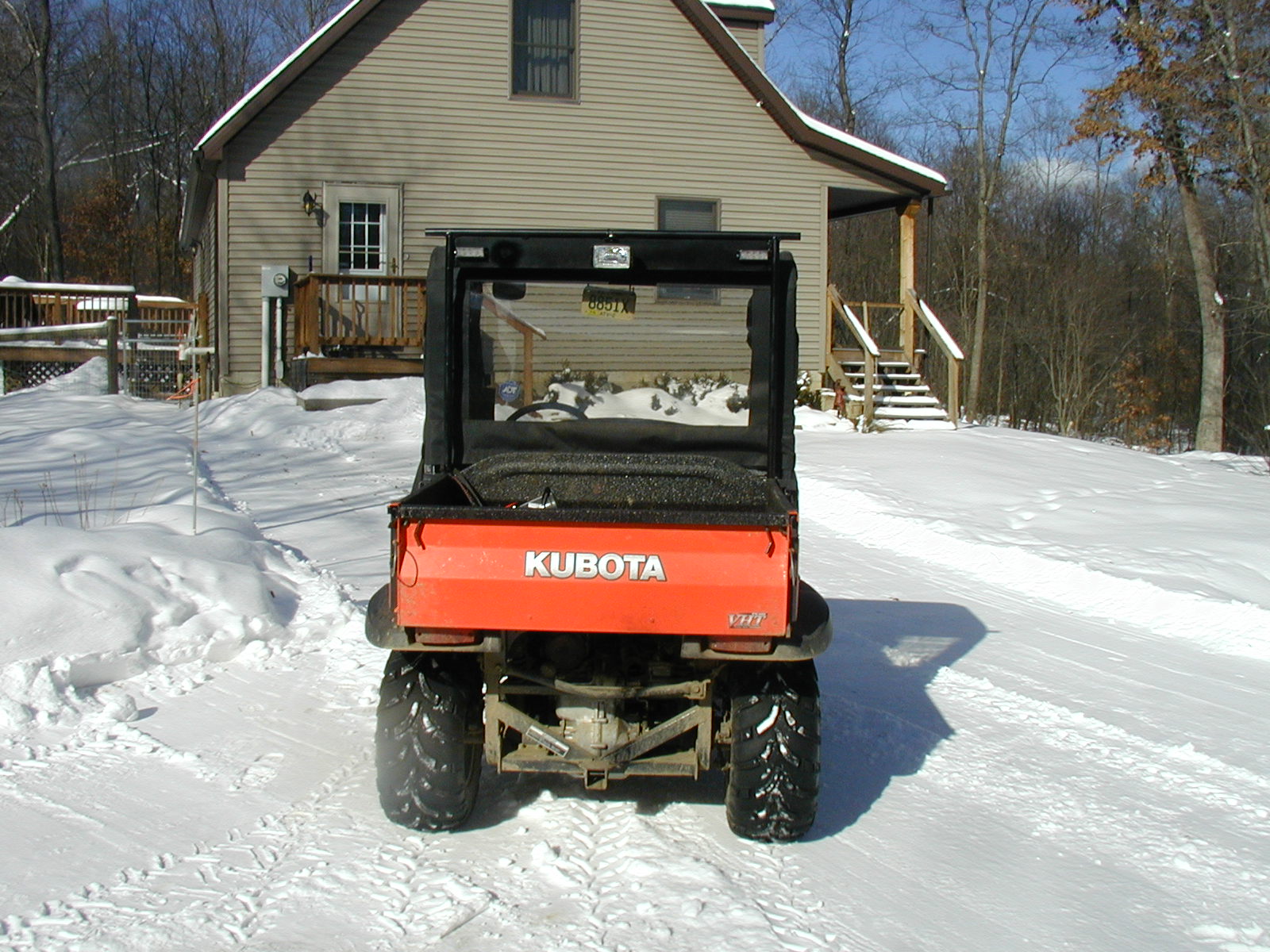

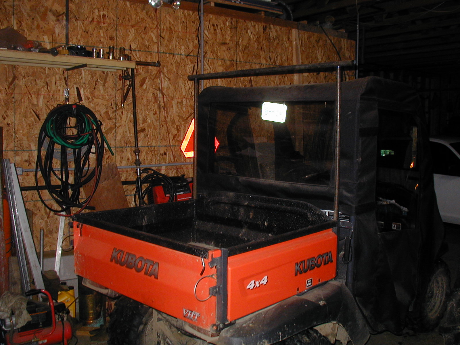

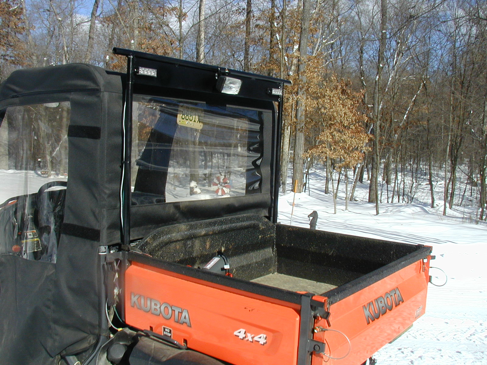

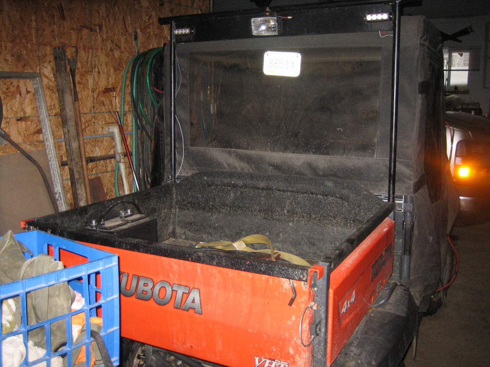

got a RTV 500 and was thinking about putting some type of reverse light on it. Was looking at some of those small light bars. is there any type of switch that can be installed so when i put it in reverse it can hit the switch and turn the light on?
/ Reverse light? #2
I used 3/4" pipe for my bracket, strobes and a Tractor Supply light with a separate switch.
