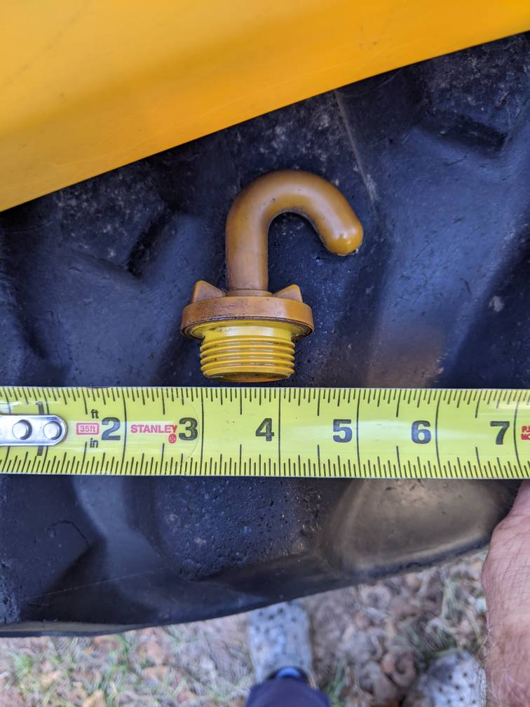

I have a Shaver post driver. The 3/4" hydraulic return hose is supposed to go into the filler neck due to the volume of fluid expelled on the down stroke rapidly. Does anyone know which adapter will work on a Kioti. The goal is to remove the screw-in filler plug with the goose neck breather while using the post driver. I will then connect my return line to the filler neck. Someone said you can just stick the hose down in the filler neck and secure it with zip ties, but I'd like to keep dirt from getting in there unnecessarily. Any thoughts? The tech at Shaver did not know if one is available.

Something around a 25 x ? thread to a 19mm barb fitting?
Take plug to a tractor/hydraulic parts house and size one up. Heck, go to your local hardware store and by a grey PVC 1"MNPT x 3/4" barb and gently force it into that hole. There's no high pressure, just volume.
My LK3054 has basically the same set up to dump fluid back into the rear housing. It had rear remotes and a back hoe connections.

Take you fill plug to a machine shop, have them determine the thread pitch and turn you an aluminum dummy plug internally threaded to accept a hose barb fitting and connect your return line to that. In my case with my Shaver, I used the return fitting on the pto rear case to return the fluid on my M9 Kubota.
I put on a Tee with a QD fitting and a QD fitting on the hose. If you go the fill plug route (like I suggest above), you'll need to keep the hose end in a plastic bag with a zip tie on it when not in use to keep the dirt off the fitting and the hose end.

Ask your dealer for the Return Line Kit that came with the older KB24XX Series Backhoes for your tractor model. It included the filler port adapter, and elbow, and a Female 1/2" Quick Coupler, and the breather tube. Exactly what you need to plug your return directly to tank.

Looks like NPT threads. Take to th hardware/farm store and see if you can match it up with a threaded hose barb.
/ Return hose adapter for post driver #18
Most of the KIOTI Tractors are Straight Thread O-Ring Boss on the fill tube.

Shaver called back and said I need a sm-67-r adapter for my tractor. I can't find a picture online but they are $55 at a distributor online.
Then my awesome Kioti dealer hooked me up by fabricating an adapter with a quick connect and moving my vent to an existing unused tap, making connecting a breeze and keeping dirt out of the system. Jordan at Paige Tractors has been a pleasure to deal with on the purchase of a new tractor and getting it set up for what I plan to do with it.
