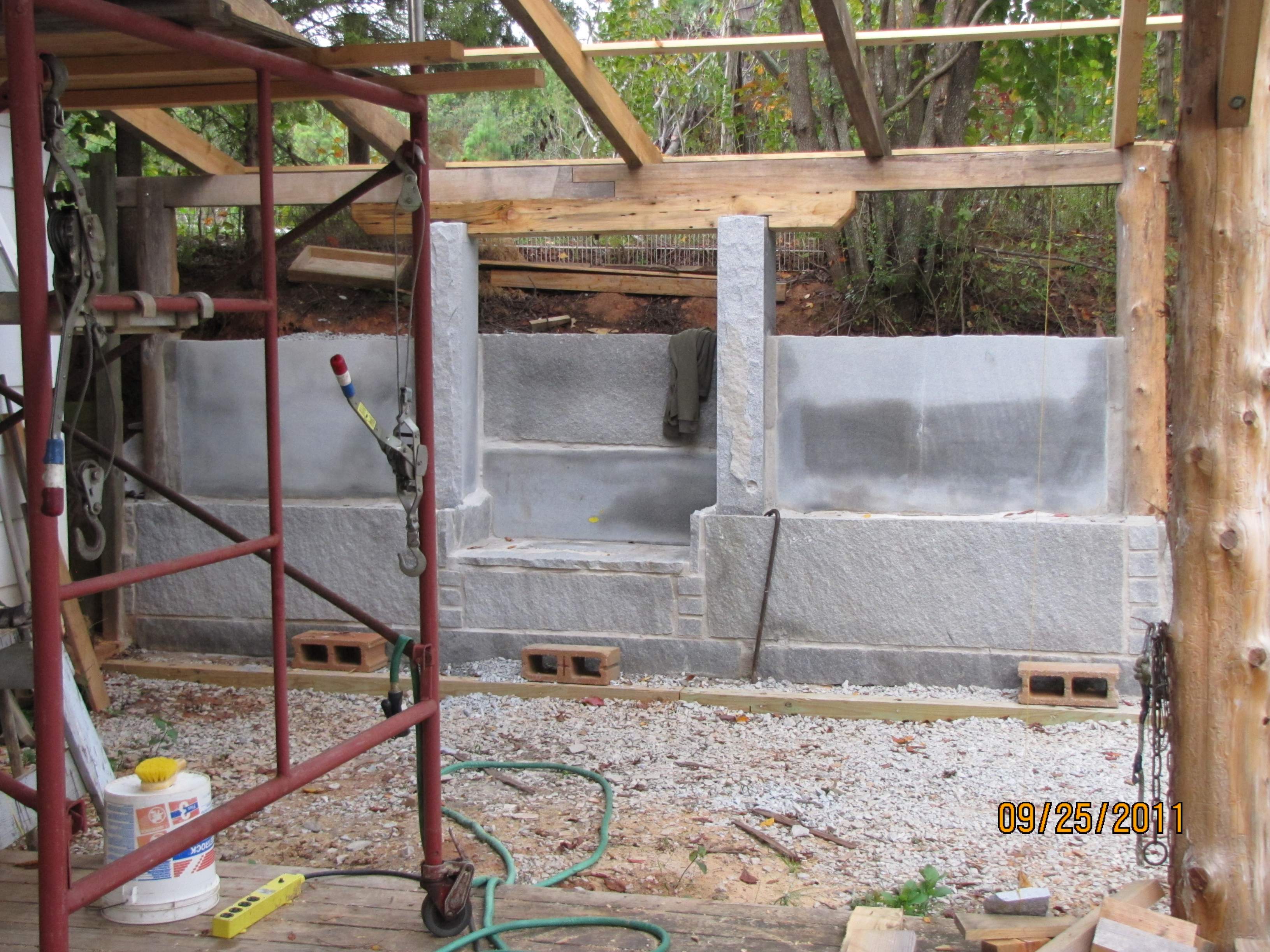

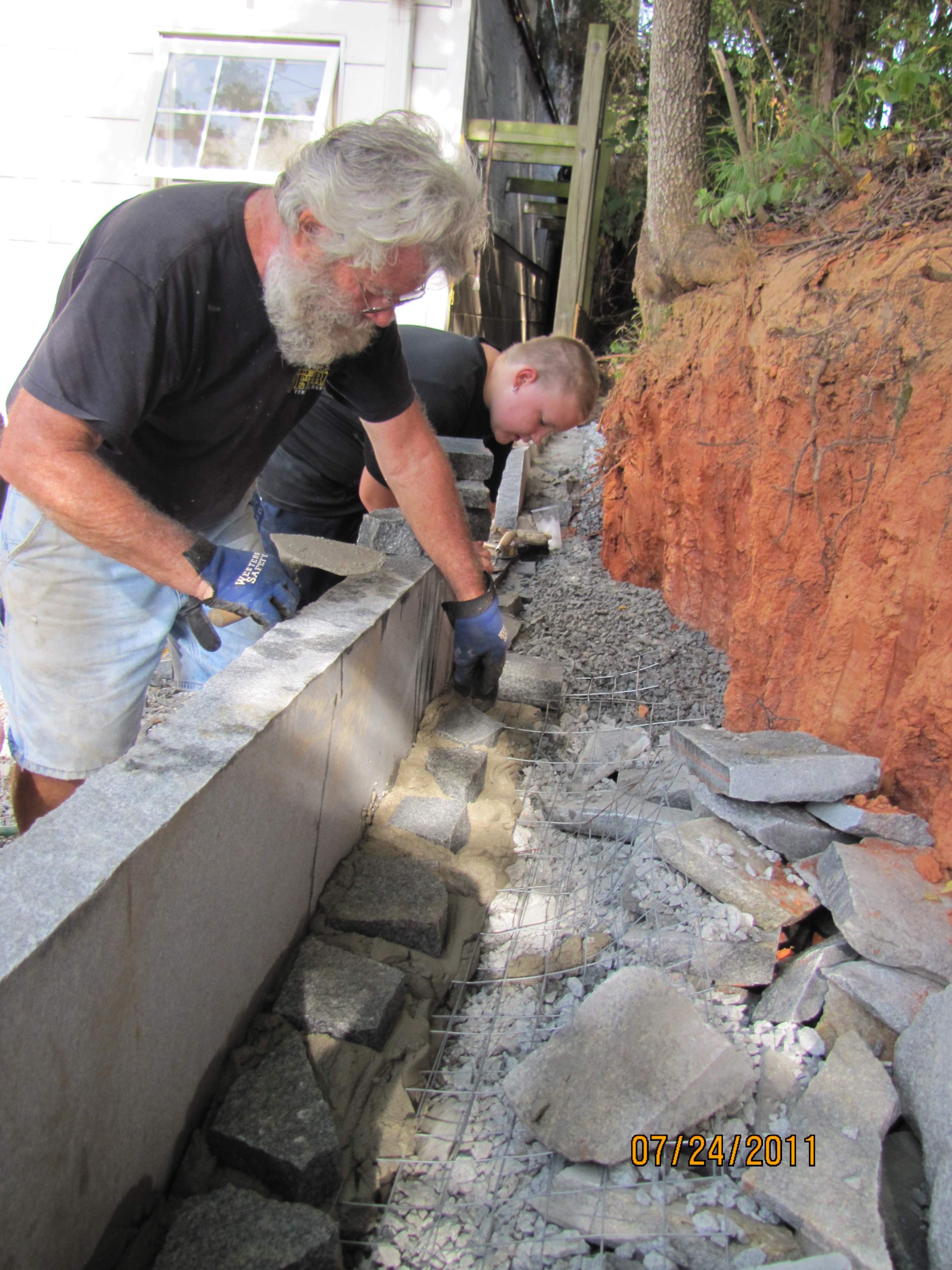

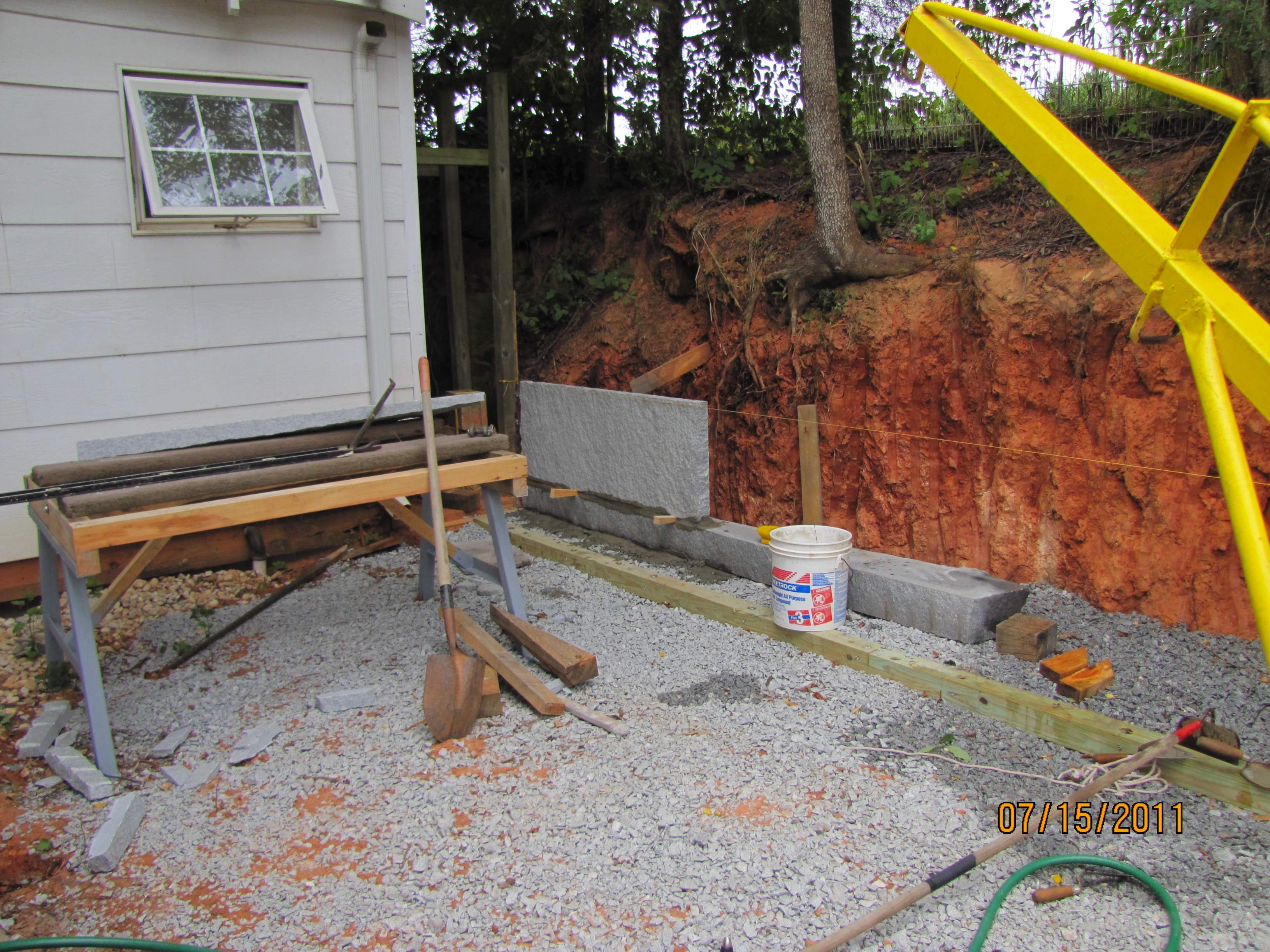

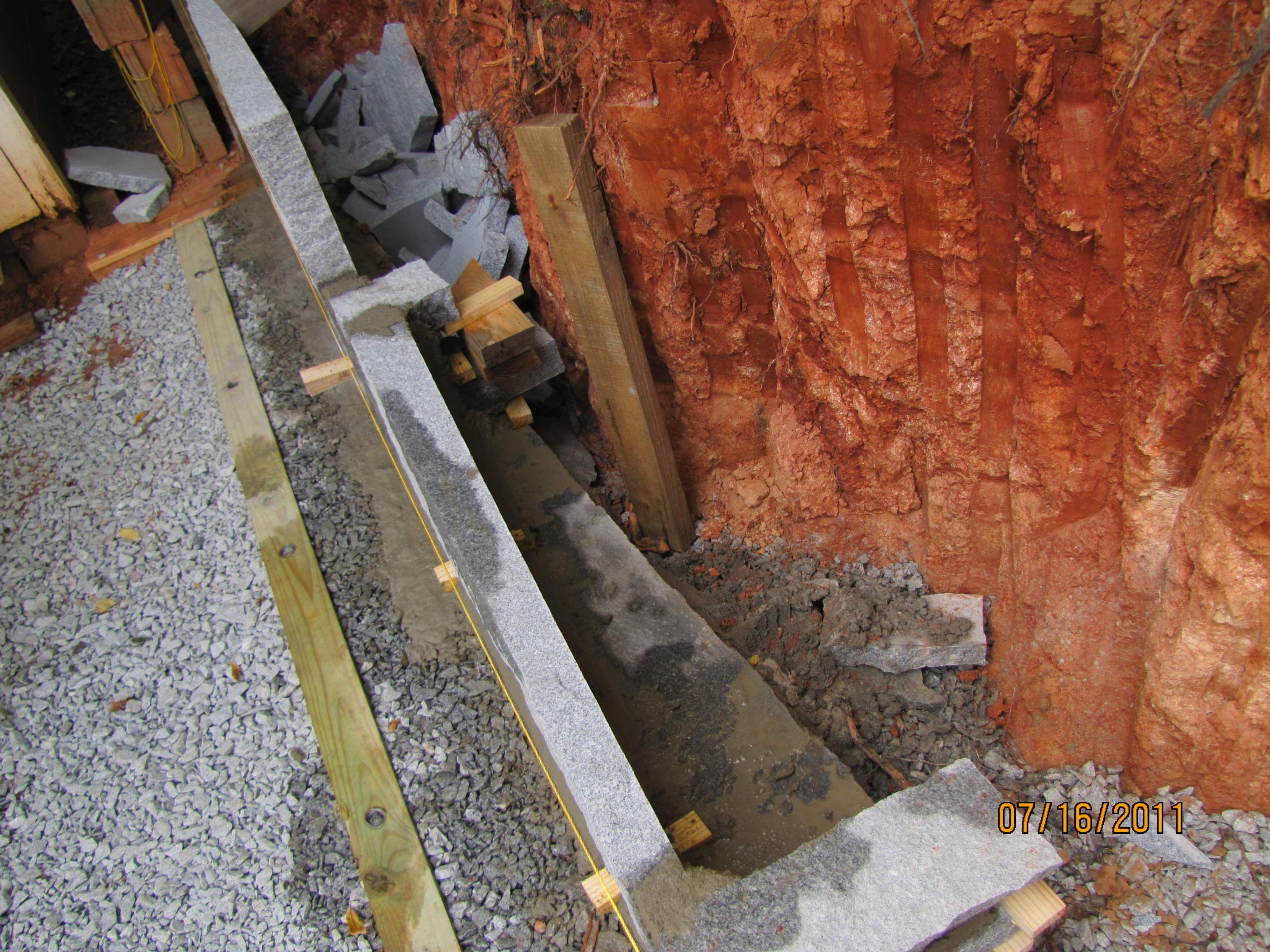

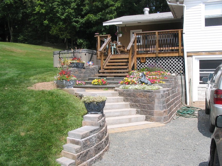

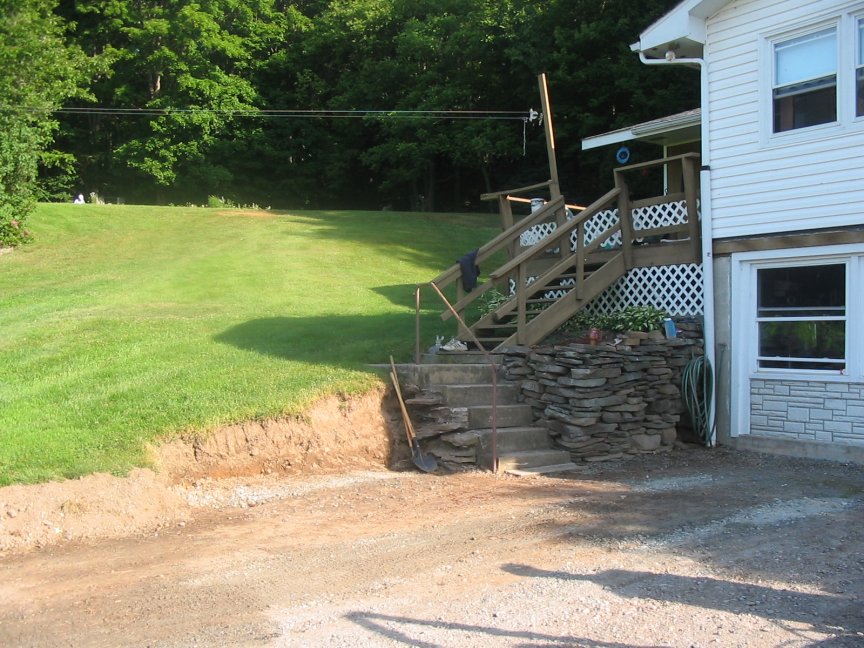

The following is a link to my post on an earlier thread. It shows a "gravity wall" built in front of a failing landscape tie wall.
http://www.tractorbynet.com/forums/2471583-post16.html
I built this because I had room and the rocks were available from my property. The person who constructed it owns a company with over thirty years experience building bridges, roads, etc. for logging companies in this area. So I know it is a well built structure.

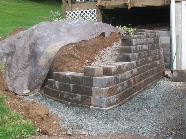

About 2005 I had to use retaining wall block to level out an area for our barn. We had a deal with HD at the time where they gave us 10% off whatever we bought for the house so that is where we bought the block. I forget the name of the block but it came from a large company based in NC.
We looked at the HD block and products from other sources. I read their installation instructions which were very helpful. As has been said, I was limited to a wall 3-4 feet tall unless an engineer got involved. The instructions covered drainage, height, slope, fabric use if needed, etc.
The installation is pretty easy. The hardest and most time consuming part is the first layers of blocks. Getting the first layer level is hard. But once the first layer is finished the rest go in as quick has you can move the heavy blocks.
Per the instructions, I used the backhoe and made a trench which I filled with ABC gravel. ABC is road base in NC. It compacts well but I would have been better off using a more uniform gravel to help level the first row of blocks. I have at least one or two rows of blocks below grade. The wall might be close to 2-3 feet tall on the highest side including the buried block. The wall has not move in six years.
I used ABC to back fill and level out the ground behind the retaining wall. I pre dug post footers along the center line of the space in case we ever build a proper barn and nee posts. When I did this I hit some water. :eek:
The wall has not moved even with freezing temperatures.
