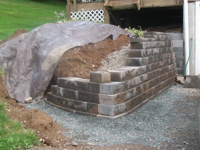

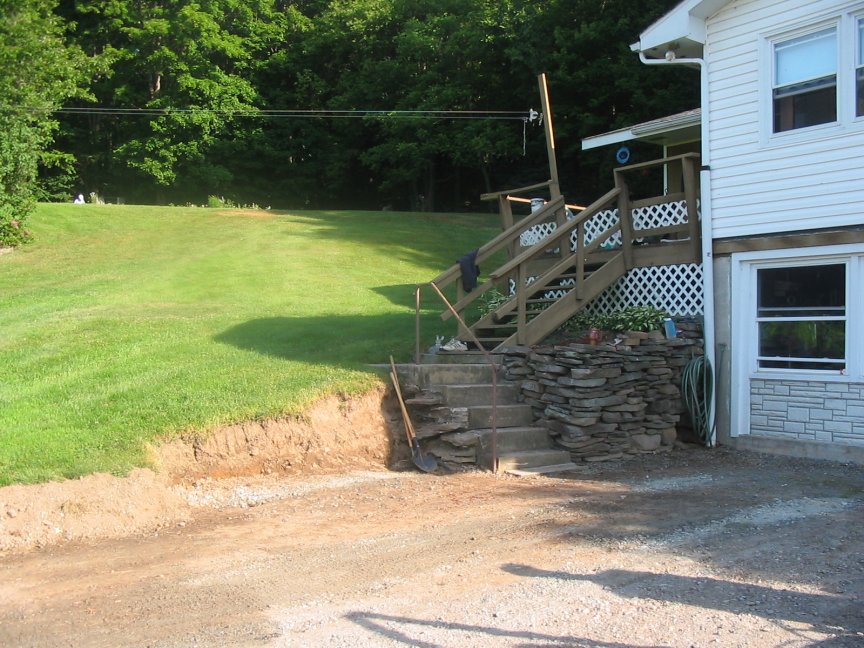

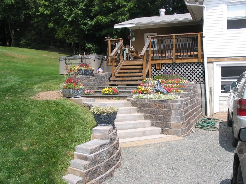

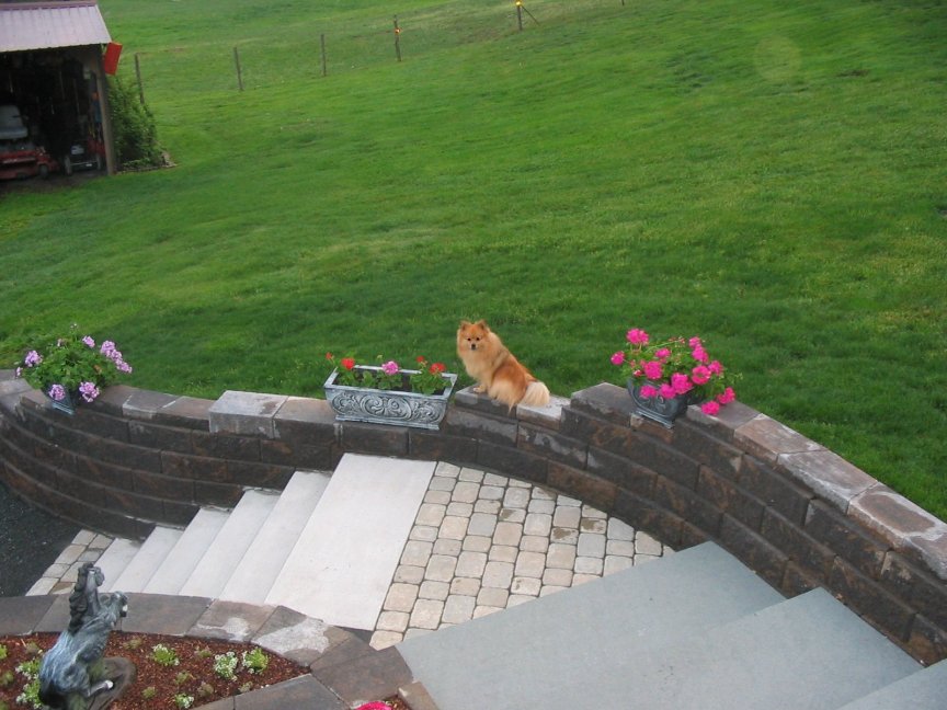

Wall has not moved since my wife and I put it up in 2005.
We used Geogrid How to Build a Reinforced Retaining Wall Using Geogrid - YouTube on the higher end. The other side of the driveway has the same type block wall with the higher end about 6ft and we used the Geogrid at two different levels on that wall, hasn't moved either, (Upstate NY).
